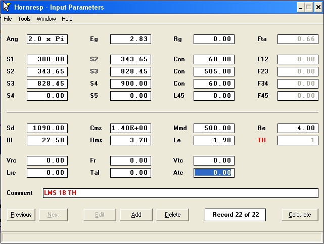

LMS 18 TH
How do these look? One is 600L and the other is 900L. I think the 600L looks decent if it's do able, but I'm a bit concerned with the first major spike that always seems to be present in the pass band. How bad is that in actuality? I can go to a 60-80hz steep xover but I don't think that will be enough. I guess I could notch filter it out.

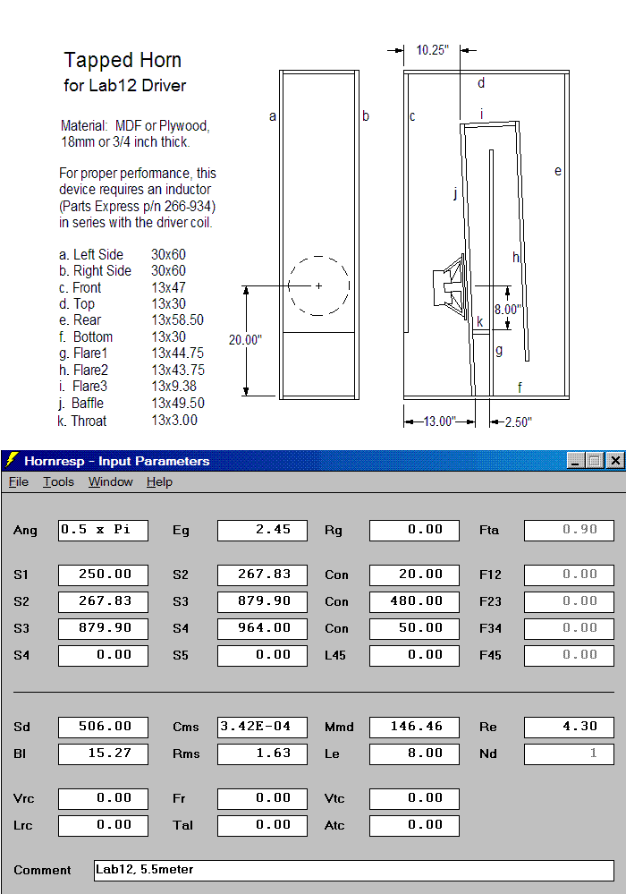

As far as I know, the longest tapped horn built to date is Chris's Lab12.
Chris built 2, I built 1, and Tone P just needs to put on
the last panel to complete his. The acoustic length is just short of 19 feet.
Josh: are you seriously thinking about building this 24 foot
monster? If driven hard, it could cause structural failure of your house.
If you take your horn outside to test (2Pi), that peak at 68 Hz will not exist.
Put a little polyester in the throat, and peaks will not be a problem.
OTOH, room effects are going to cause major problems

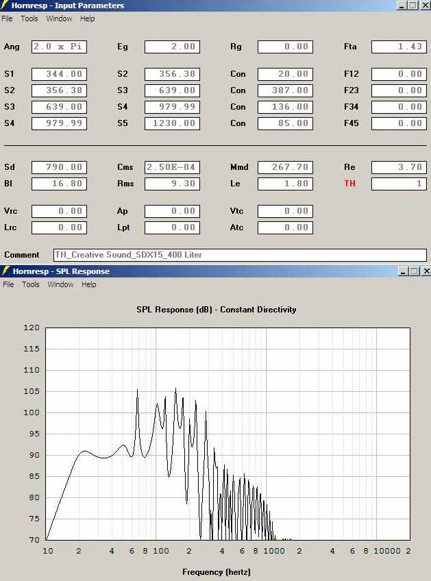

Hi There: Only one way to find out if the simulation matches the reallity of a large, one octave, 45 hz crossover TH which reproduces sound really low... build it/measure it/ listen to it and hopefully report the results to the DIY community. ...regards Michael

I will certainly chime in with some photos soon with my Lab12. I'm using 3/4" apple ply. Decided to use a 12x14x1/2" Green edge clear acrylic for a driver access panel (also able to see the lab12)

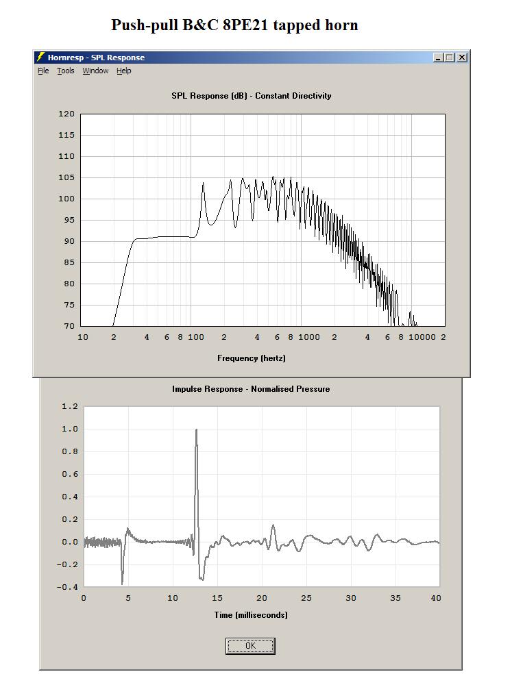

Impulse response comparison
Hi JLH,
I have always liked the design you shared in Post #2362, it gives such great control over the size of the compression chamber and the horn throat. As David McBean added an impulse response plot to Hornresp, here is yours and the SPUD:

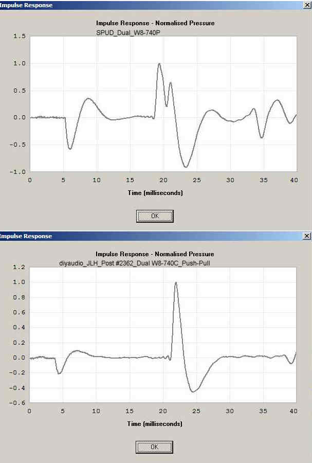

Thanks for the kind words. I'm more used to being yelled at for that tapped horn. The wife still hates it.
I can't tell, but is that a good impulse response? What does one look for in a "good" impulse response?

Hi JLH,
quote: "... but is that a good impulse response? What does one look for in a "good" impulse response?"
For a tapped horn it looks quite good to me, actually looks better than the simulated response for the SPUD, but then there is the question, how do they compare in a measurement, and more importantly what do they sound like?

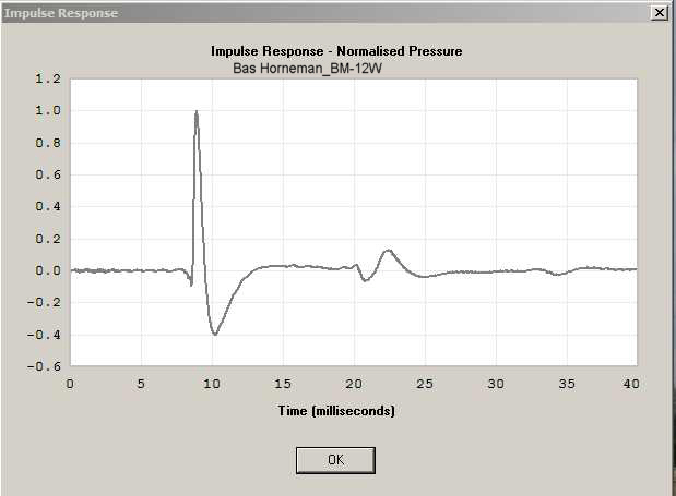

Hi JLH,
Just as a comparison: Bas Horneman has a very nice thread on a horn project, and I tried to model his bass module in Hornresp, anyhow, here is the impulse response:
