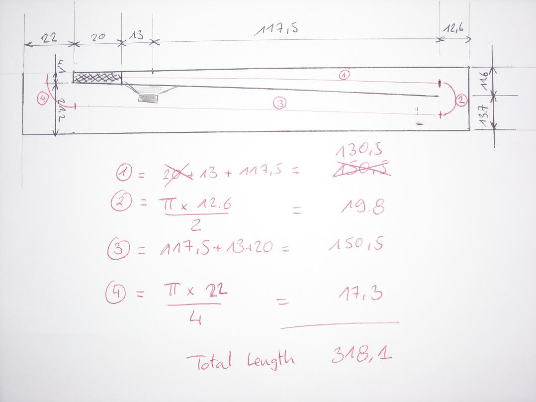

JLH said:I think I know what is going on here now. I ended up splitting up the 259cm length and making this a 4 segment tapped horn. I was then able to use the tapped horn wizard and duplicate the measured response. The problem appears to be the flare rate in the throat is slower than what is in the model. This is the green area in the attached picture below. Also, the purple area has too fast of a flare rate, (i.e. it expands too fast). Lastly, it appears that the L34 segment is not 48cm long, but a bit too short. This could just be a case of not building something close enough to what was simulated.
JLH et all,
first, the picture perspective is misleading (I hope ), I will try to scan my pre-build drawings tomorrow.
Second, I counted the end part and my full length includes the 90° arc to the exit... Is it wrong ?
Third, I have enlarged the driver hole today... No change in measurements...
I have glued and silliconed all joints that were not air tight...
No change in measurements either...
Fourth I have tested the sub "in-situ" quickly... It goes deeper indeep than my current floorstanding mains, but nothing breathtaking. At the same time, I have no other experience with any woofer and the test was quick.
What should I look for in my tests ?
Fith, I have not been able (whatever the settings) to feed the sub from the LFE output of my HT amp when listening to music. Reading the documentation, my impression was that some signal processing was happening for 2.0 signal as well, but it does not seem to be the case.
I must say that I am a bit depressed...
No, not that much actually, just kidding, I know that "with a little help from my friends" I will get there in the end.

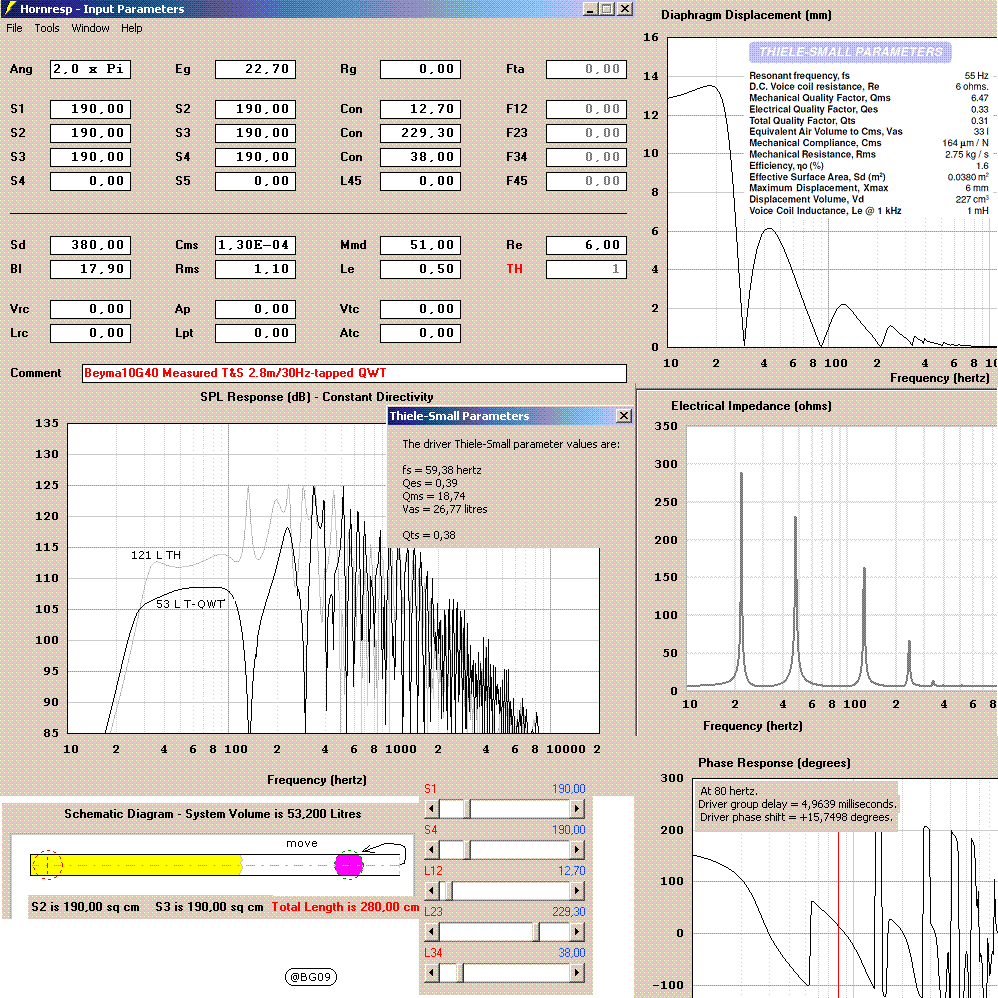

Hi jm_kzo,
I noticed you're using your speaker setup in a smaller room?
Looks you've got a driver with a stiff suspension, (dried up?) rim?, causing Qm to peak and the Qts value to increase too, or is it a driver that missed the manufacture QC(quality control) a preliminary batch driver?.
If your T/S is reliable and if you can spend 10€ more on wood I suggest you to try an another approach that doesn't rely on sensitive expansion rates and behaves quite differently compared to a TH does but is much more forgiving if the implemented dimensions is a bit off.
You will lose some SPL sensitivity but I think still would provide quite adequate SPL:s considering your apparent room size.
If you place the port/termination in line, exactly in front of the driver instead of what HR shows the SQ IME improves too.
Look at the submitted picture 1(1) where you can find what you are trading for when building a TH in terms of speaker size / SPL and BW for the Beyma10G40.
Your T/S parameters resulted in a 121 L box in comparison to a corresponding smaller (53 L box) simple Tapped (stuffed) (straight) QWT (or TH) that would IMO perform well , with superior SQ and IME without the need for any series inductor.
b
1(1)

bjorno said:Hi jm_kzo,
Hi bjorno,
It is a PA driver, not much experience in this space, but I assumed they are all stiff. The driver is brand new.
I would not think it missed quality control (I hope it did not), I have 3 of them.
I have been told that breaking in those PA drivers takes time.
bjorno said:If your T/S is reliable and if you can spend 10€ more on wood I suggest you to try an another approach that doesn't rely on sensitive expansion rates and behaves quite differently compared to a TH does but is much more forgiving if the implemented dimensions is a bit off.
b
I would not trust my T&S parameters too much... I tend to doubt my measures at first . The Claudio Negro site says that the driver should be really solidly attached. It was not really the case for me (not rigid enough mounting pod).
I have a spare Beyma 10G40 to try for as long as I want (it is the one for my center speaker), I have not finished the mains yet fully, so the idea is to experiment, and I might well experiment your suggested QWT.
If I may ask, I assumed in the above that SQ stands for Sound Quality, IME for In My Experience, but what means QWT ?

Re: JM's Beyma 10G40 TH
There's only so many things that can cause this.
1. Air leak - are you really sure it's sealed? Every single millimeter of it? Even around the driver?
2. Driver parameters - at some point you might want to confirm the value of vas, since it's pretty important. What is the reason you didn't finish the measurements and get vas? You did half the work, it's kind of like putting on only one shoe and going to work. Unfortunately, as I mentioned, if the driver specs you are using are wrong the only thing you can do is make a bigger box.
3. Hornresp design not properly translated to the physical box. In that case there's not much you can do either.
So you can see, if it's an air leak you can fix it. If it's not an air leak, IMO there's nothing you can do except find out the reason and avoid it next time. You could try a different driver but good luck with that, you'll need it if you try.
jm_kzo said:Guys, I have swapped the friver for one that is (more) broken in and had a few hours of 50/100/200Hz, but still the same... the 30-60Hz part is missing from the bandwidth.
JM's Beyma 140G40 TH
Guys,
as promised (and possibly to help you help me ) here is a sketch of my build.
I did that quickly as the one I really used is not readable by anyone else than me...
The measurements here assume a 0mm thick material, the real thing accounts for thickness of walls and internal partition.
The actual thing is 188 x 31 x 33.6 (the internal height is 30cm).
It should have been 188.7 tall, but the guy at Home Depot messed that one.
In red is the length calculation.
There is a wee bit of aproximation for the lengths 1 and 4 (the line is "angled", not parallel to walls and the diameter of arcs, but it should be pretty close.
I hope you can find to flawes here (at least I will know).
Many thanks.
Guys,
Many thanks.
Hi just_a_guy,
I am fairly sure abour air leaks... I do not feel any air around joints now.
Re measuring Vas, it is really the idea of glueing something to the cone that did put me off... and I did not have enough blue tack either (by a country mile)...
There is still a possibility that my hornresp calculation is not translated properly (to be honest, I hope it is the problem).
If this one does not work, I think I will default back to a proven design, TH or something else.
My mains have exhausted my taste for wild experiment and unexplored teritories .
Thanks anyway for your help and comments.
Hi just_a_guy,
