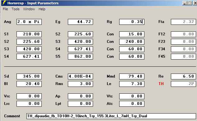

GM said:You may need one or more resonators to damp the peaks depending on the amount of stuffing used.
GM
Is that the peaks in the passband or above? I'll be using computer eq anyway, not sure if there'll be problems or not.
tb46 said:Hi,
The experts advise a compression ration below 3:1. In other words S2 should not be smaller than 115cm^2 for this driver. If you watch the comments bar at the bottom of the Hornresp input screen, it will tell you the compression ratio you are using.
Doom doom doom..... Hehe. What effect will a ratio of 4.35:1 have? S2 of 115 makes freq response not happy again.
In a related note, designing tapped horns does my head in - can anyone share (or make for me ) a TH with 10" driver that does 120db 35-90hz? All designs I've seen with 12" or less exceed xmax in this range.
Thanks all for your help

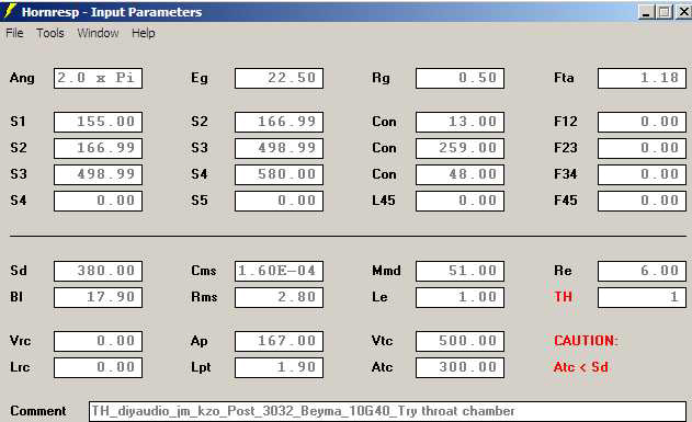

Re: My tapped horn experiment with a Beyma 10G40
You need to make the hole opening into the throat the full size of the cone. The S2 area only concerns the horn, make the woofer hole as big as the cone. Your picture labeled "Where the driver will go..." shows me yor problem. I made the same mistake on my very first tapped horn. Do not feel bad, it looks like you have a big enough access panel to cut the woofer opening larger.
Rgs, JLH
jm_kzo said:Hi tapped horn gurus,
I have been lurking at this thread for while and posted a few times, but last week-end, the time did come to make some saw dust and play some sine sweep...
Just to put things into context, I am looking for a clean sub to cover from 80/100Hz down to as low as possible but realistically lets say 30Hz to go with this project that I have described here.
The only speaker that I have lying around is a Beyma 10G40 that will go later in my center front speaker and I decided to give it a go as it was simulating quite well.
The simulation with the T&S parameters from the specs are as follows.
It is even flatter with an added 2.2mH inductor.
Following advise here, I "measured" the T&S parameters of one of my 10G40 and it models as follows in the same tapped horn (quite similar).
I am putting measured in quotes because:
- I used SpeakerWorkshop measure in free air method
- I did not do the added mass or closed box bit, so do not have Vas
- my speaker stand was not necessarily as rigid as it should be.
Again, it is a bit better with an added inductor.
I then started the build...
Here is how it looks before closing the box.
The driver in place ready to be sealed...
The thing in place for measurement (mic in the mouth)...
Up to this point, I was a happy man...
With the pieces cut to dimension (as we can get from our Home Depot equivalents here in France) it took me 4 hours prompt to fully assemble the thing.
[tbc]
Rgs, JLH

JLH and jm_kzo:
I too noticed the throat chamber with the reduced opening into the horn proper, but when I modelled it in Hornresp it didn't seem to make a difference. It would be helpful if JLH could expand a little on his practical experience with this area. Usually these tapped horn models seem to be quite touchy in the throat area. As to the difference between jm_kzo's model and measurement: 1. check all dimensions, 2. I would guess that air leaks, especially around the driver area will do a tapped horn in, 3. Go with Sabbelbacke's advice and get "Testing Loudspeakers_Joseph-D'Appolito".
carpenter:
Thanks for the picture, looks interesting. Where do you find the time?
fb:
Just playing with the TD10H in Hornresp it looks like any number of reasonable alignments can be found with an acceptable (to me about +- 3dB) amount of ripple. This particular driver seems to respond well to a series inductor (Le add 7mH, Re add 0.35Ohm). And, if the enclosure width is a problem, the use of multiple drivers seems to be the way to go. I'll attach the Hornresp input screen for a dual with a similar volume to your design, just something to get you started.
High compression ratios are reported to destroy woofers, particularly if they are used for high-level output over longer periods of time, e.g.: PA, instrument use. If you are looking for output in excess of 120dB from 35Hz to 90Hz that may qualify.
Regards

Re: jm_kzo's Beyma 10G40 TH
Ok, first off, if I understand correctly, you measured the driver parameters but did NOT add weight and get a vas measurement, then you input the values you measured and mixed in the manufacturer's value for vas. If so, this is not an accurate measurement, since cms, rms, bl, mmd are all derived using vas as a starting point. *(I'm new to this myself so I may be wrong but I don't think so). So IMO your driver parameter inputs are not correct and that's a shaky ground for a foundation. At this point there's nothing you can do about that unless you want to go back and get complete measurements. If vas is wrong, almost all the other parameters are going to be wrong too.
Breaking in the driver will change the parameters, no doubt about that. But you are supposed to break in the driver first and then measure it. The breaking in process does not require hundreds of hours for these purposes. Feeding the naked driver (no box or baffle) low hz sine waves with enough power to get near xmax for a few minutes (or an hour if you like) should be plenty of breaking in to achieve accurate measurements.
Pinhole leaks will ruin your design. And that's all there really is to say on that subject. But I'll say it again anyway. Pinhole leaks will ruin your design.
I have no idea what effect the constricted driver plate has, so I'd pay attention to JLH on this one and either research the issue or just open the hole up the size of the driver cone.
jm_kzo said:
The manufacturer spec states a Vas of 33 liters, do you think it could be too high ?
What about breaking in the driver ?
These PA things do havee stiff suspensions and everybody says that they still evolve after tens of hours if not hundreds...
With regards to pinhole leaks, they are definitely a few of them...
I don't think hornresp can calculate a restricted opening entering into S2, so I'm not sure how you did this. Anyway, I'm usually wrong when it comes to hornresp, so...

just a guy said:I don't think hornresp can calculate a restricted opening entering into S2, so I'm not sure how you did this. Anyway, I'm usually wrong when it comes to hornresp, so...
I think you can do this with the front chamber function in hornresp. Quite convenient in the TH wizard. Also, it should have nearly no influence to make the opening smaller, as the length of the opening is very small. Think of the unity horn design with its little holes. It has only influence on the high frequencies.
