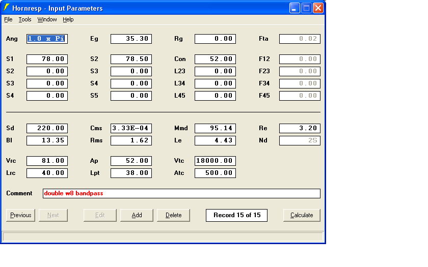

Okay, not a tapped horn post, but I guess tangentially related. I've seen several folks raise the question of whether a tapped horn has any advantage over a 6th order bandpass. My preliminary WinISD bandpass models weren't too encouraging, but when I realized that Hornresp would happily model them, I figured I'd try.
The result is far more encouraging. Hornresp and WinISD actually agree *IF* you model Hornresp in 4pi space; many of the smaller tapped horn models discussed here really lose some of their lustre when you level the playing field.
Anyway, I worked up a dual Tanb Band W8 6th order bandpass model, and aside from the predictably limited bandwidth (which actually works with my target 50-55Hz xover), it looks pretty decent. Flat to 20, ~115 dB max spl at 20Hz in quarter-space (although you're probably getting some serious chuffing at this level), in a package ~105 litres according to the Hornresp schematic. No image hosting, so I'll have to attach the model.
So, my question is: at home listening levels, are bandpass enclosures practical? Aside from the sensitivity to accurate driver measurement and port tuning, what are the other issues?

You might want to rethink the port sizes, chuffing will be an understatement. One of your ports is 52 sq cm, the other is 78. Those are some tiny little ports. This brings us to the point - port linearity and port compression. (In other words, at high spl the port tuning may shift and output may be compressed.) According to the findings of others, this is a huge issue. But any box alignment that uses "small" ports will suffer these same issues, not just bandpass. Tapped horns, with their "large ports" won't suffer as much if at all from those issues. Anyway, your box will gain quite a few liters once you resize those ports.
Also, others have commented on excessive group delay in 6th order bandpasses IIRC. I've never worried much about GD.
Every design has it's inherent compromises built in. Please note that I've never built a 6th order bandpass, only modelled them to compare to other things like ported and tapped horns, and these issues can't be seen with modelling software.
Hope that helps.
BTW, it's been awhile, but doesn't winisd use 1/2 space? (Not 4 pi, IIRC)
Absolutely, if the vent mach can be kept low along with keeping its length short to reduce out of band pipe harmonics that can comb filter with the mains' output, so for small cabs one or more PRs are ideally required.
