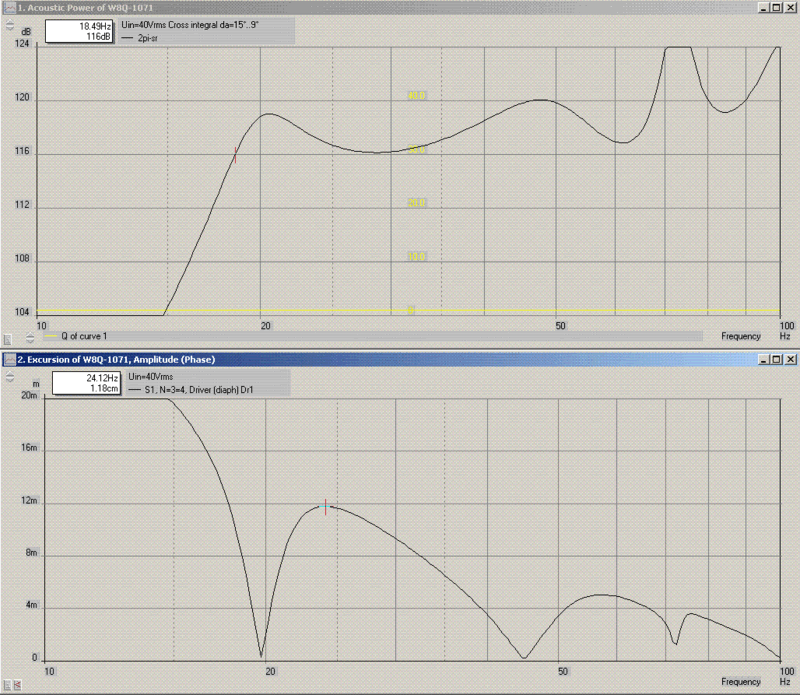

If you guys need a “tweener” tapped horn that won’t be asked to go much below 40Hz-50Hz, then the 18 Sound 10W400 is a good choice for a very broad bandwidth. William Cowan mentioned this woofer before, but it is buried deep within this thread. I just wanted to remind people of this very good tapped horn woofer. It is quit easy to get 2 full octaves out of this woofer in a tapped horn.

|18Hz Tapped Horn
Def_Const |Horn Dimensions
a1 = 400e-4; |Area at throat (cm^2)
a2 = 460e-4; |Area at rear of driver (cm^2)
a3 = 2200e-4; |Area at front of driver (cm^2)
a4 = 2400e-4; |Area at mouth (cm^2)
l1 = 32e-2; |Distance from throat to rear of driver (cm)
l2 = 480e-2; |Line distance from rear of driver to front of driver (cm)
l3 = 72e-2; |Distance from front of driver to mouth (cm)
Def_Driver 'Dr1'
| Tang Band W8Q-1071
Sd=920cm2
fs=27Hz
Qes=0.32
Qms=4.36
Vas=176.44L
Re=6.4ohm
Le=2mH
system 'S1'
Driver Def='Dr1' Node=1=0=3=4
Waveguide 'W1' Node=2=3 STh={a1} SMo={a2} Len={l1} Conical
Waveguide 'W2' Node=3=4 STh={a2} SMo={a3} Len={l2} Conical
Horn 'H1' Node=4 STh={a3} SMo={a4} Len={l3} Conical

serenechaos said:And another vote for using the Eminence 4012HO narrower, but lower bandwidth.
Good for mid 20s, below that in room.
Finished a pair a few days ago, truely amazing.
Thanx JLH!

Hi Iand, all
I am probably starting to sound like a skipping record by now but it is critical in “trusting” computer models, that the trust is formed as a result of measuring the actual item and comparing it to the models and tweaking the model where needed..
For example for small horns like discussed here, an issue relative to this, Akabak often predicts higher “Q”s than one measures on the real thing, occasionally some predicted features in the response don’t even show up at all.
Also, there is an internal loss element, which is required, which IS NOT included in the normal models, unless you have put it in.
Don’t get me wrong, Akabak is a wonderful tool, I wouldn’t have been able to make any tapped horns that worked properly without it, but it is not the last word, a good measurement is.
It is the critical tuning and specific proportions needed which prevented any of the similar looking configurations form being successful products or even existing as products today. You can’t stumble into these alignments.
So far as excursion, this is a factor here too, the peaks are usually not as high and the dips not as deep as what is generally predicted, if your going to focus on getting the max out, you must also adjust your models to fit measured reality as closely as possible.
Also, in pro sound, it IS customary to measure power etc using pink noise.
Dave Martin felt this was an important issue, a sine wave was good for mechanical testing while noise was much closer to real program material.
Both are good signals, the TEF uses a swept sine while Pat at Synaudcon uses noise for his tests.
That pink noise signal has a 6dB peak to average ratio, that is a 1000Watt rating requires an amplifier that can put out 4000Watts.
Our measurements for the TH-115 are done as stated, at 10 meters half space driven at 100Watts nominal input for that Z and measured with an HP3456a Voltmeter, Earthworks instrumentation mic and TEF machine.
What is show is EXACTLY what was measured and anyone can repeat it.
