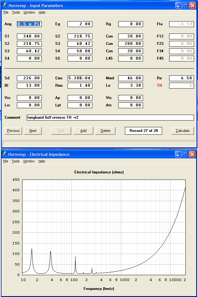

As promised, here are the updated hornresp data / impedance curves that I used. Compare with the observed impedance measurements if you wish (I'm guessing the difference observed 2nd impedance peak could be because of folding anomalies)
Observed impedance plot at : http://www.diyaudio.com/forums/attachment.php?s=&postid=1664991&stamp=1227322671
Theoretical impedance plot:

my project was an experiment... I don't know if I really create this sub... probably for extreme car audio is good, but for PA is too big and the real SPL is too low...
also in my opinion the initial spl performance was too high for this kind of driver...
thanks for your opinion!
Sabbelbacke said:
of course one is in 2pi space A sub allways is when standing on the ground (well, not quite, but since the wavelength of interest is long enough, there almost ist no directivity). That´s also the case @home.
In your simulation above, you are feeding 2,83 Volts into the 0,75 Ohm Driver, which actually equals 10,68 Watts. Going with the standard and not taking Re but the DIN-Numbers into account, this is a 1 Ohm driver configured like this, so 2,83V into 1 Ohm are still 8 Watts.
If you want to know how much SPL you have at 1W/1m, you have to enter 1 Volt at the "Eg" field in hornresp. Doing this, you get a liitle more than 96dB.
to calculate the true spl i have set the EG = sqrt( Re ) = 0.866V getting 95dB exately the same spl using akabak! OK, that's right!
Sabbelbacke said:
True, 30 Hz is "nice to have" and very rare in Pro-Sound. There are not many applications where it´s needed, one usually takes infras for this kind of thing.
I agree, if you need it, this sub surely gives more bottom than the regular PA-Sub.
My point was the sensitivity which is much lower than assumed when taking a quick look at your sim. SPL is important in Pro-Sound and having a box this size which "only" delivers around 125dB @ 1,5kW might be a dissatvantage, considering a economic point of view.
i'm according to you... in PA dB are our friends!
in my opinion to get the most SPL in tapped horn we have to use driver similar to the ideal horn driver: low qes, high fs (or not?) AND high Xmax...
what do you thing?
Sabbelbacke said:
Thanx, I found this link, too. That´s why I asked about the other data you have, since not everything is listed on this page and PDFs are not available. Of course, it´s easy to re-calculate some of the data, but it´s not easy to see if they are authentic this way. There are too many Car-Subs on the market with highly tweaked spec sheets. E.g. the enormous weight should result in quite a big Magnet resulting in a very high BL product. Looking at the specs, it´s not that big - so I assume the enormous power handling capacities result from a fairly wide air-gap. But it´s hard do tell without having more data (e.g. airgap height, vc height, type of voice coil former, etc.) There is no price (or am I blind?).
the sub is really good, in my opinion, for high low frequency output, sincerally i don't know if the t&s are correct...
but the performance/cost quotient is really high! thanks to a friend i can get this sub for less than 250€
Sabbelbacke said:
I surely didn´t won´t to be disrespectful to your deisgn, but you asked about opinions Being for pro-sound for many years now, I wouldn´t want to have to use this much amp-power to acheive a certain SPL. In my experience, most drivers like this tend to have a very high power-compression, so even if you would have 5kW Amping available, it woudn´t result in a linear increase of level (it never does, even the best PA-Speakers on the market have around 3dB powercompression at their rated max-level).
i'm very happy to discuss with good and very clever person!
