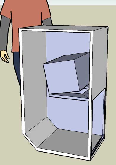

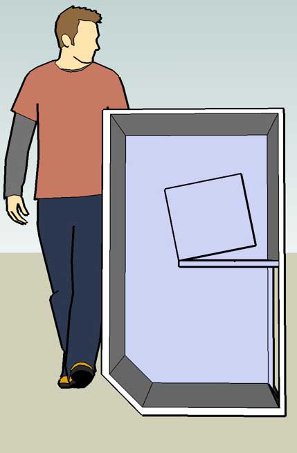

Hi guys....
I'm jumping in here a little late and I'm trying to read through the thread , but I've got a couple of newbie questions here. Also just for the record, I'm a mac user so hornresp is not an option ATM, but if I decide to pursue the TH as my next project I will do the virtual PC thing and D/L hornresp and learn it.
So my question pertains to horn size (e.g. overall box size) vs. bandwidth vs. power handling.
Question 1
What factor determines band width the most, (a) length of the horn, (b) internal volume of the horn, or (c) horn mouth.
I am mostly interested in getting up to roughly 100 hz. where I can cross to my mains. The bottom end needs to go to about 40 hz roughly, but if it goes lower, that's even better.
Question 2
Does a bigger horn/box size adversely affect power handling, such as a traditional vented box does?
This would be for live sound use. I am trying to balance output, efficiency, and box size. I don't need extreme low end output, but anything under 40 hz is welcome.
Basically I am looking at a design with the eminence definimax 12 or 15. 2 or 4 cabinets depending on how much output can be had. These would be for a band PA that gets rented a couple times per year, and has to fit in a van or small trailer.
So what are the general guidelines for tuning vs. efficiency. Is it bigger box = higher tuning and more efficient, or does changing the apparent size of the horn not change efficiency that much....
Thanks in advance,
-=Tim=-

"What factor determines band width the most, "
The limiting factor seems to be the upper dip in the frequency response of the TH. This is related to the 1/4W length of the TH, and where the tap is in the mouth. The closer the tap is to the mouth, the wider the bandwidth seems to be. Lower Qts drivers seem to like being closer to the ends (throatand mouth).

Somewhere in this thread someone posted a pdf containing a guess at a folding scheme for the th115. Where the throat split into 2 paths. Is this necessary, or couldn't it be made simpler like a traditional bass horn? Just move the location of the driver like this....
That's incredible for 2 twelves!
The section in the middle where a woofer would be located in a traditional bass horn is now empty space, where you *could* mount a resonator or 2. Or tune the size of that enclosure to BE the resonator.
You could also put a hatch door on it like is normally done to mount the woofer inside, except you would now use it to access your resonator(s) for tuning purposes.
Thirdly that space could house an amp.
Fourthly you could cut it out and have a hole through the middle of your speaker cabinet!
Feel free to let me know if this is not a possible folding scheme for whatever reason. I am still deep in the learning process after all....
