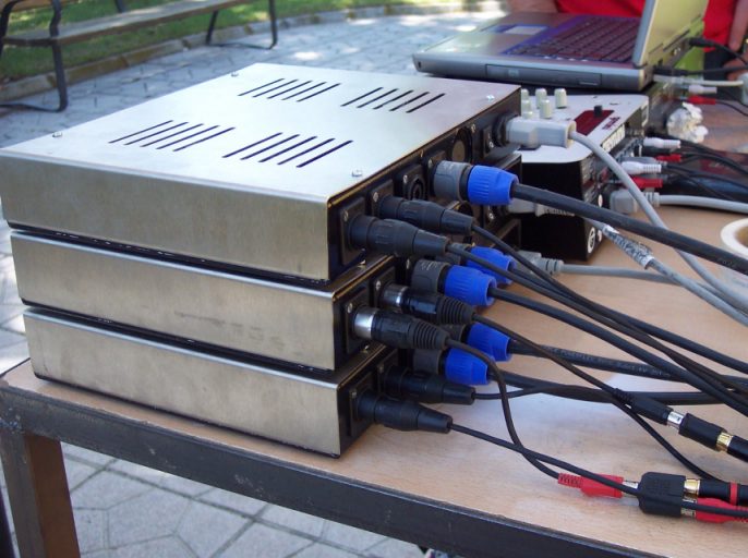

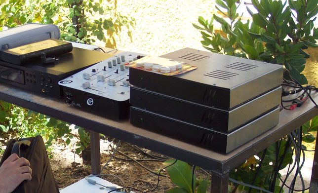

Here is a photo of another very succesful model: It is a 2x400W/4ohm or 1x1000W/4ohm amplifier (based on SPS80+2xBP4078 r2). Tested in many open-air parties, etc, has shown great reliability and sound quality.
These photos show a pool with 3 of these amplifiers: The first one moved 2 2x15" Yamaha loudspeakers in stereo setup, the second one moved 2 2x15" JBL loudspeakers in stereo, and the last one was bridged and moved a 4 ohm _BIG_ PA subwoofer. Total: >2600W in a very reduced space.
They have turn-on and clip/protect indicators for each channel, although they were off at the time of the photo, that's why you can't see them.
