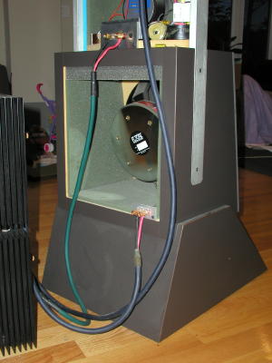

Dan, I have a pair of Hawthorne's still in the boxes after a year because of health issues. How are your baffles set up, please? I'm just collecting input before I build.
Cheers
Stuey
Stuey, you don't want to set your baffles up like my baffle (I listen in mono). Back when I built it I thought that you could just make a large U-Baffle and get more bass. I was foolish. You'll need an extreme baffle, too big to move around, if you DEEP bass from OB. Well, I guess that depends on what you consider deep bass. All I got was a midbass boost and a rippled response above it. U-Baffles are not your friend for midrange. They will help you lower the speakers resonance, lower it's efficiency and raise it's Q and thus allow an OB to play a bit deeper and could be useful for a bass driver. A small 20-24" wide flat baffle around or even over 3ft tall with the SI place on the top third, perhaps a bit off center, and a bass driver underneath cutoff below the baffle boost frequency and the SI cutoff above it will get you a much flatter response. Download Martin J. Kings pdf on an OB 2-way for guidance and also the Edge Baffle simulator or Basta for a more complete picture. My baffle needs reconstructed. I really have not tried to work out perfection on it b/c I only began to understand what I know now in the last couple months after stumbling on some other discoveries, and I'm more excited about other projects. Crossing over the way that is popular over on the HA site with the bass driver coming in very low should get you a midbass spike on most baffles. If that's your boat, by all means float it, but right now I'm looking for a flat response.
http://www.quarter-wave.com/OBs/OB_Design.pdf
Home of the Edge
Good luck Stuey!
