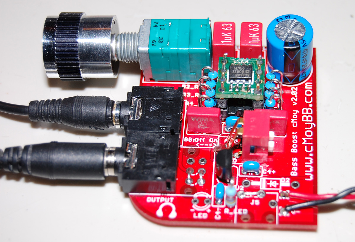

I just boxed up the red cMoyBB in a transparent blue Hammond enclosure. I also almost finished my green cMoyBB today. Yup I've made another one...
The green one is DC coupled and as of writing is still missing its bass boost pot. I also used miniature 1/8W resistors on this one. Gain of this green one is 6.5. I'm gonna let it play for a couple of hours to burn in. Picture shows it as it was in progress.

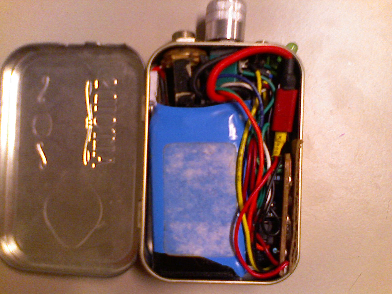

One day I would like to build the Cmoy right into a pair of headphones. I think that would be handy. I built it into a belt pack and don't use it nearly enough, mainly because I am a carpenter who wears a tool belt all day and have enough stuff to worry about hanging off me.

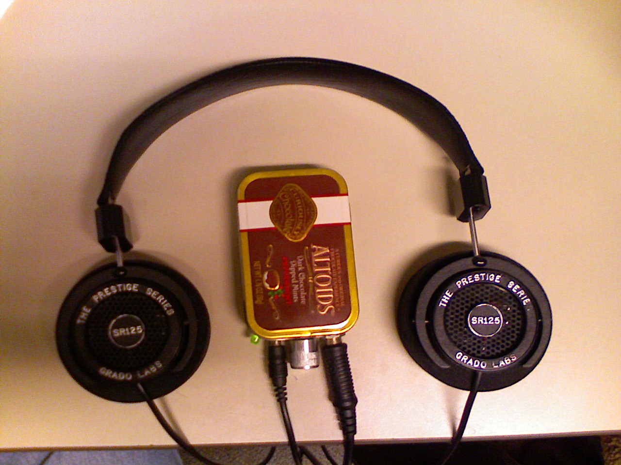

I already have the parts for the JDS Audio Cmoy. My only problem is I need a better hole puncher for the Altoids can.

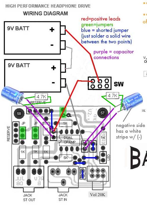

I see TheSeekerr good describe practical way to fix this amp.
Johnny Blue, here is my step by step tutorial:
1. Remove two wires from switch to board completely
2. Desolder from switch two wires, coming from both battery, connect both wires together and isolate
3. Desolder from board one wire, coming from battery + terminal (red)
4. Solder in this place spare red wire
5. Solder switch between this wire and desoldered battery + wire
6. Solder two 4.7K - 10k resistors paralell to el caps. You can use any resistance in this range, important is - both must be matched at least 1%. This determine both voltages equal and low DC offset.
Now measure voltages between ground and +, ground and -, both must be equal.
Now measure DC offset in both channels, if it is good, you are ready to connect phones.
However this board is very strange, both el. caps are in surprising right place, close to chip, near the chip's power pins (almost like in by boards). This increase sound quality, however not many CMoys builder use this technique, common in Gainclone.
To utilize this better, solder caps deeper in board, with as short as possible legs.
Maybe, if your enclosure allow it, you can solder both rail splitter resistor on boards other side, right to caps pads.
Zigis, can you please look at my modified circuit in the attachment and tell me if it is correct?
I have followed your instructions as above (I think!).
Hi taliesyn, yes circuit look correct.
Before connecting phones, measure voltage between ground and both chip power pins (4 and 8), both must be equal, with opposite polarity. Then measure DC offset on output.
Goo luck!

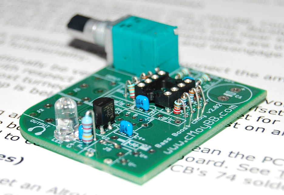

I have a problem on the bass boost that I have added,
this is the one I found here
and the schematic is this one:
(for each channel)
and i followed that scheme and make my own:
Left
Right
now the problem is, i dont know why it doesnt make any changes when i turn it on/off.
questions are:
1. is the original schematic (1st image) correct for bass boost?
2. are my own schemes (2nd & 3rd image) correct?
3. did i burn or damaged my "bass boost" resistor and cap?
4. it is still working perfectly right now, even with the bass boost switch is on/off, its just that it doesnt make any changes when i select it. if it was damaged (#3), does the amp still work?
5. as you can see, the values in the original bass boost circuit, especially the cap is different from the one i did? I know the fact that the higher its values, the lesser it cuts off the low frequency. but at least i can hear difference because of it, am i correct?
thanks
