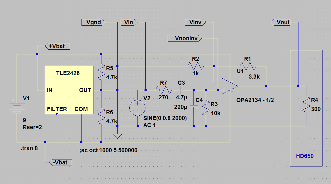

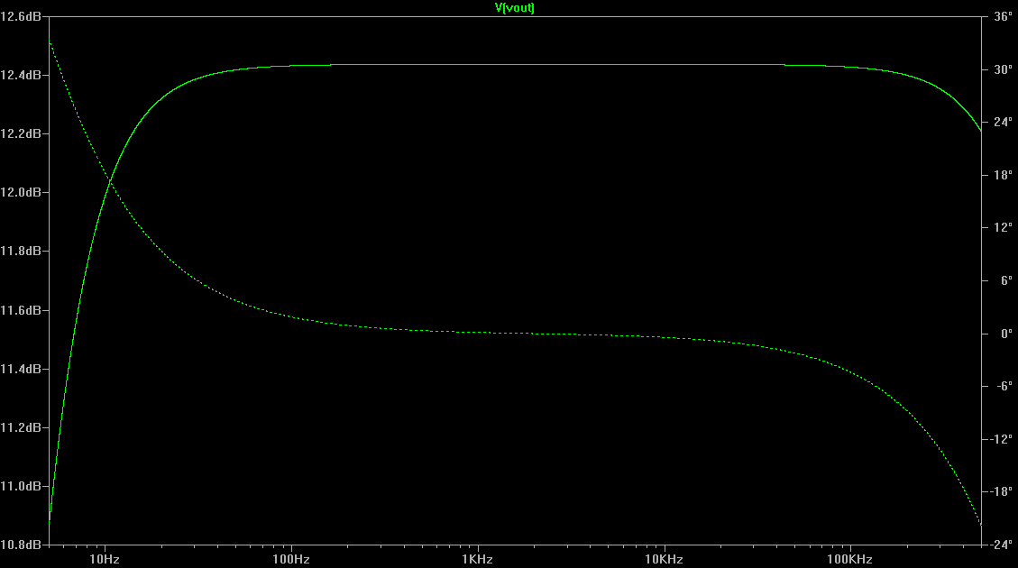

Try adding the RF filter that NwAvGuy used on the O2, a 270 ohm resistor in series with the input and a 220pF ceramic capacitor to ground following it. That will give you an RF filter with a corner frequency of around 2.1mHz, high enough that the gain roll-of won't affect the audio band. The attentuation of the input signal would be minimal with a 270R / 10K voltage divider. Also consider replacing that 0.47 coupling cap with a 2.2uf - 4.7uf metalized film, like this one to solve that high pass filter problem.
MKS2B044701K00KSSD WIMA Polyester Film Capacitors
The results look pretty good, below! The magenta is the current through the 300 ohm headphones with the scale on the right. The others are voltage with the scale on the left.
I have totally no idea how to use LTSPICE. Cant even add batt symbols. LOL
BTW. i added bass boost circuit within the feedback loop and after R4. 0.22uF + 4.7k res
Distortion still remain...
Until i double up my supply to 18v.... I just noticed that 4562 minimum voltage = 5V!!!!
