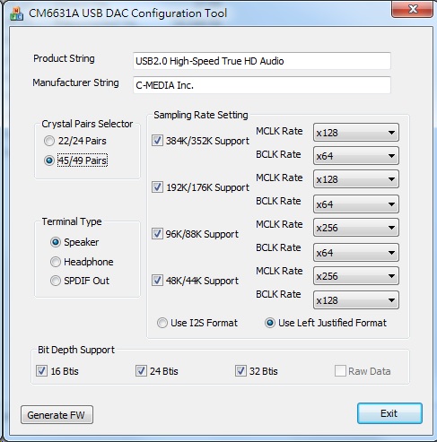

CM6631A Configuration Tool
Hi All:
I got a beta version of configuration tool for CM6631A. It can configure CM6631A I2S interface. This tool should can easy let you to configure CM6631A to control external DAC codec(like Ess9018, PCM1792 ...). Do any one want to try it?

@ tdtsai
Looking at the picture of your post, this tool can configure the bitclock, so that it might be possible to set up 64x instead of 128x FS for 44.1/48 Khz sample rates... This is exactly what I need, as my DAC doesnt take higher bitclocks than 64x FS.
Already sent you a PN and looking forward to your mail :) Thank you!
Hi All:
This tool will generate new firmware for CM6631A. You just need to update the firmware which generate by this tool into your device. Please note the firmware which generate by this tool will only enable one I2S output. Basically this firmware is for USB DAC module. Something like follow URL device.

If you update this firmware into you device, you device driver should be install automatically. The driver is on windows update. This should be very convenient for DAC DIY user.

Your I2S Configtool saved my day :). Thank you for affords!
Now I can connect my CM6631 via I2S. Before, the double rate Bitclock (x128 FS) made the I2S Out unusuable with my DSP.
Any Plans to update your tool? I think for many CM6631A users, this is a needful Tool.
Are there more parameters which could be set up via the firmware? Does anyone have a data manual, with all the register settings explained for cm6631a?
BTW: I used the tool with the CM6631A from Breeze Audio (gray metall case).
