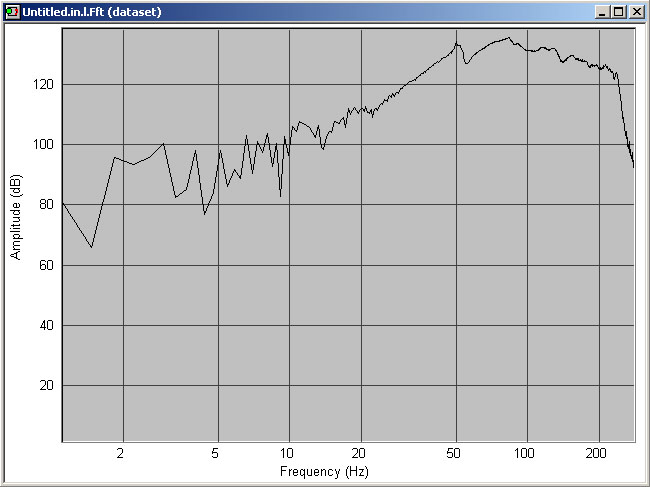

closed sub -> open baffle ?

If you are finding it boomy I suspect that there is an issue with the room and/or the integration with your main speakers and there is no need to cut your subwoofer. Try moving the subwoofer around. How are you driving the sub and what filters and EQ etc are you using? Details of the subwoofer as well would be helpful...
Well i gave the dimensions and i gave a link to the specs of the driver...
I moved the subwoofer around for some time now, but nothing helps.
I think richie00boy is right, it seems you doesn't have a lowpass filter because your subwoofer is strong over 80 Hz. It's also overboosted in that range. Try lowering the gain of the subwoofer maybe.
I doubt going dipole would help much, but you could try...
I found it hard to believe it would be because there is not a filter present.
So I tested some more and found out it was my own (dc coupled) amplifier.
