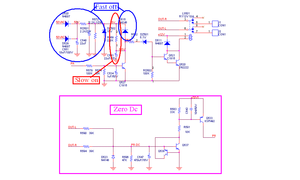

Oh , so i think you should be make a KIT speaker protec on output
when using it, I found peace of mind .
DIY mà
Of course,but it only protect speaker(zero DC,slow starts,fast off,...)not protect over current for mosfet.

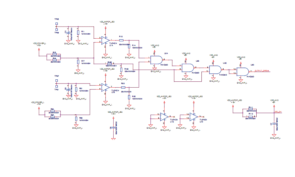

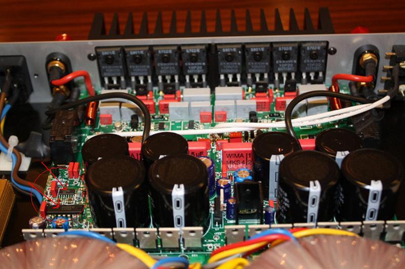

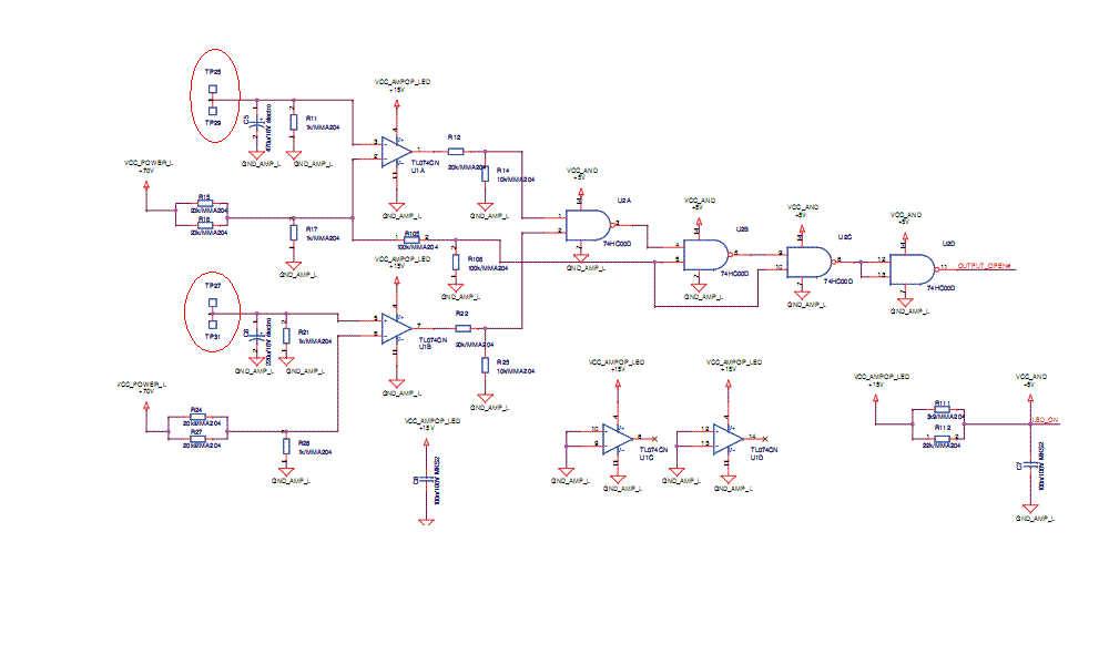

What are this two parts function on the Metis 3? Part of protection? Can you show us?
Yes.
Part protect circuit of the metis3 including two IC: TL074CN and 74HC00D.
TL074CN have four units opam,using two 2 units opam for sampling from B+ comparison with voltage reference,not use 2 units.
74HC00D to control driver relay speaker.
When have problem on B+ is voltage reduced => Protect
Not protect zero DC.
Thanks, where are TP 25,29,27,31 connected?
Not connected anywhere.
Positive of the opam always is Low
Negative of the opam always is High
=> Output opam always is Low
This Low level will comparison with voltage is 70/11k/2= 3.18V
When have problem in B+ is this voltage will up or down => the change in output 74HC00D (pin11)
Regrads.
Thank you
My opinion, to perform this simple function not need to use complex circuits diagram so.
I also do not understand why Goldmund use the TL074 (4 units opam) without using the TL072 (2 units opam)
There are places they use components is optimal.But there are many places they use components very difficult to understand.
When I clone them,I usually remove these parts.
