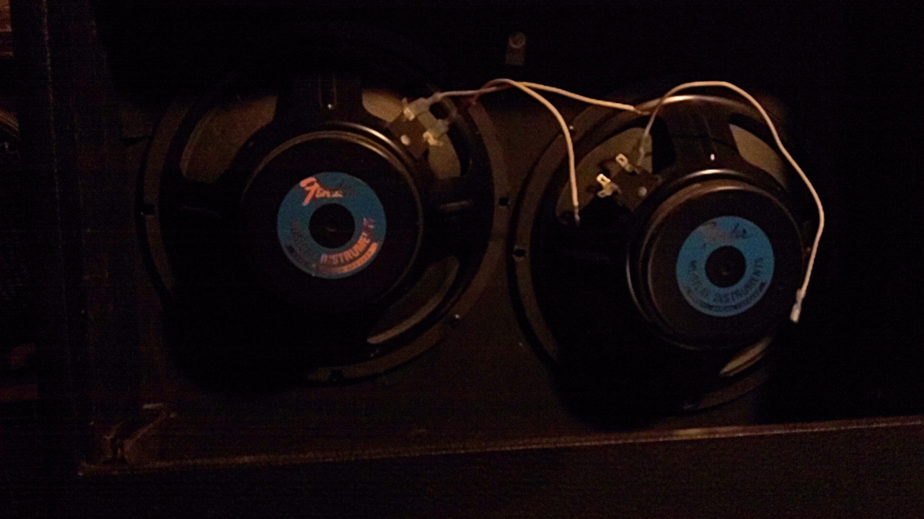

I've got a newer (not sure of yesr) Fender Vibrolux cab with reverb tank and 2 original 10's and an empty Dual Showman cab (either '73 or mid 60's, not sure) for sale or trade in North Georgia. 7064296900
