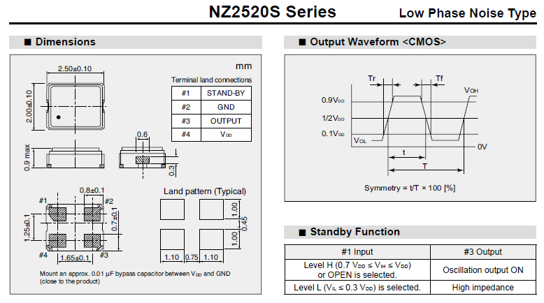

Although some time ago this thread was active I hope one of you can give a quick feedback on this:
I'm currently designing a circuitry using the NZ2520S crystal from NDK, however, looking at their datasheet I cannot see if the pads are seen from above or from the bottom. One of you knows?

above, its a fully surface mount component
Hey - thanks for replying... Are you sure? The Crystek CCHD-997 (I think it is) sees the chip from the bottom in their datasheet (similar to the lower left corner pad layout on the NDK image attached).

Hi both - thank you for your replies - to me it's quite special to be able to get help from others in a forum like this ;-)
Just to make sure I've inserted a thumbnail of the crystal seen from the top but with the pad configuration shown as if I was looking down from the top - through the crystal. Is it right now?

my apologies, I saw the plan view with the dot and didnt think further. what a stupid diagram… being SMD who will ever be looking at the bottom of the chip when working out which pin is which and landing patterns will only ever be on the side of the board where the part is, so what point is it to know what pin is what from underneath as the only view? ie the pads will never look like that.
is it that they are giving you the landing patterns already for litho?
wow your right, my CCHD-975 DS has the same thing. could be a left over standard from PTH parts?
I would have thought datasheets should portray information in a literal manner in the way it will be used, not catering for some outmoded standard. it makes no sense, sure have a pic of the part like that if you must, but reversed landing patterns to match it? weird.
