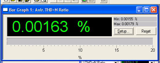

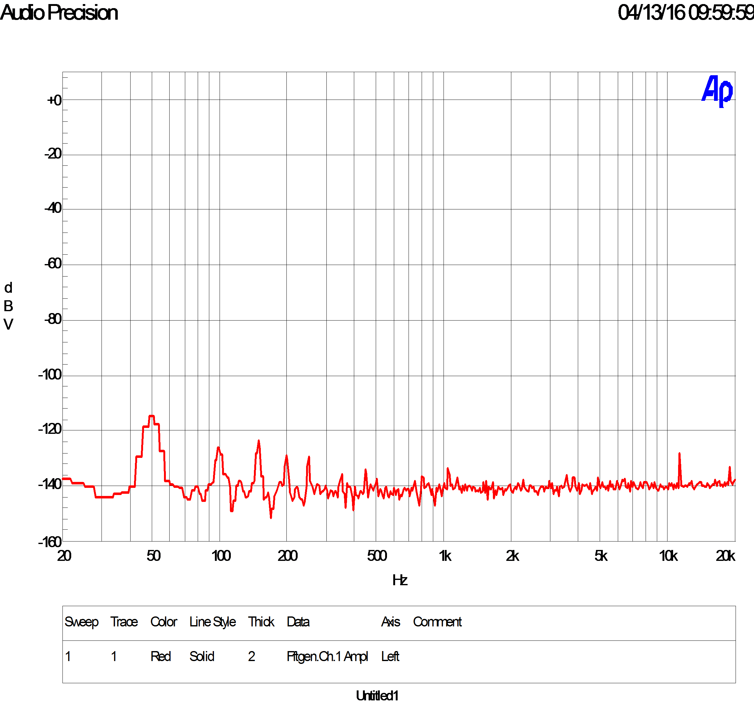

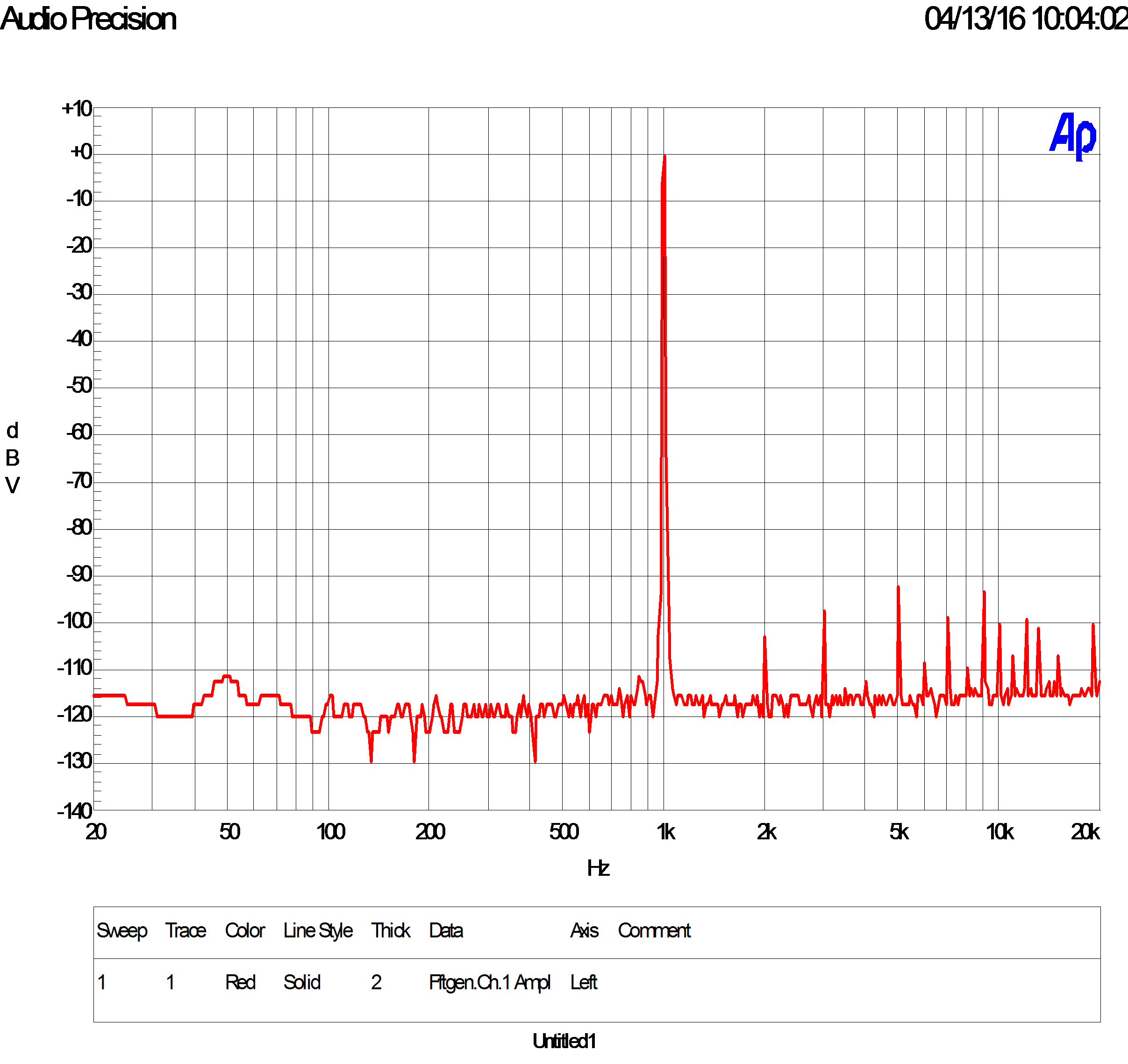

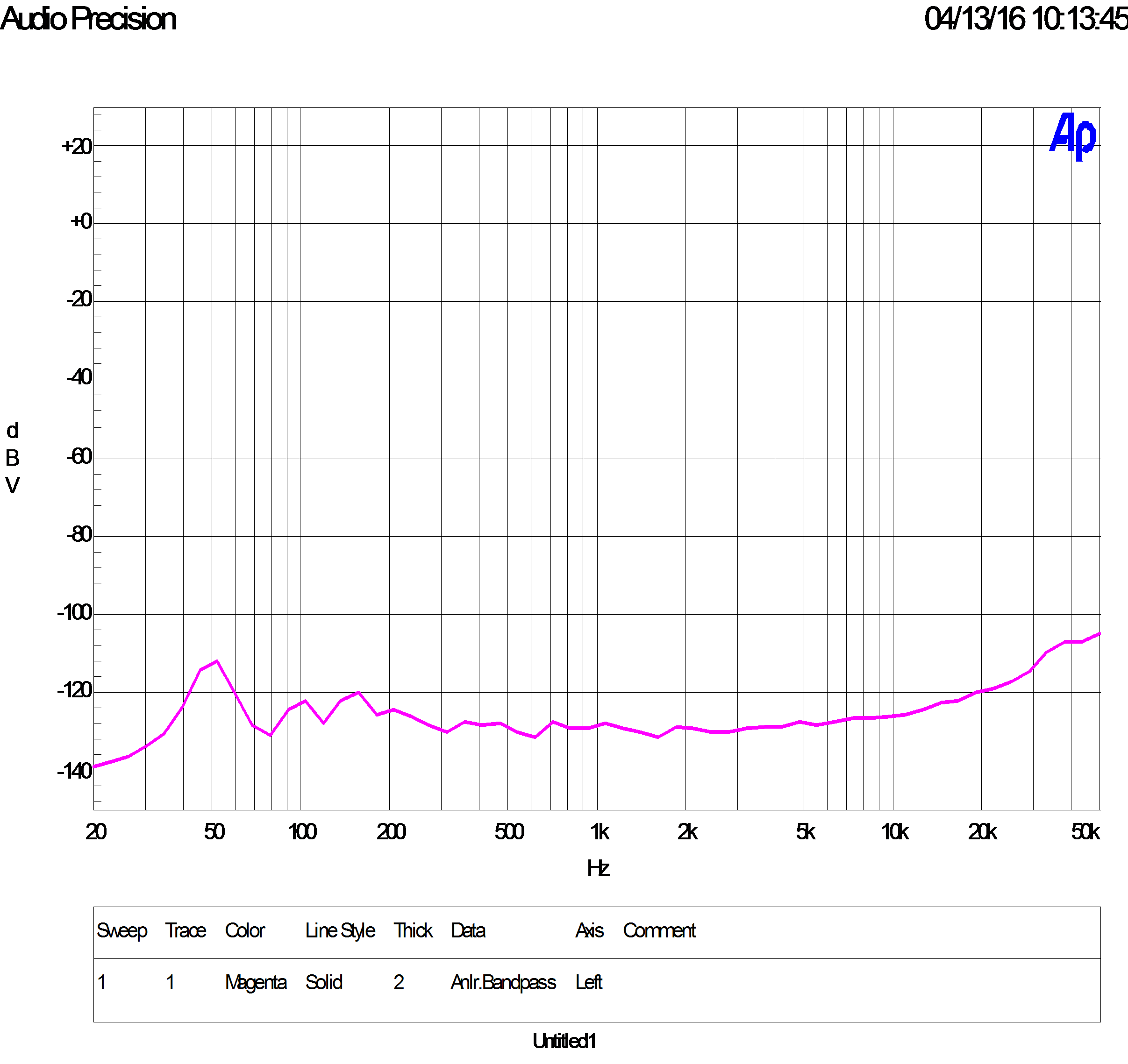

Just a few AP-S1 measurements of my CLIO Pocket.
AP-S1 sampling frequency was 48 kHz. AUX input was connected to CLIO Pocket output.
The bar shows THD+N of 1 kHz, 1 V output.
Right most figure shows background noise level measured by using bandpass filter of AP.

Very good result. Few sound card in the normal value has such a solid parameters

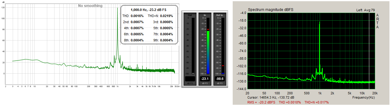

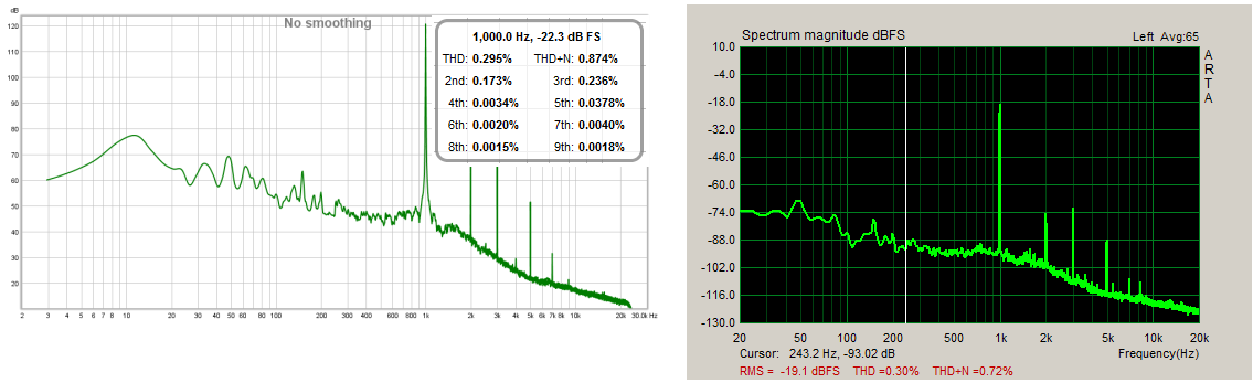

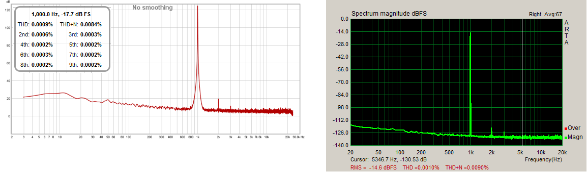

Hi,Panson
Thanks for your kind response!Today I find out that something interesting in REW and Arta.
First of all,all kinds of functions that I test between them indeed the same outcome and get the identical result.
Whilst I feel that REW outperforms Arta at some extent including data interchange,fast SPL calibration,data curves comparisons and the unique wavelet transformation.However,I realize that one display parameter should be been pointed out,that’s the RMS input level in the RTA spetrum.In REW it seems that 3dBFs higher than Arta if you feed the same signal level into them and make comparisons(I use an additional signal generator rather than the one into them providing the identical source entirely,take a measurement of the 6” monitor box with the nearfield method and keep all the conditions equivalent ) .Furthermore I also perform an another experimentation with the soundcard loopback testing.The results list below,please take notice of the RMS level displayed
Something weird?Disregard the RMS value ,THD and THD+N make no difference nearly.Maybe several checkouts can make it come out. Whereas it’s still a very good and excellent measurement tool.
Thanks for reading!
This is probably due to the REW and ARTA defining the dBFS in different ways.
See here
a) RMS value of a full-scale square wave is designated 0 dBFS, all possible dBFS measurements are negative numbers. A sine wave could not exist at a larger RMS value than −3 dBFS without clipping,
b) RMS value of a full-scale sine wave is designated 0 dBFS, a full-scale square wave would have an RMS of +3 dBFS
This is usually what explains the 3dB difference between measurement systems.
Meaning that you can test this out if you feed in a signal that is just below clipping and see what value each system gives you...
See here
Good job,one should pay attention to the 3dB difference to the signal feeding into the system!Note also test the voltage before making measurement.As long as the same amplitude the signal is,the same result regardless of what the RMS value shows.This is usually what explains the 3dB difference between measurement systems.

This morning another confirmation makes here.Just remember the signal generator should attenuate 3dB before THD measurement then will obtain the same outcome.Under this circumstance the RMS level in REW show 3dB lower than Arta.That's it!

I don't think it is a different level into the system, it is referenced differently to 0dBFs. No?
Jan
Jan
Both the levels are the same in dB which can be tested with SPL meter for confirmation,just REW looks upon the clipping level as -3dB around as some soundcards may cause clipping!
