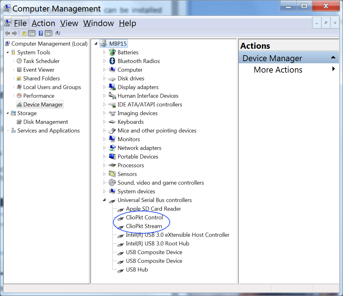

5. Open Device Manager. This is what a working installation of the USB drivers looks like:
6. If you do NOT see either of the (2) ClioPkt entries, skip to #9.
7. Right click on "ClioPkt Control", select uninstall, click "OK", then click "Delete the driver software for this device".
8. Right click on "ClioPkt Stream" select uninstall, click "OK".

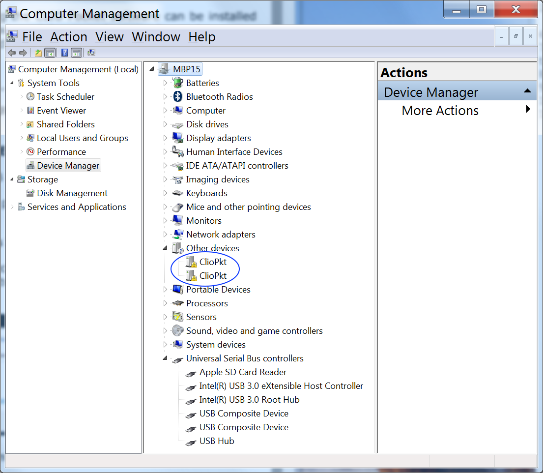

9. Unplug the CLIO Pocket hardware from your computer.
10. Plug the CLIO Pocket hardware back into the port you will normally use.
11. Look in Device Manager, you should see (2) "ClioPkt" devices under "Other Devices" like this:
12. Right click on the top "ClioPkt" device and choose "Update Driver Software..."
13. Select "Browse my computer for driver software" and select the folder with "CP_Drivers_v2.12.18_Vista-10" you downloaded.

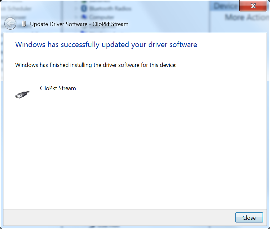

14. When the OS asks "Would you like to install this device software?", select "Always trust software from "Audiomatica Srl".", then select "Install".
15. After a few seconds you should get a reply like this:
16. Select "Close".
17. Right click on the remaining "ClioPkt" device under "Other Devices" and choose "Update Driver Software..."
18. Repeat the steps you followed for the first device.
19. Open or reinstall the CLIO Pocket v1.5 software and it should work. I just went through these steps and mine is working perfectly again.
