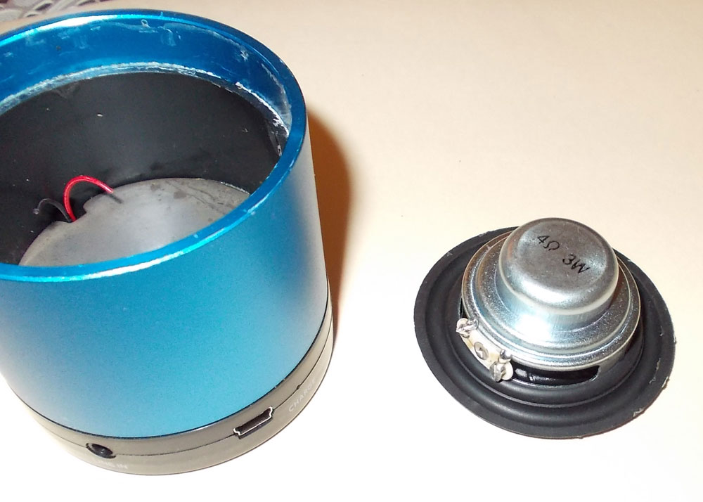

I am new to the forum and interested in small speakers with big sound. I recently came across some wireless (bluetooth ) speakers that I repaired for a friend of mine. I was amazed at the sound and quite rich sound these speakers make. They are 57mm diameter and 60mm high with a 45mm speaker and a built in 3W amp. They work great on a kitchen bench or any surface that can resonate a bit. The kitchen stainless steel sink or the acrylic bath in the bathroom is quite amazing. Steel filing cabinet works well also.
They way they work is very clever and have not come across this before so I thought I would share it with you as it may be of some interest. I do apologise for the poor blurry photos but at least it may give you an idea of what I am trying to explain.

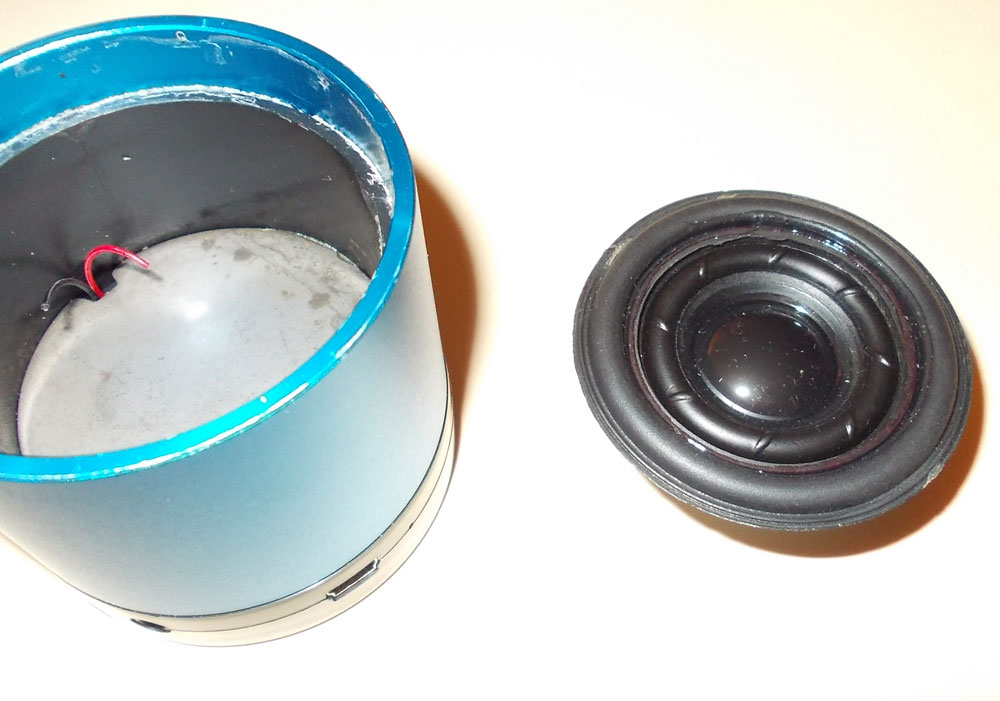

They have a clever pseudo subwoofer arrangement where the speaker frame has an extra rubber surround on the outside and the surround is glued to the enclosure. This allows the whole speaker to move and act as a subwoofer. It has a very small cavity and relies on the surface it sits on to pick up the vibrations. It works surprisingly well for such a small speaker.

I think you are talking about a passive radiator but I don't think these are really are designed that way. I think if it moves it is coincidence as the bellows is really there to allow the collapsible feature. When expanded the volume is bigger providing more bass. There are diy passive radiator designs around where you take regular driver and add mass to cone with bolts, etc.
