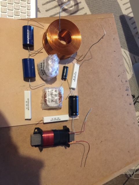

I am midway through building my classix 2.5's and have begun laying out my crossovers.
I would like to use the same crossover layout as I did for the classix 2 (which came with the kit i purchased from meniscus). I have not used an iron core inductor before, so I am wondering what are the placement issues with this type of inductor (facing the other coils/running alongside the coils etc)
I have attached how I would like to place it. Could this cause any issues?
It's about 9" from one end of the layout to the other.
Cheers!

It's just a good idea that coils are placed at right angles to reduce dipole interaction. The idea is if you look down the axis of a coil, you can't see any other nearby coils.
Or keep them well apart. With 4 coils and only 3 right angles available in our own 3D spacetime, something is not going to work.
So keep the worst pair well apart IMO. Reduces crosstalk.
