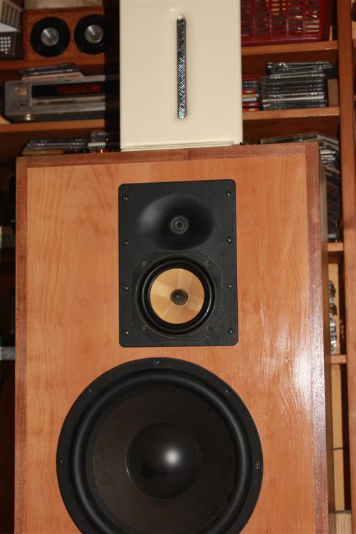

the ribbon super tweeter really transformed the whole speaker
actually, I can only directly hear the ribbon with the ear close to it
so I guess its also phase related
strangest thing is, with the ribbon added, percussion have improved to the almost unreal
I have never heard this much drum rythm details before, ever :)
its like everything flows freely
someone once said a speaker should sound like breath of air
and thats probably the best way to describe it
kind of like its breathing the music
a really nice surprice

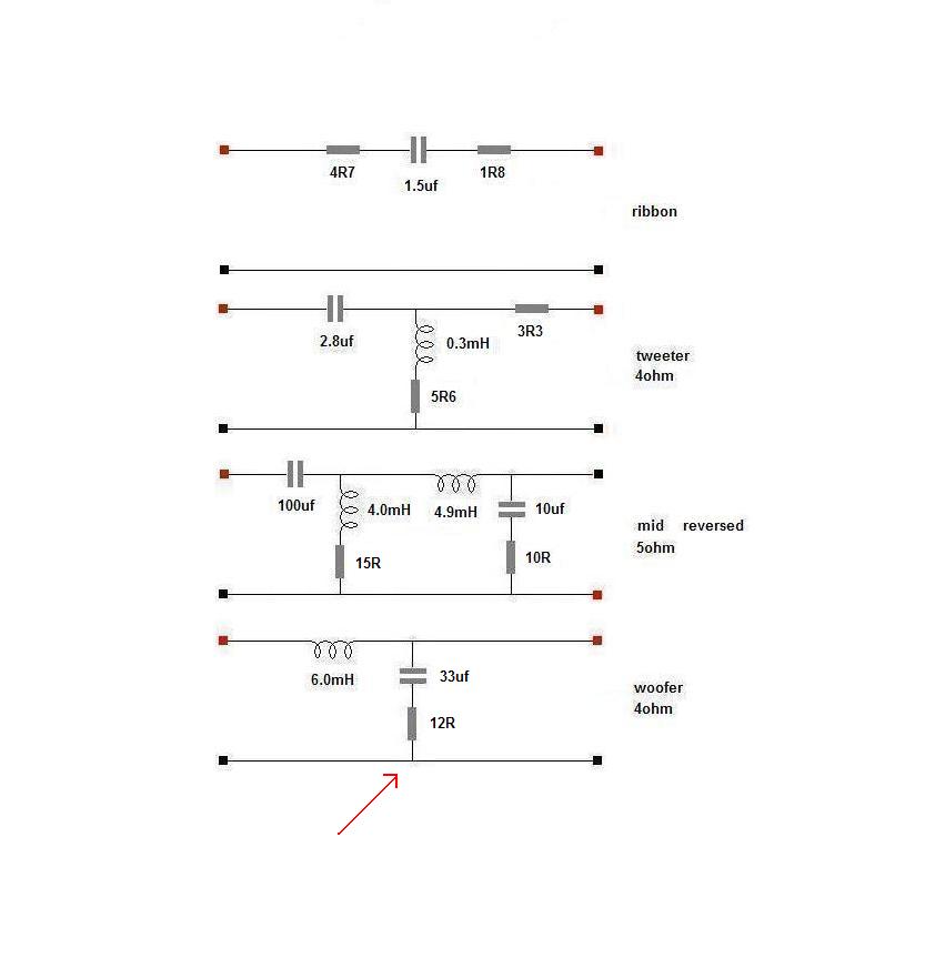

just for the record, xo changes to my build
series cap added on midrange
then phase had to be changed
now looking more 'standard'
with midrange phase reversed
components may still change
but very nice improvement

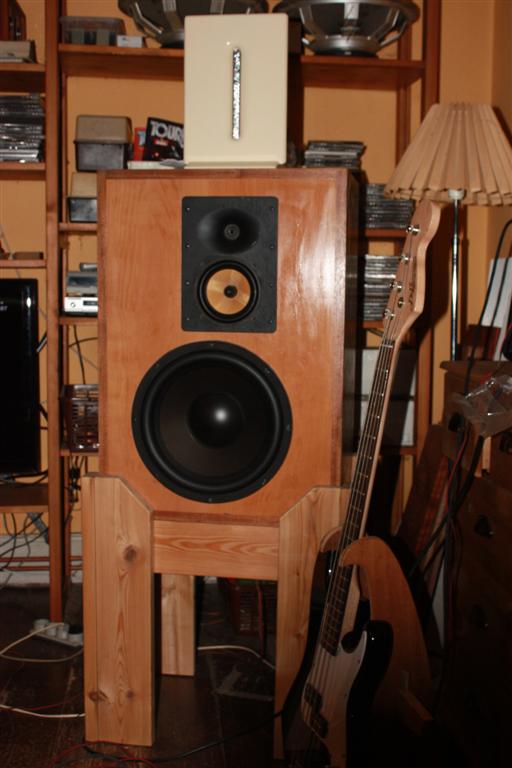

I have listened to classical music for a couple of hours right now
for the first time on these speaker
sitting at the PC it sounds quite good
then I tried so sit properly in my 'audiophile' listening chair
that was a surprice
first let me tell you that I now sit only 4-5 feet from the speaker, or so
and speaker are only 3 feet apart, mid to mid
just about 1 feet between inner sides
please don't ask me why
and it should not work at all, I do know that
but the speakers completely dissappears, as if they are not there at all
and with closed eyes its like being in a concet hall
even with a full symphony orchestra
and its not even loud
simply amazing

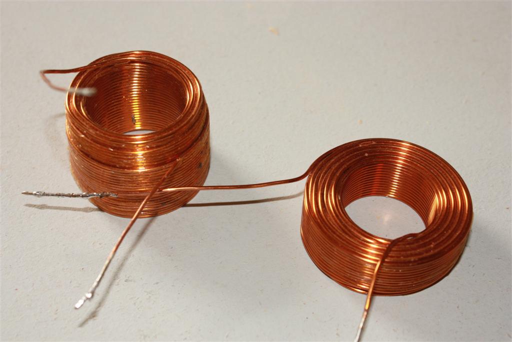

this one is surprising, and strange
below you see two coils
series inductor for midrange
and they sound different
and I was surprised to find, they measure the same
induction and DC
even more surprising
with one mounted on left channel, and other on right channel
the soundstage collapses
the one to the left (see picture) sounds significantly smoother
differense is quite clear
because of this I expect function(rolloff) is different
or maybe it could be a kind of ressonanse issue
but this could indicate possible severe issues when you copy a proven design
its a bit worrying
I do not say one is better than the other
only, they are different

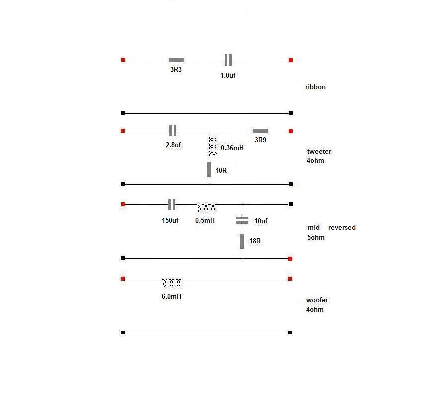

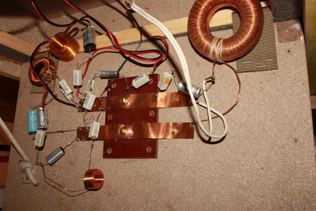

FINALE
now it plays :)
added the missing xobel to woofer high pass
its more or less standard, and normal looking now
maybe apart from ribbon supertweeter
no inductor or anything
acting as active zobel :rolleyes:
physical offset, exstremely critical
really takes it to a higher level
just one more comment, on sound
hard to believe, but this is genuine highend
I had my doubts if that really could be true, and still have
but its simply not possible to overhear
you don't have to listen fore it, it's just there, and you know it right away
the closest thing I have ever heard was original Snells with original Audionote(Japan), with top tuned turntable etc etc
many years ago, and never heard anything like it again
note the cheap 'crappy' XO components :eek::D
I must say, its amazing that this high level of sound quality can be achieved with such
not that its needed, but may still do a few small adjustments
maybe replace the non-polars with poly caps
I guess thats it
cheers :)
