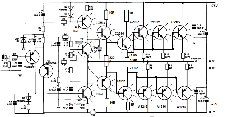

Dear DIY fanatics,
New here, I've got this schematics from school days in the early 90's. Its been long time using this amp at home and planning to upgrade same schematic and power for outdoor use up to 2 ohms.
Original supply was +- 50v . Want to make it +- 75 volts.
DIY experts are invited to join, comment and revise this circuit.
regards...:(
