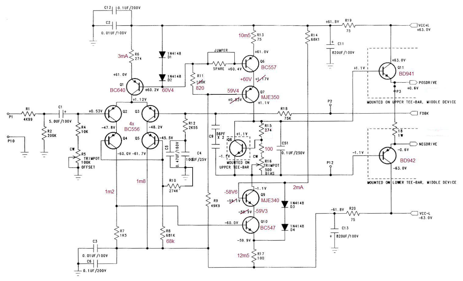

I found this, hope not to many mistakes, transistor nr wrong too.
Made some mod's

Thank you, but that schematic is for later Model 25s and does not match my PCB.

Well that's certainly a tall order unless you have nothing better to do. Replace your incorrectly specified main filters and re-assess. There is really no need to start replacing everything in sight. I wouldn't stress over the Q6/Q9 problem. Why start re-designing the unit? Put in a cooling fan and maybe a vent and you are done. Popping in different transistors won't make it produce less heat. You simply need to remove the heat more efficiently.
This amplifier is over 20 years old and runs warm/hot. My SOP is to replace all electrolytics if the unit is something you are going to hang on to and keep in service, so replacing less than 15 parts is not a big deal. The amplifier is also apart right now and all PCBs are easily accessible. As to changing the circuit, sgrossklass has suggested that this design "error" could pose a reliability issue. This amp was already back at Classe for service over a decade ago for a dead channel. Maybe that error was the cause of the failure?

Still another ClasséThank you, but that schematic is for later Model 25s and does not match my PCB.
I changed the schematic you posted at #16 the same way.
Hope this helps.
