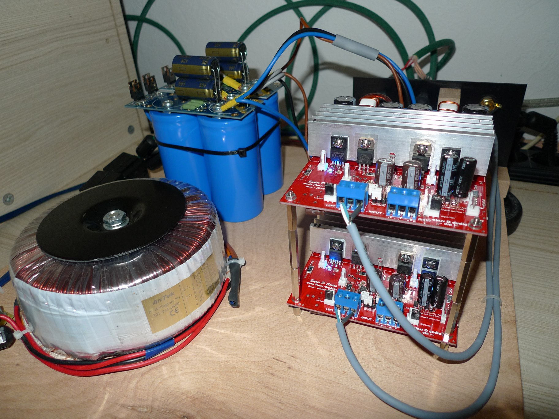

I finally got around to building a test mule of that SDS-224 with parts from the spare pile: 1000 watt 25 VAC Plitron, 6 CDE 11,000 uF caps, generic bridge and some quality connectors stuffed into a scavanged SCA generator chassis.
Observations:
Manufacturer support - wrong instructions, no response to follow up requests. Needs work, lots of work.
Grounding - A real bear. Buzz and hum galore driven balanced by a Benchmark DAC 1. I've linked cheap studio gear over 200' of multi pair CAT3 with nowhere near the hassle. The eventual, and only, solution was using isolated standoffs and hard-grounding the PCB to chassis right at the audio input.
Idle tone - Still there, 1.4 volts p-p @ ~ 400 kHz, and still not happy about it.
Sound - This is the first extended listen to solid state amps at home in over 20 years, discounting an ancient $75 Rotel integrated used during a cross country move. At work I hear Brytons, Mackies, Genelecs regularly though. I could quiblle over its ability to resolve detail at the very lowest level but beyond that, on Apogee Centaur Minors, it needs no apologies. Bass is particularly amazing in a way that makes no sense from a numbers perspective. Imaging on studio gimmickry is pinpoint and huge on minimally mic'd acoustic recordings. This thing's worth every penny.

Hi Eric,
sorry for being late
I had build up the SDS254 breadboard and it sounds realy great, better than my Denon 4400, since the SDS runs the Denons diconnected and put in mothballs
I decided to order second board and run both in mono bridged mode, also little imrpovment of sound stage.. i guess one board would drive my speakers well also, but it seems i need the glow of more electronic compared to the speakers
Than i began to tweak the SDS254 a little bit, really and clear improvment possible by replace some Power Supply, Filter and Couple Capacitors (refere attached picture and found replaced SMD tantal caps by normal Panasonic and Elna Types ) ..
The amps sounds now fantastic, smooth, very musical, rich in detail and tight bass.
Never again think about to build pass amp, i love class D stuff !
Regards
Marcus

Improvement od classdaudio SDS470
I work on the improvement of the sound for many months,my SDS470 (bought complete) is directly connected to a Weiss DAC2 (without preamp)and shortly connected to 2XDuntech prince speakers.
Today, i can say that the sound is the best ever obtained at home,...as good as with a Devialet D Premier(costing usd15000), recently tested in comparison with its owner,even better than my former amps =Airtight ATM2,AR Classic60,AYON TritonII.
This amp is absolutely incredible!!but rather difficult to optimize,since the balance (between low,medium and high frequencies) is not perfect when connected for the first time therefore improvements are not yet applied.
In particular, the high frequencies are rather shy, and the high-low can be slightly proeminent consequently masking the remainder. Moreover a glassy tendency may exist,coming from some excess of medium between 1 and 2k,glassy sound which disappears when such excess is reasonably damped.
This amp is so transparent that as a counterpart it is extremely sensitive to any mod, in particular to=
-main power supply cable,main PS cable of the dac (and polarities amp/dac))
-interconnect between dac and amp
-type of speaker cables
- rather bad or medium quality digital source(CD drive fr example),which may produce some intermodulation gremlins (a reduction of jitter before entering the dac is a must...)
About speaker cables, i suggest that you try bi-wiring as follows=:
.Flat cable (solid) high section (2to6mm2)for the Ground,common ground for lows and highs
.Litz wire 8X0.28MM (+)25X0.05mm for the (+) highs
.1 to 3(number to be chosen)X AWG24 silver plated wrapping wire for the (+) lows
minimum length (less than 2m)
About the interconnect=UNSHIELDED,made in litz wire or buy a VOVOX DIRECT S (XLR Balanced)
About the PS mains cable=DIY 4 brands of each 8X0,28mm litz wire,braided 2 clockwise, 2 counterCW.In all cases,avoid big sections of main cable!
About the mods inside the amp=remove the RCA sockets (keep only XLR),put the pots in the holes of the RCA's and shorten the pots wires to about 4cm,replace the speaker wires by cables similar to the a.m.ones.(takes 30')
Yull see drastic improvements,then yu can optimize in function of yur system.
NOTA=i bought a spare PS board equipped with Panasonic 10kmF low resistance capacitors, but the sound is so perfect that i hesitate to test the new PS board.

power supply for sds
Hi Marcus,
I have an sds 470 and considering improving power supply and other caps. I looked at your picture and see you have added quite a lot of capacitance. Can you share a little more information about the values of capacitors you are using. Also on my amp board I have 4 x 560 uF 100v caps. Not so easy to find high quality replacements for these. Did you come across these on your amplifier board.

I never figured out a way to prevent the noise bleed through. I tried everything: an isolation balanced power transformer, more caps, emi filters, thermistors... I ran out of ideas before I could solve the problem, so the Class-D amp got replaced by a set of MA-500 monoblocks from Marantz for now.
the beauty of those sds amp is you can set the gain with a fix resistor, so on my open baffle horn full range i may need 10 watt out of 200 + watts of my sds258.
so each channel is tame with a 47k Ohm resistor which send the noise floor into oblivion with a tube balanced preamp...
