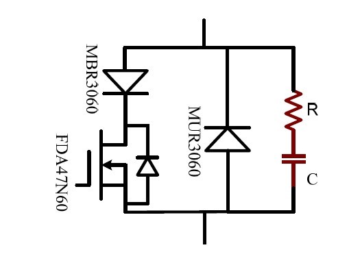

The body diode of Mosfets can be bypassed by an external SB diode and a FR diode. I have used this method to prevent the reverse recovery surge of the mosfet body diode.
That's the traditional approach of switch mode power electronics - and yes it works great also in class D amps (right now listening to such a design ;) ).
But you suddenly need six power devices instead of two.
When looking to the MosFet technology of the year 2013 this complexity is not mandatory for low power class D amps (IMHO up to +/-60V rails).
Up to this levels you can get MosFets with acceptable body diodes.
For the +/-40V region of this thread here, it is easy to find 100V-MosFets with suitable body diodes.
to bodydiode or not to bodydiode
Thanks for the input.
Yes, the internal diode can by "bypassed" with two external diodes. But it takes a pretty serious diode capable of the full output-current and it will lead to even longer supply-paths, more inductance and a loss in the series diode. The external parallel-diode can be somewhat smaller (from what I've read) and will not interfere as much with the critical paths around the output nodes.
If I chose the two-diode solution everything would get bigger and far more complicated. This is meant to be a learning experience and not a KW-amp ready for install. - ChokoHolic is so far ahead in that race, and I doubt we'll see a more serious design here. -not from me anyways.
It's a compromise with: distortion, efficiency, power, simplicity and EMC. You can pick two. Maybe three and four, but not five. I'm going for simplicity and and hopefully a design that will encourage others to build, test and share knowledge in this field. If it turns out to be a efficient, nice-sounding, noise-free amp, that's just a bonus.

I am not suggesting this circuit should be used. It doesnt fit in with the scene.
But not so sure whether the power efficiency will be lower using this kind of circuit.
Although the two diodes will cause much conduction loss,the switching loss would be smaller thanks to shorter switching time and milder reverse recovery loss, which is quite important in high frequency application.
Anyway, I havent done any serious loss calculation.
hi yuanhao,
...we are on the same page :)
The overall efficiency with music program is hard to predict, because the music program is unknown.
I went through the loss calculation for my last design (1kW into 2R unbridged / 2kW into 4R bridged, rails +/-82V) and for this calculation I concentrated on the worst case. Max output current (50...60A) close to shut down and at the same time max switching frequency - around 300..350kHz. Even with top quality MosFets like IRFP4668 this load situation causes losses which the MosFet cannot handle over long times (few ms).
....so I agreed to go for the more complex circuit, in contrast to my original intention of keeping it more simple.

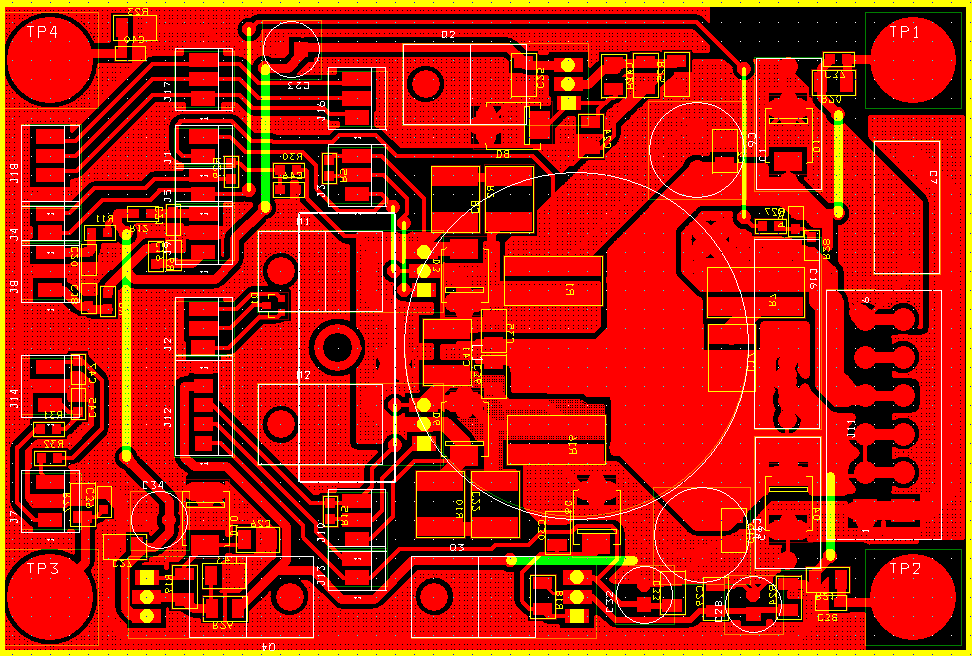

New layout
I've tried to move the two mosfets closer together and that prompted other changes and now most components and tracks have moved (although changes might appear small).
The discrete regulator for drive-supply can be placed on the top-layer or on the bottom depending on actual heat-dissapation.
Grounding is an experiment and perhaps not a clever one at that."Digital"power-GND is a single large plane under output-coil that connects all power-components. Analog ground is a separate plane with only one connection to power-GND. A small separate GND-plane is located above mosfets. The latter should maybe connect to VSS, but thats easily changed.
Any comments?
TroelsM
Nice work :)
last PCB picture too small to really see where what is placed.
D1 and D4 ... are these really necessary?
I would recommend placing C1 and C9 as close to the fets as possible (ceramics right?) .... but this is probably what you have already done
C2 and C10 could/should probably be skipped (or they need to have different physical size ... with the 47n closest to the fet and the 2u2 right after)
What are your thinking behind the R||C from mounting holes to GND ... thought you should only have one single point connected from chasis to GND ... and have that close to main GND at the PSU ...
Thinking whether the many 22 ohm / 47nF /22 ohm filterswill really be efficient .... corner freq of 154 kHz .... but overall good idea to limit too much high freq in getting back to the modulator I think
Think in my next design I'll include larger beads for Vcc and Vss input, and snubber across Vcc/GND, Vss/GND .....
The GND planes .... yes that's a good question .... :)
Have been doing a little simulation on filtering the feedback signals (like in the abowe design with 22ohm+47nF. I had actually done this some time ago, as I was thinking on the same lies that it would probably be a good idea to limit the bandwidth, both to limit the high freq input to the op-amps, and in the hope this could also lower the noise level.
Anyway as I also found the first time; any kind of filtering seem to increase the distortion.
I still think it might be a good ide at limit the bandwidth but I think the corner freq should then be at e.g. 1 MHz or higher, not to destroy otherwise good destortion figures ;)
