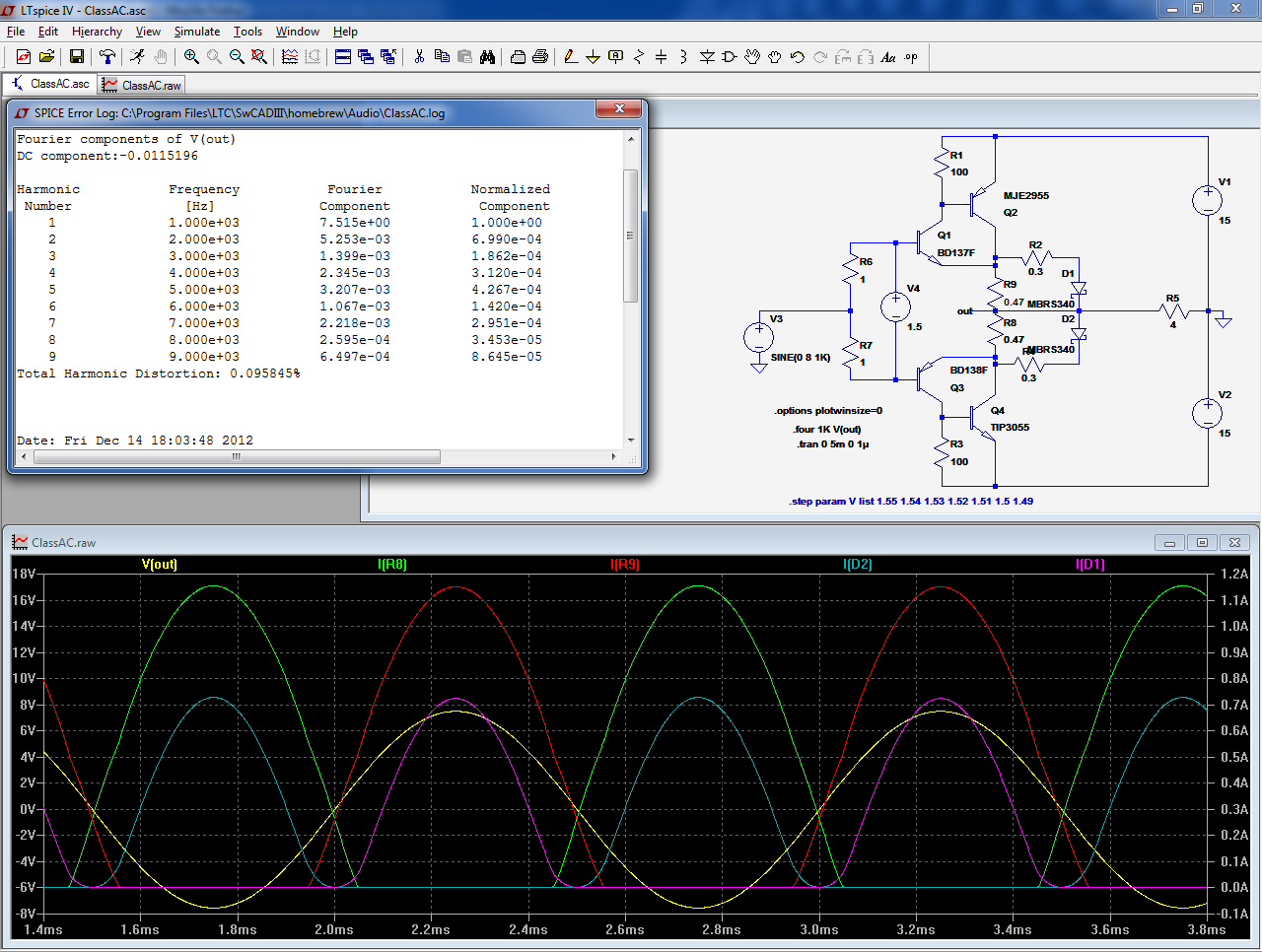

BTW, Mismatch (in particular 'controlled mismatch') is not as bad as one might think. It might even lower the distortion. Think of multi-tanh or similar circuits.
E.
Very smart: changing a problem into a feature, I love it.
I personally couldn't rely on chance alone, Murphy would make that impossible, but a nice hand-picked spread could certainly help smooth out and straighten the transfer curve.
Here is class AC for comparison: it offers a no-compromise wide class A region, but without the penalty of an increased THD when that range is exceeded.
It strikes me that it can be likened to Edmond's idea of statistical spreading, but discretized down to two elements.
The same principle could be applied to a larger number of devices pairs of suitable Is, and fitted with corresponding series resistors.
This example uses schottky diodes to minimize the class A quiescent (even with this trick, it is still 0.7A, quite a "hot" class).

Hi Guys
Self made a comment regarding keeping the idle current the same and having more devices in parallel inasmuch as the current variations through each device are reduced, thus reducing the distortion contributions individually and in total. There is no specific mention of increasing Re but that would be implied.
His conclusion is that crossover-related distortions are greatly reduced, especially when sustained-beta devices are used, making the method of simply adding output pairs one which potentially allows these specific distortions to be reduced to arbitrarily low levels. This seems to contradict Leech's assertion that THD will stay the same by adding pairs but keeping Iq constant.
Of course, the point of class-i is to allow a similar reduction of crossover artifacts without resorting to infinite expansion of the output stage and its heat sink.
