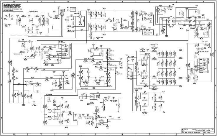

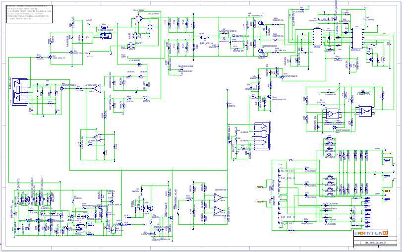

I think he's fully aware of what he's attaching.
Now that his bluff has been uncovered, he's trying to dissipate the heat by planting confusion.
The above posts are not meant to provide an understanding -- just to throw up some chaff.
The schematics attached, clearly show that the Alab design is inferior to the originals.
HI Workhorse
Pls. show sch. for labgrupen
TD-TECH Series by alab we use Bash audio technology
this link http://www.bashaudio.com/images/stabp01.pdf

He does not seem to understand English properly, otherwise he would notice that we are fully aware of the scam
Also, that thing called DDX is just class BD. It's ideally suited for battery powered boom-boxes and the alike because it certainly extends battery life a bit. However, that modulation scheme produces the highest distortion, quantization, noise and EMI for the smallest audio signals and improves gradually as signal amplitude increases, while conventional class D provides the best precision in the critical low signal range and only becomes worse as the output approaches clipping.

Hi Folks,
Mr. Alabpro says he doesnot "COPY" but uses "SAME" Technology....Then what this term should be called.....
The Front panel View of Alabpro and LABGruppen Amps are very much the same....
, even the heatsinks and PCB layout are also same....
He doesnot copy but uses same technology....
