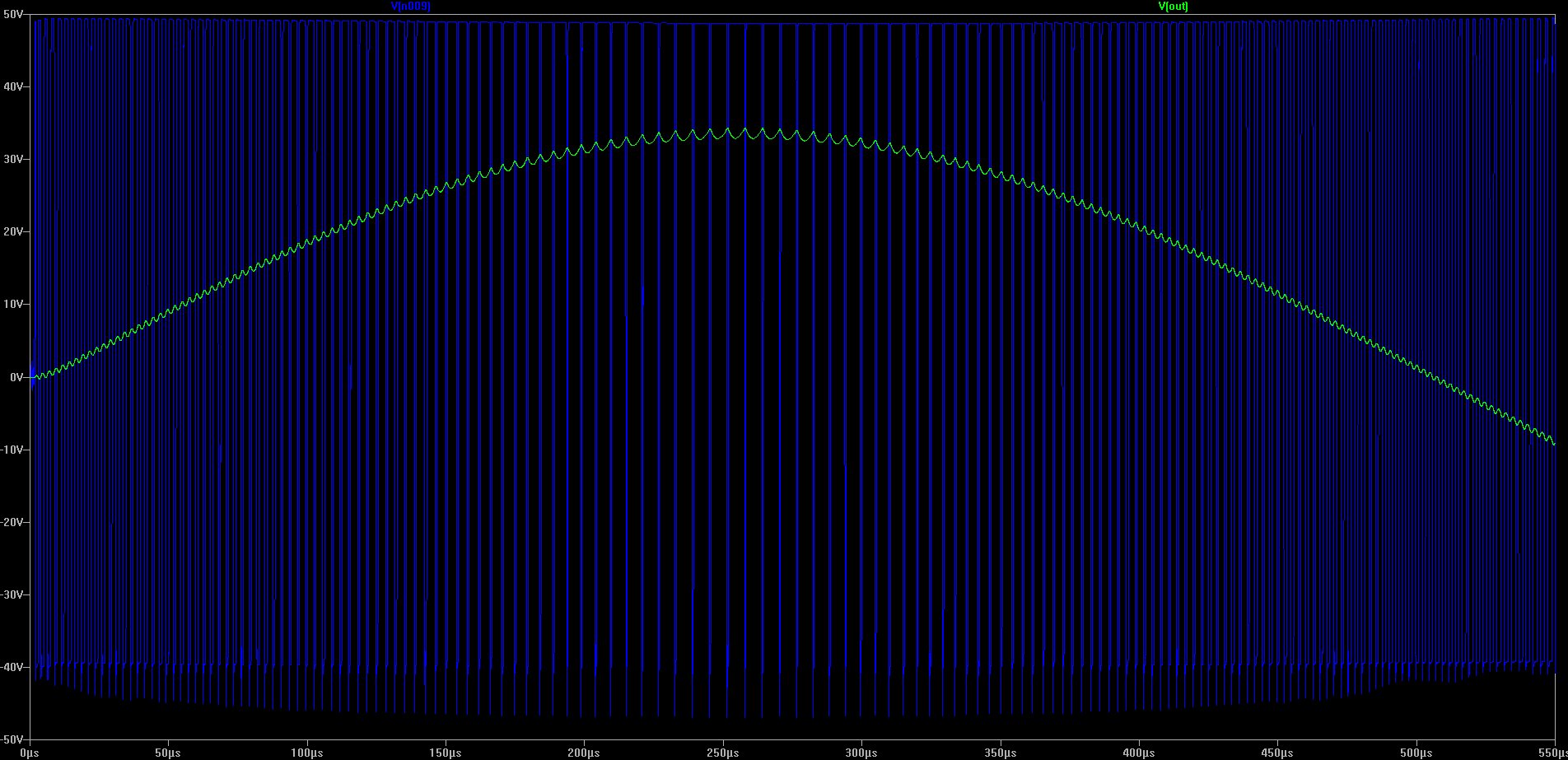

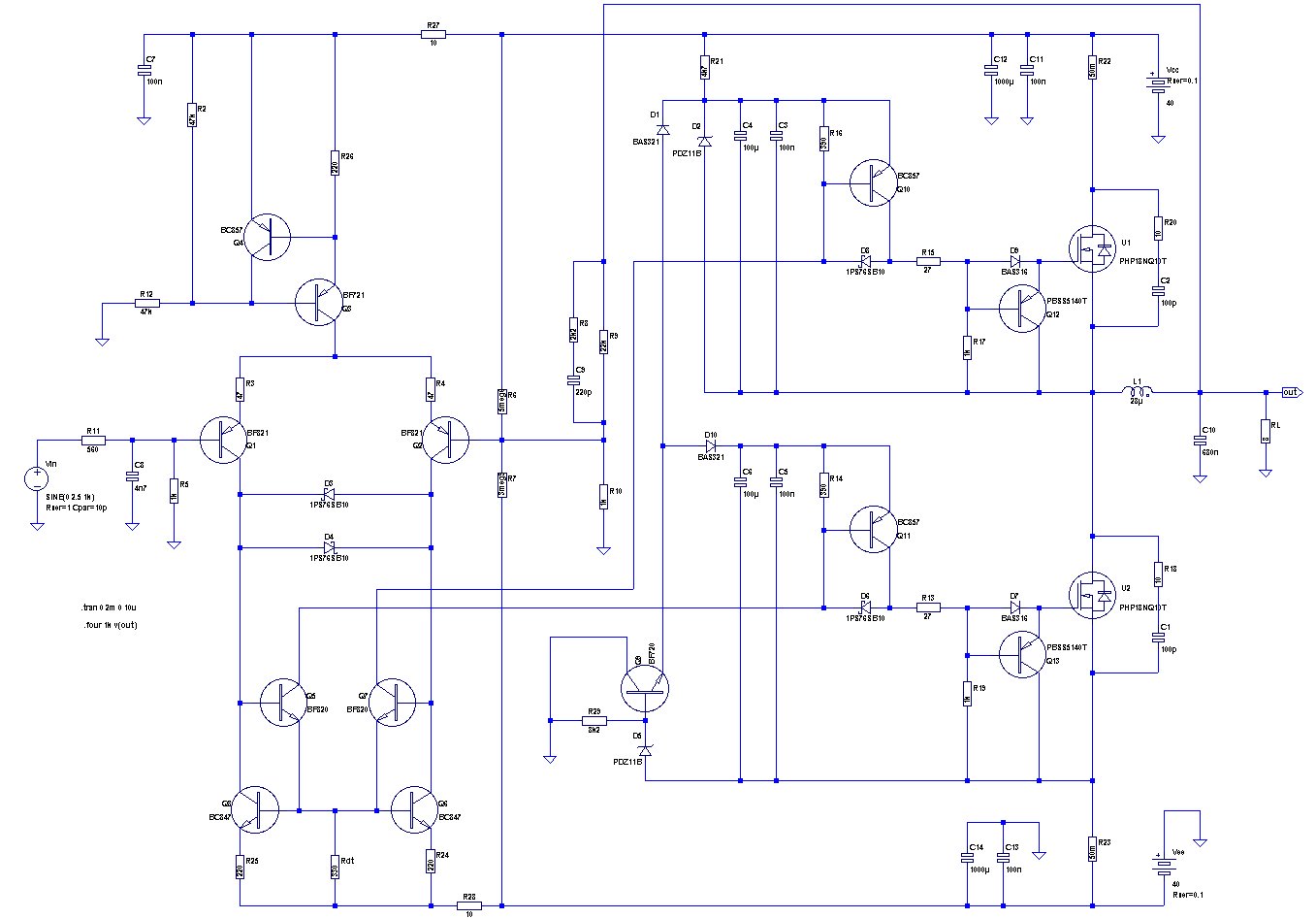

The UM10155 circuit does have that he advantage that it can be simulated easily. Once you have put together all the SPICE models and symbols, that is. You can then look at voltages and currents to your heart's content. With everything being discrete components it's all out there.
Here are a couple of pics of my efforts in LTspice. The waveforms shown are the output and the output MOSFET gate drive. Sorry about the lack of detail but I can't make the pictures any bigger!
If there is any interest, I can post all the files needed to make the simulation work.
