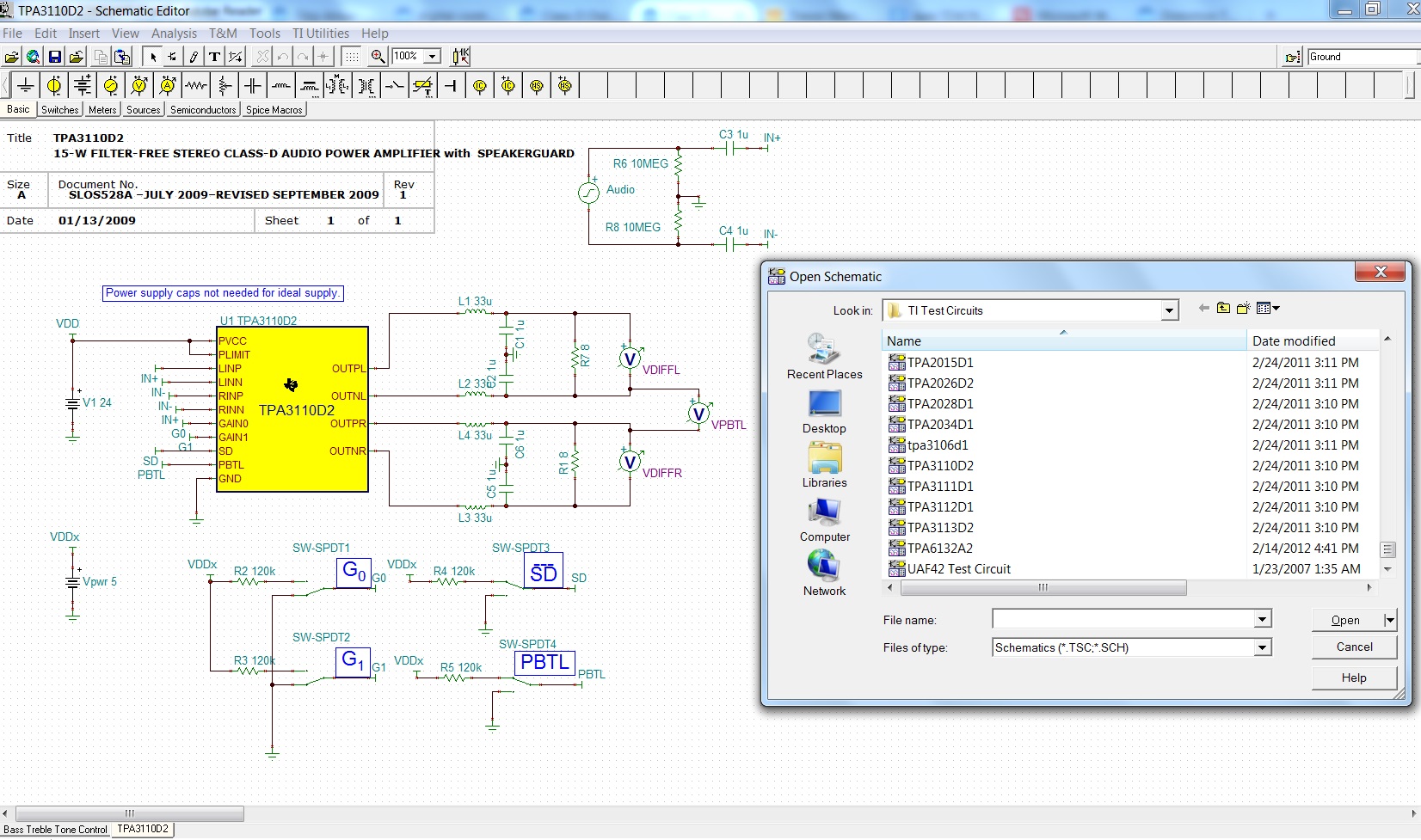

Download the free (cut-down) version of TINA spice from the Texas Instruments web site, which will allow you to plot the FR and transient analysis of your output filter...
You can do more than that!
:magnify:
in the TI test circuit folder! (Doesn't have the 7498 but does have and 311x)

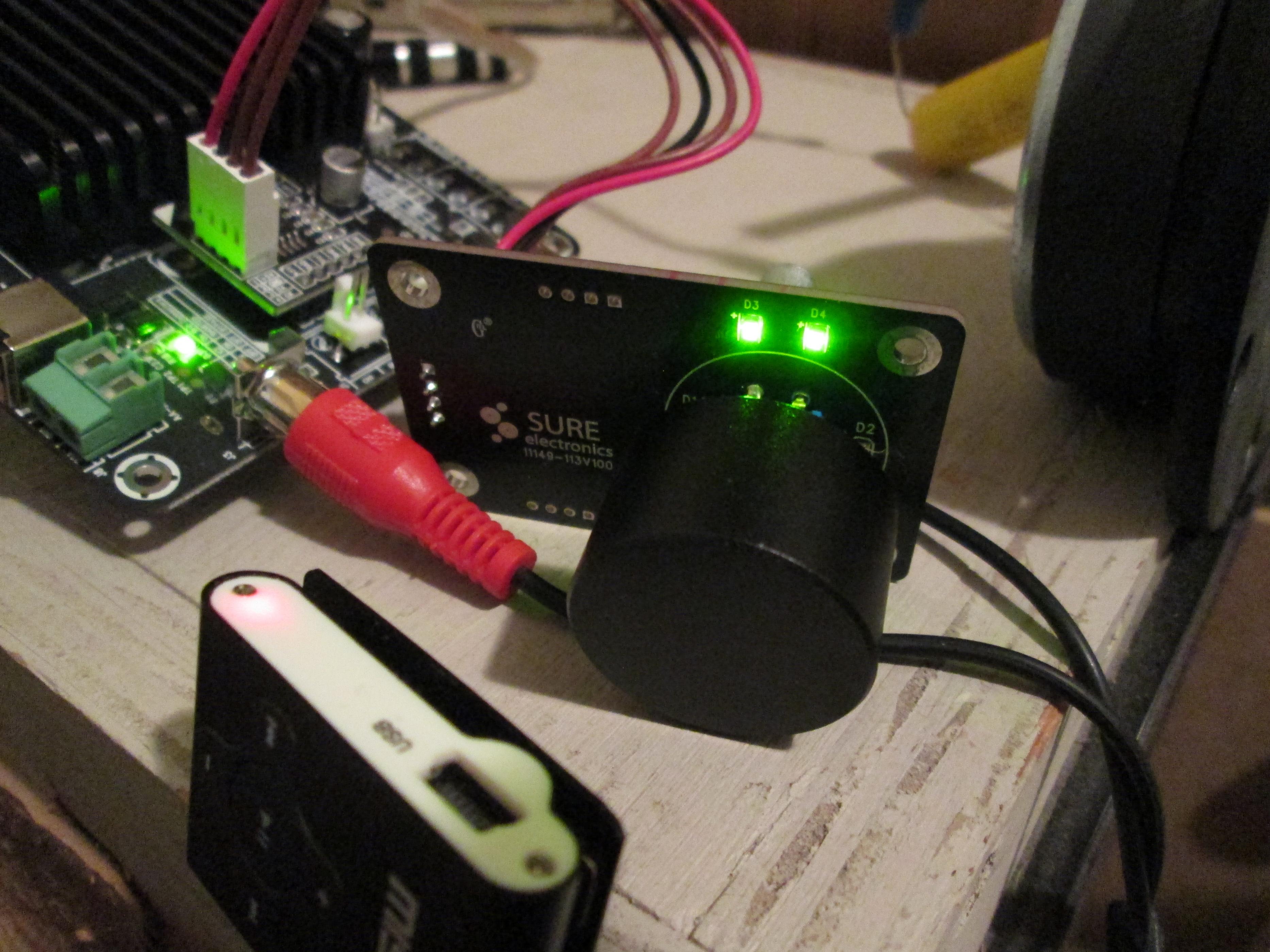

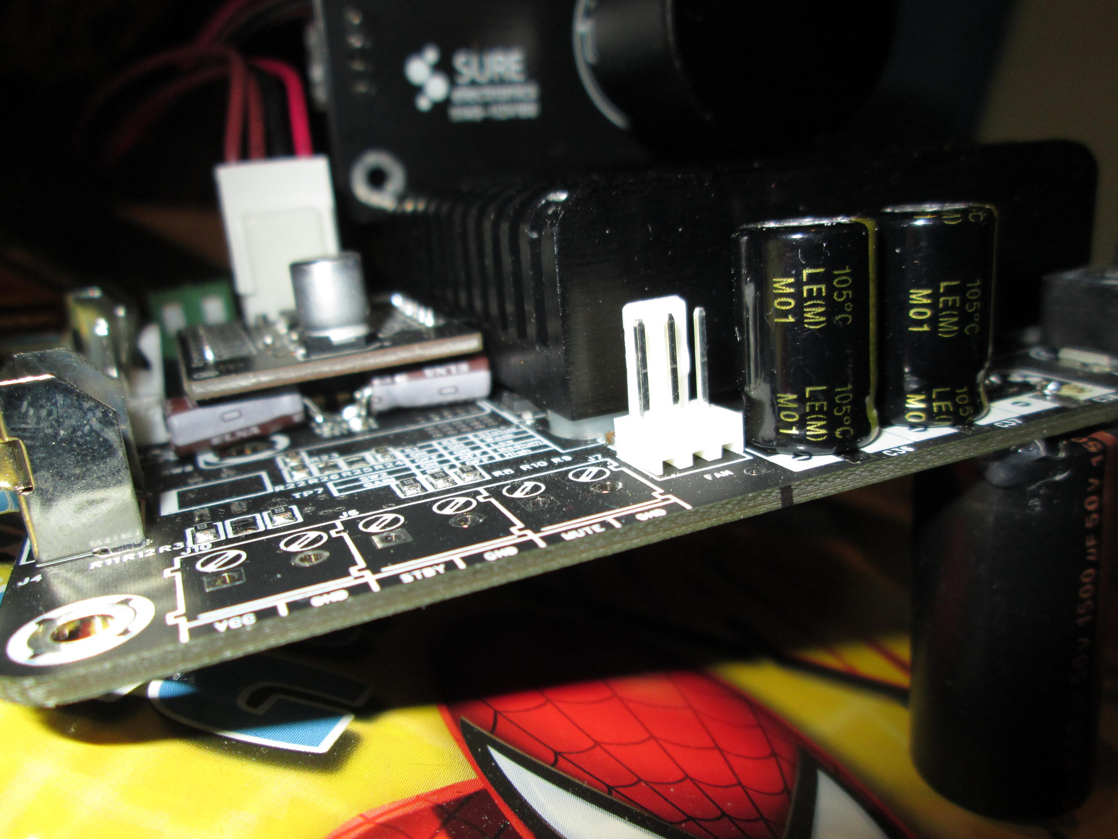

The Sure AB32189 / AB32174 / AB34165 manual doesn't have much:
http://www.parts-express.com/pedocs/manuals/320-303-parts-express-manual.pdf
Hey ... I just remembered I have one of these! :eek:
Upgrade with silmicII 2uf input caps; 1500uf, 50V on each ps side and the SURE vol control.
