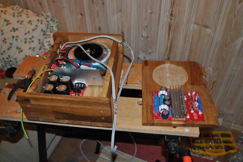

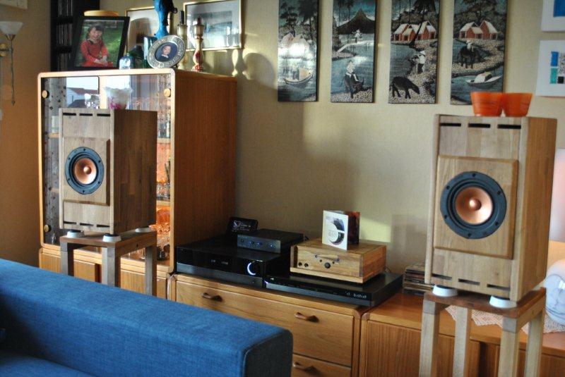

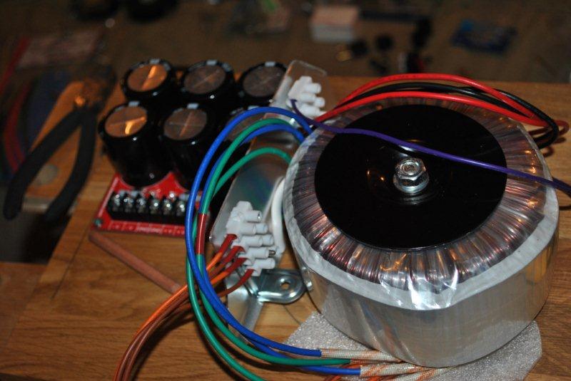

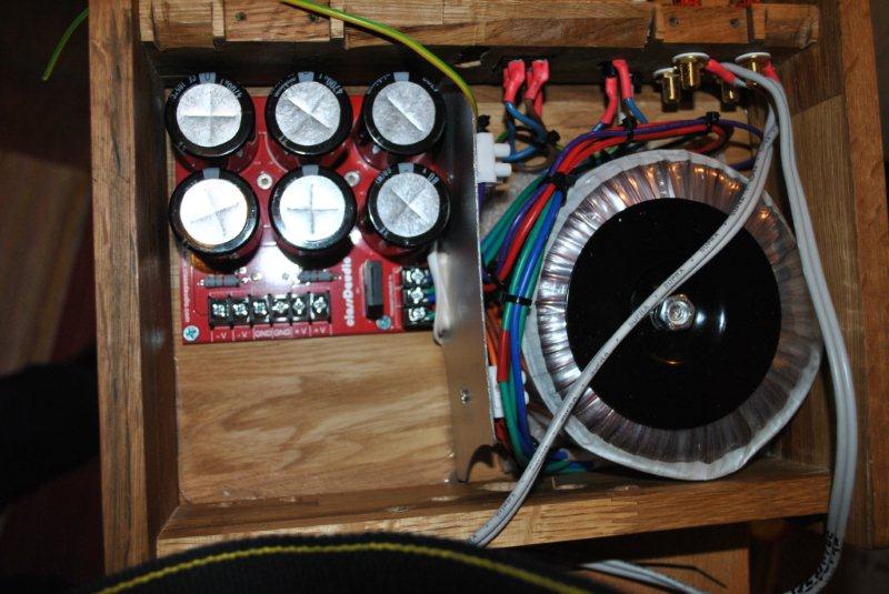

Hi there all!
This is my first go in the amp-building appartment! A SDS254Kit. It is just running its first go with some music this week - and 1 impression is - that it is just as good as my 2 year old HK980 - if not even more revealing. A little weak in the bass, but will change the electrolytic caps to some better/bigger later - in a box that is more accepting for this! A very good soundstage with my Alpair10.2 when I use the pre-amp in the Harman. Even straight from the Touch with some 24/96 music from BowersWilkins Music Club is very good(need some better DA-converter than my old DagMagic to fully unlock this possibility.
Next step - build a Nelson B1 Passive Buffer(some additional tricks from some of you guy out there as help for this build?).
And after that a F4-F5 amp - maybe? And maybe an Alpair12.2 MAOP? If time and Spirit allows!!
Building has never been so fun since I build an Hafler Pre-amp and a Sentec Power-amp in the 80s!
Best to all
Olav
