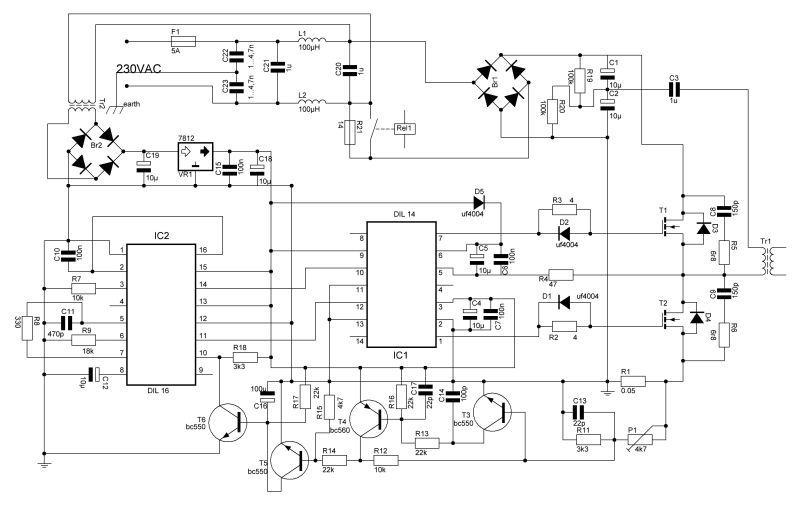

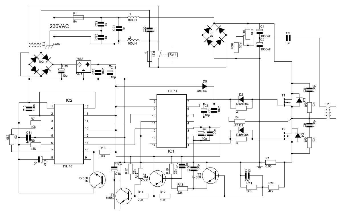

Hi Mr. Mile, is this correct? I am interested about protection circuit, could you explain it? Sorry for messy lines, first time drawing schematics with software.
Protection circuit use 0,05R with IGBT start at 25A (4000VA), use 0,1R with MOSFETs.
What about changing R10 to 2k for FETs and keep 0.05R for power dissipation reasons?
It's ok.
