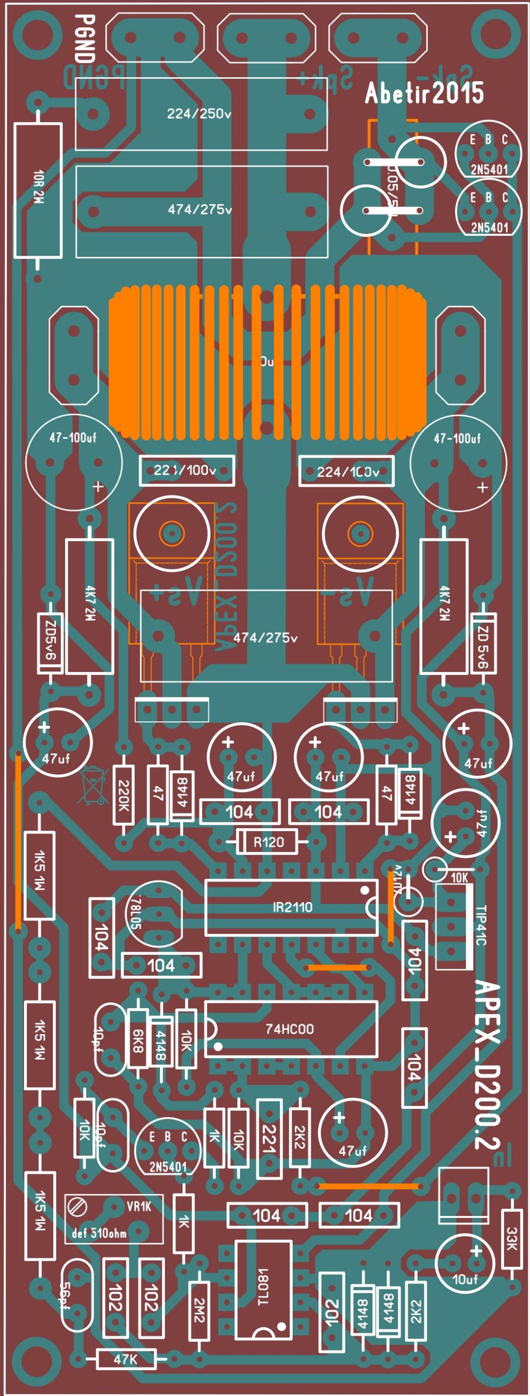

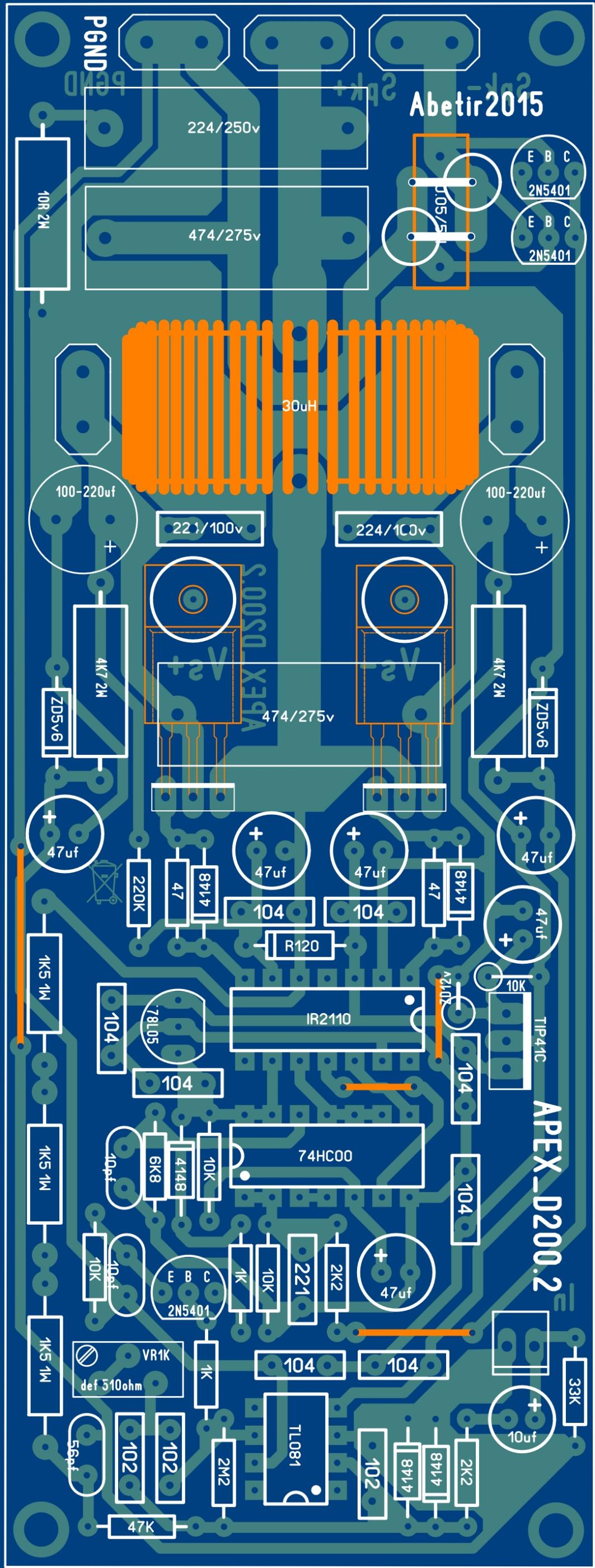

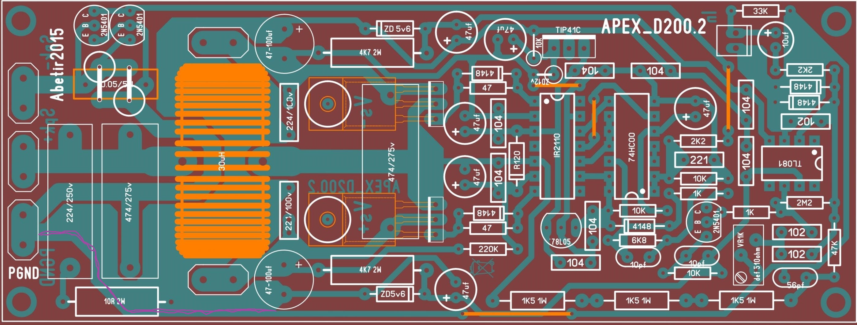

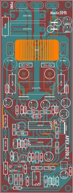

I do think this one is much better, I was so eager to try this lay-out but I am currently living in a place where Laserjet printer is so elusive and if you can find one, shop attendant refuses to use glossy paper. and I don't own one
I will share the lay-out, others may find it useful. PCB size is 55X145mm almost the same width as the original D200.2 pcb. If this design is a success I will integrate the XLR pre-amp.

Nice work, thank you.

Ground track corection.
Preamp can be on separate pcb with volume pot.
