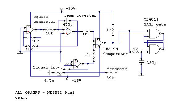

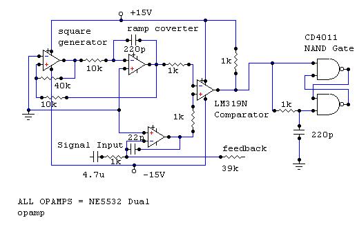

Dear Amp Man,
i'm sorry , but only one thing of the your circuit can be working - triangle generator, however at 60khz(isn't 250khz) and it have almost sinusoidal form because opamps too slow. Your feedback is positive (only regarding upper fet, lower fet is always ON and with 60khz frequency it's OFF for 300nS ), input R=1K & C=4.7U gives -11db at 10hz, however your circuit with lm3524 has much more errors. Why you write 0.01%, but not 0.0001%? Why are you stopped?
Man, just tell me - "smile, you in candid camera"
Best regards Ivan.
Best regards Ivan.
hi.
>Dear Amp Man,
i'm sorry , but only one thing of the your circuit can be working - triangle generator, however at 60khz(isn't 250khz) .........Man, just tell me - "smile, you in candid camera">
hehe , i have suggested before to amp_man (or should i say amp_men....?) to build at least one of the amps before talking so much about how good it is
btw. some time ago you said you never heard about factor and his projects but the other day you said in emails it is actually your (late) brother , right?
are we all on candid camera here?
rgds karsten madsen - cadaudio.dk

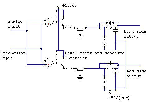

Can this proposed schematic will give out of phase drive signal correctly??. I want to implement it because LM319 is dual comparator and therefore I want to use the full IC. and also i dont want to use CMOS ICs.
Comments,Suggestions,Insults,Remarks are most welcomed.

But Sir, I have seen this type of implementation in several High-end Class-D amps.
Ampman requires more suggestions indeed.

subwo1 said:I thought that if the analog signal is triggered on two comparators that the distortion would be higher since they may not trigger at the same time.
One can deliberately provoke this in order to achieve adjustable dead-time
Regards
Charles

Ampman ThanX SIR, PHASE_ACCURATE for his INVALUABLE suggestion . So, can i implement this circuit in my New CLass-D project.
With Sincere Regards
AmpMAN
