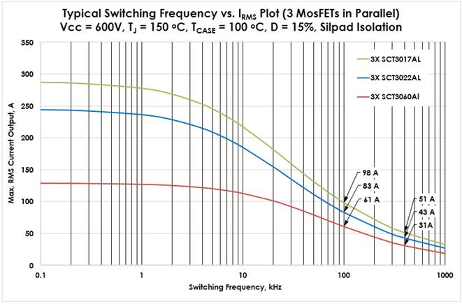

In my application and as per ROHM technical team suggestion, unipolar gate drive serves the purpose. They are recommending +18V/0V gate drive. Which I have also found to be adequate. In case if you want to have negative gate drive, it should not increase beyond -4V at any cost, otherwise traps will form in the die and impact the reliability.
Whereas the real issue with CREE and ROHM SIC is as follows:
1. The Rthjc junction to case is very high when compared to other same package mosfets/Igbts. For example Rohm SCT3060AL specifies Rthjc as 0.91C/W vs 0.27C/W of IXGH100N30C3 IGBT.
This severely hampers the operation at high frequencies >250khz at higher currents >25A.
As per CREE and ROHM, they are Trench SIC mosfets whose DIE area is smaller as compared to other mosfets and hence higher Rthjc and higher RDS ON [compared with equivalent VCES drop of IGBT]
Hence the Fmax2 limit suffers severely, even if you have lower Total switching loss.
2. The Body Diode drop is very high 3-4V, which means you have high voltage drop during third quadrant switching or during deadtime. To keep this low, one has to keep the deadtime low or have to use external high voltage schottky barrier diode to keep the dissipation at minimum by bypassing the internal body diode voltage drop, though RDS based current path shunting does help but not much.. Again this conduction loss of diode increases the case temperature and further creates reliability problems.
IMHO these SIC mosfets are more suitable for use at high rail voltages , low current and lower frequencies.:D
See the attached graph based on data provided by ROHM itself.

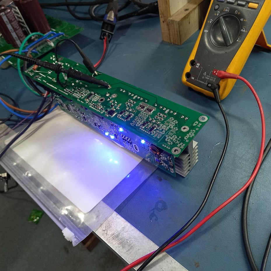

What you have to say now in the case of SIC ??
I guess times have changed, SIC is the present as of now :wave2:
