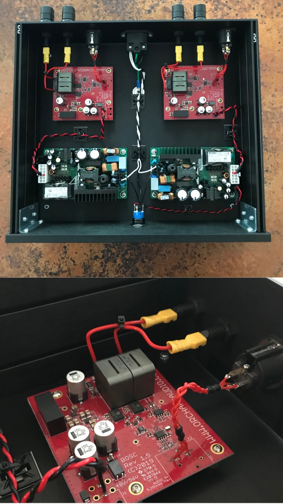

Heres my TPA3251 based design with PCM5102A dacs and boost converter for diy bluetooth boombox. Should be extreme enough
looks nice. All done by yours?
Yeah i made this from ground up because i couldn't find this kind of board for sale. I wanted to maximize efficiency by utilizing tracking power supply meaning that the rail voltage is controlled by the dsp. This end up working well and reduces losses greatly at low levels with no audible side effects because i can delay the audio with dsp so there´s always enough voltage for the amplifier.

No, it's because I had it in stock. I had purchased a few of those boards a while back and I am putting it to good use. Moreover the Neurochrome SMPS-86 (discontinued) has:
*Integrated Softstart (once the output voltage of the power supply has reached 75% of the nominal output voltage, a relay trips and shorts out the thermistor. This allows the thermistor to cool, allowing the soft-start to work even during a short power outage).
*Surge capacity to 320J.
*Pi filter on output so AC ripple is 5.6mv RMS (measured).
*50mohms output impedance
In addition it has all the positive attributes of a MeanWell supply, i.e. less than 1% regulation, built in mains filters, galvanic isolation from input to output, the ability to handle a wide set of worldwide voltages on the primary, overload protection, overcurrent protection, etc...
Most SMPS supplies have a ton of ripple on the output, like 100-300mV RMS. This supply is not noisy at all. An equivalent linear supply would need very large capacitance numbers in the supply, along with a pi filter or two or capacitance multiplier circuit, along with being heavy.
That being said, it probably makes little difference since the PSRR of Leo's circuit is phenomenal and my lead lengths are very short. It's a testament to the design of the BOSC/Starkrimson circuit.

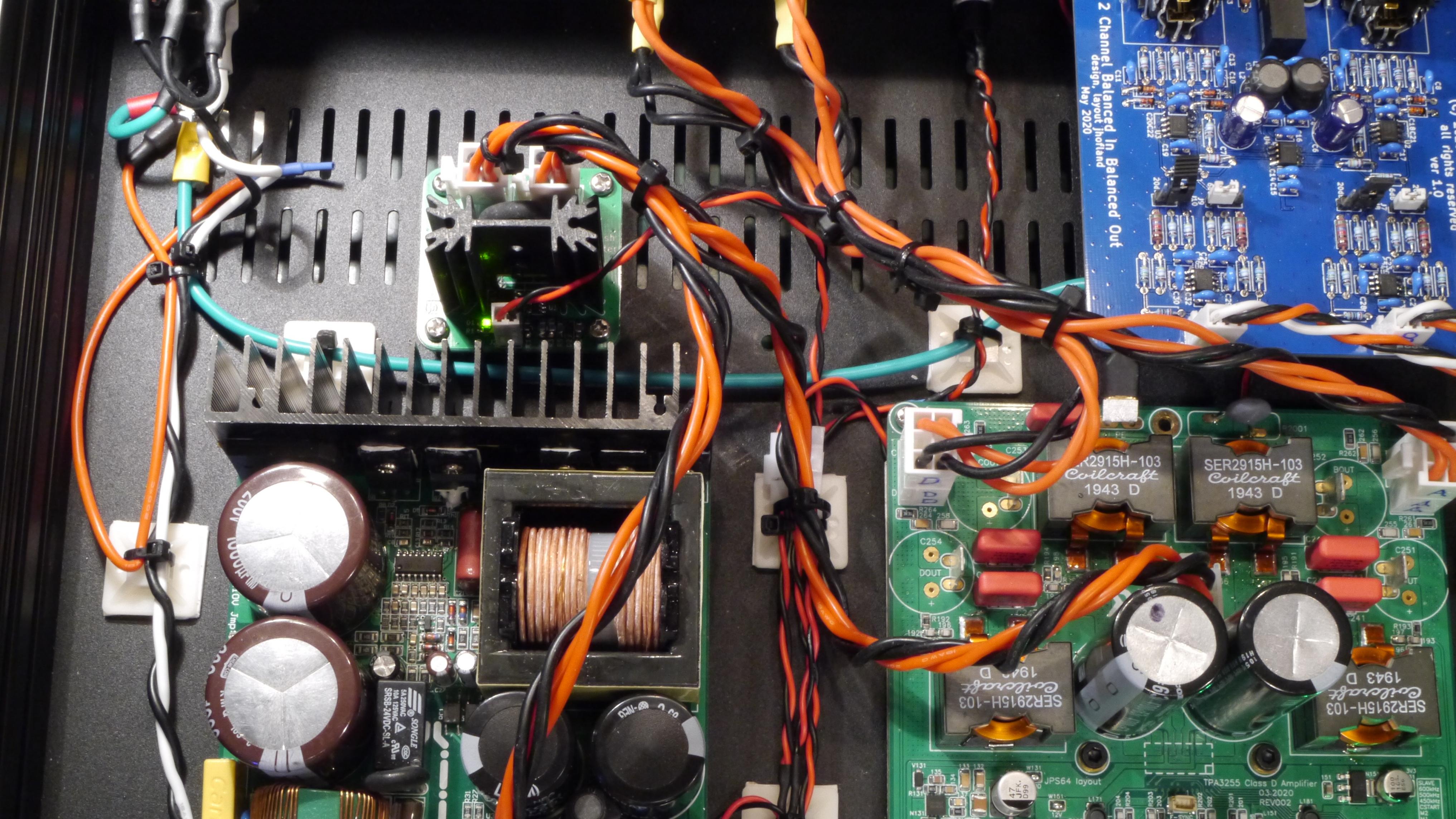

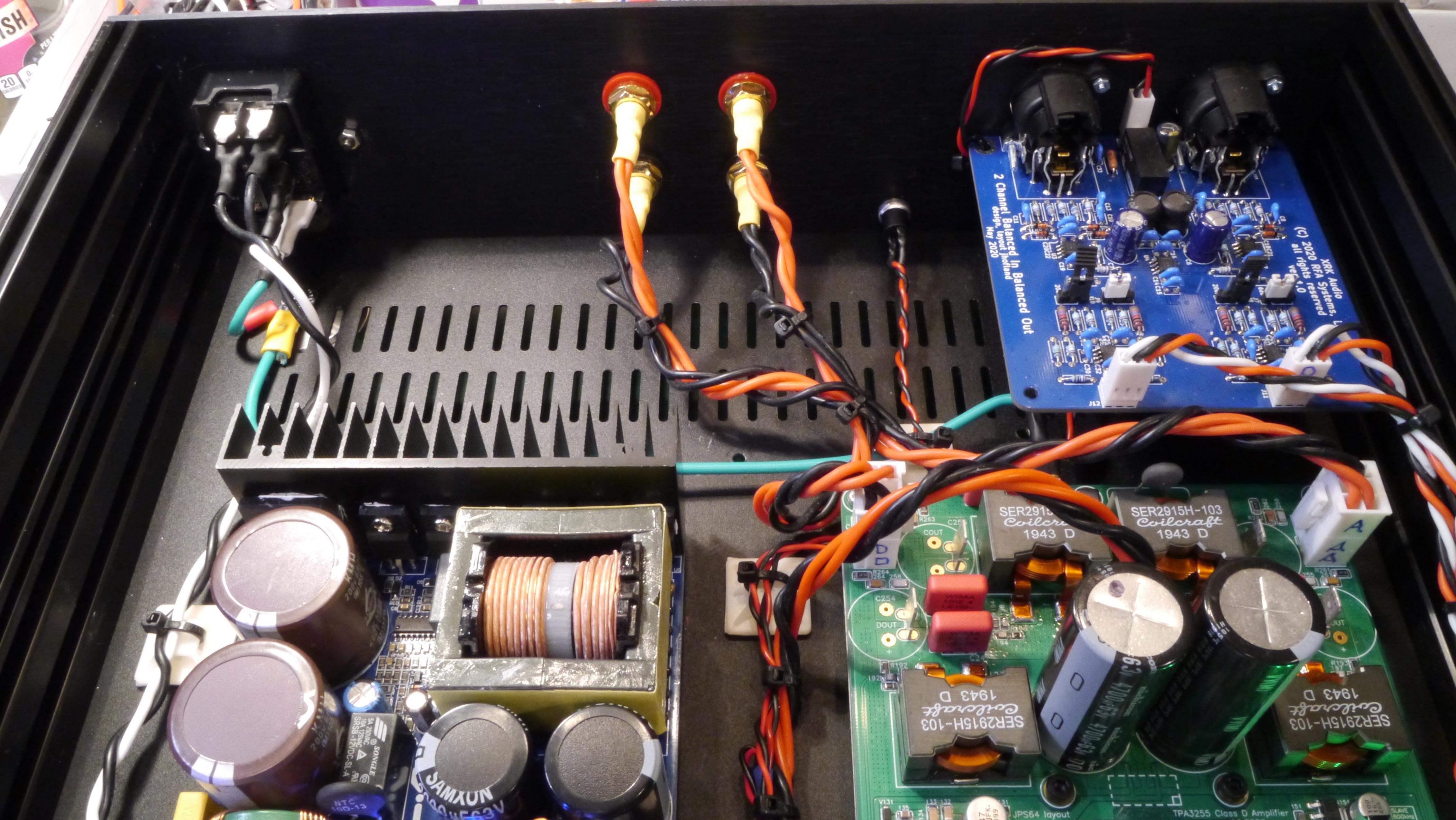

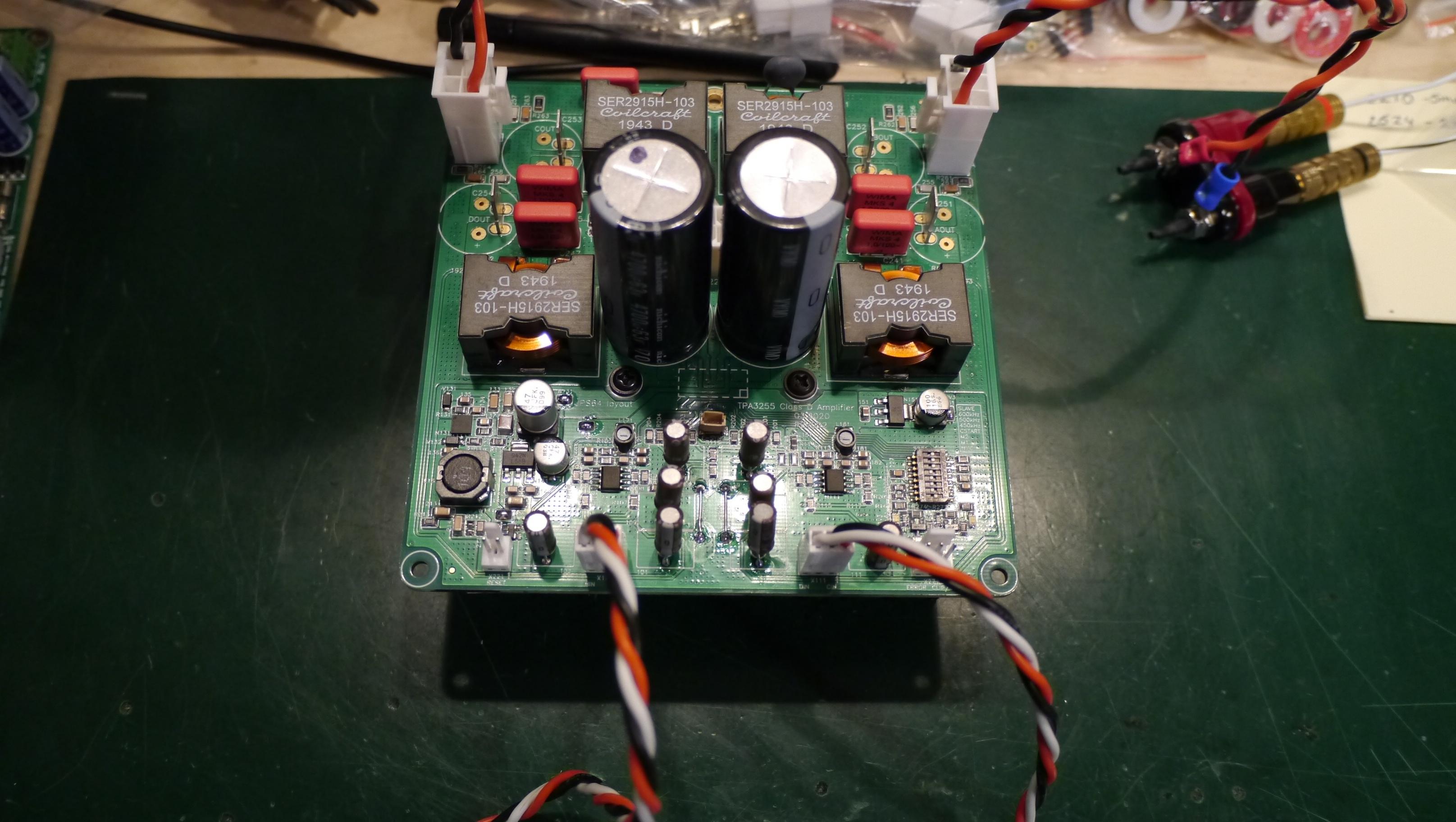

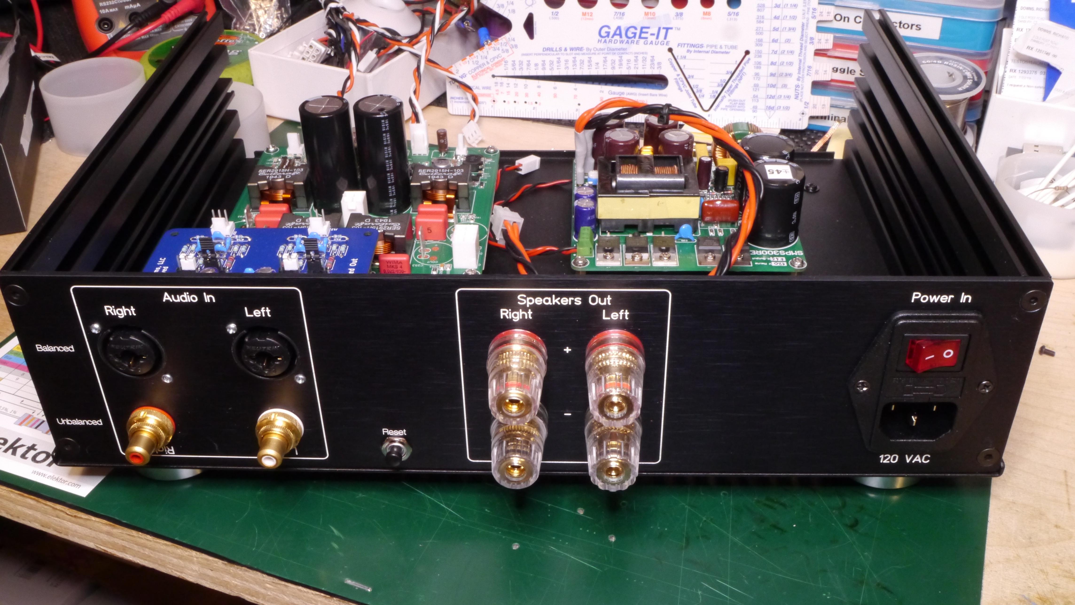

Hi all,

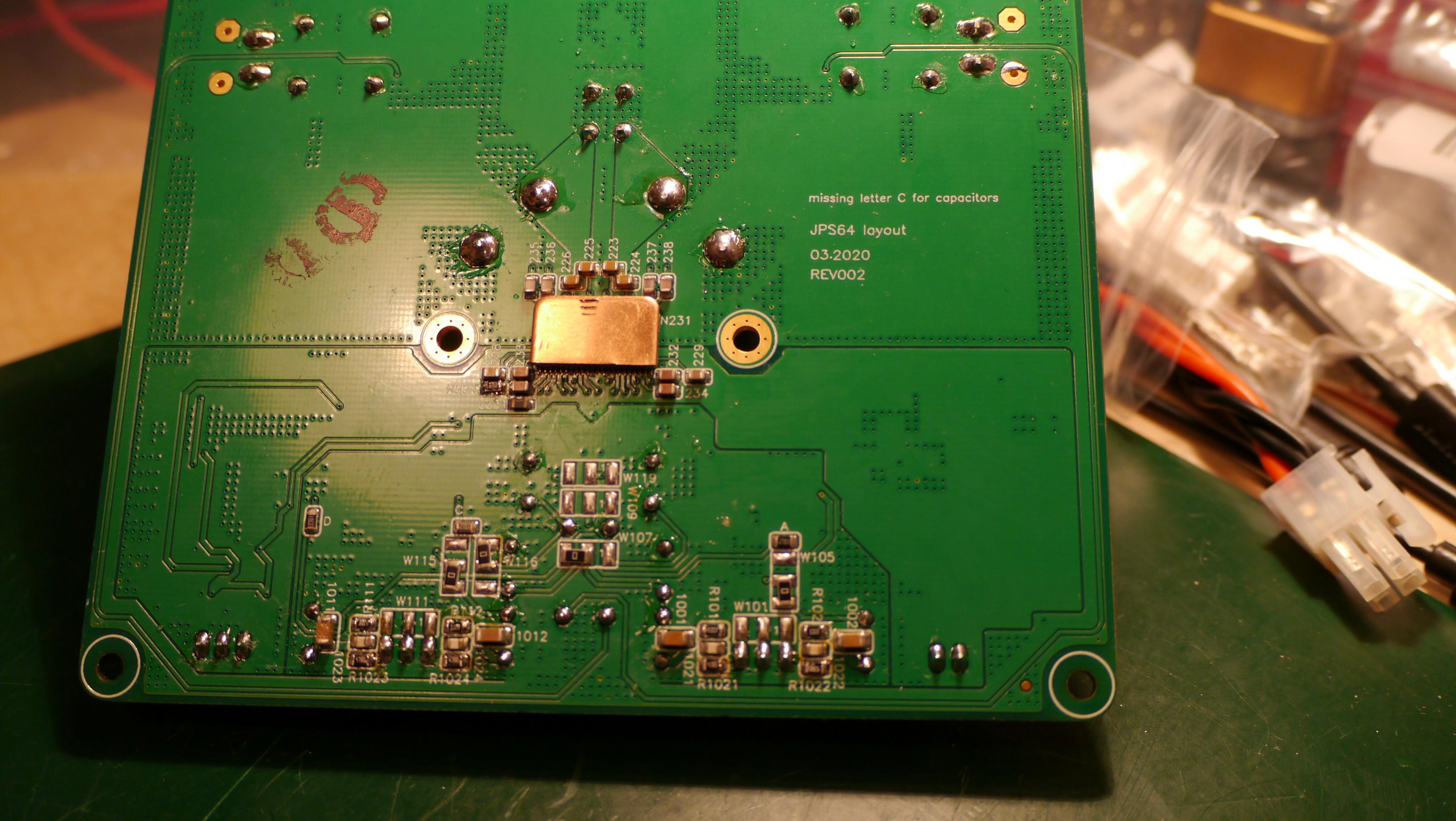

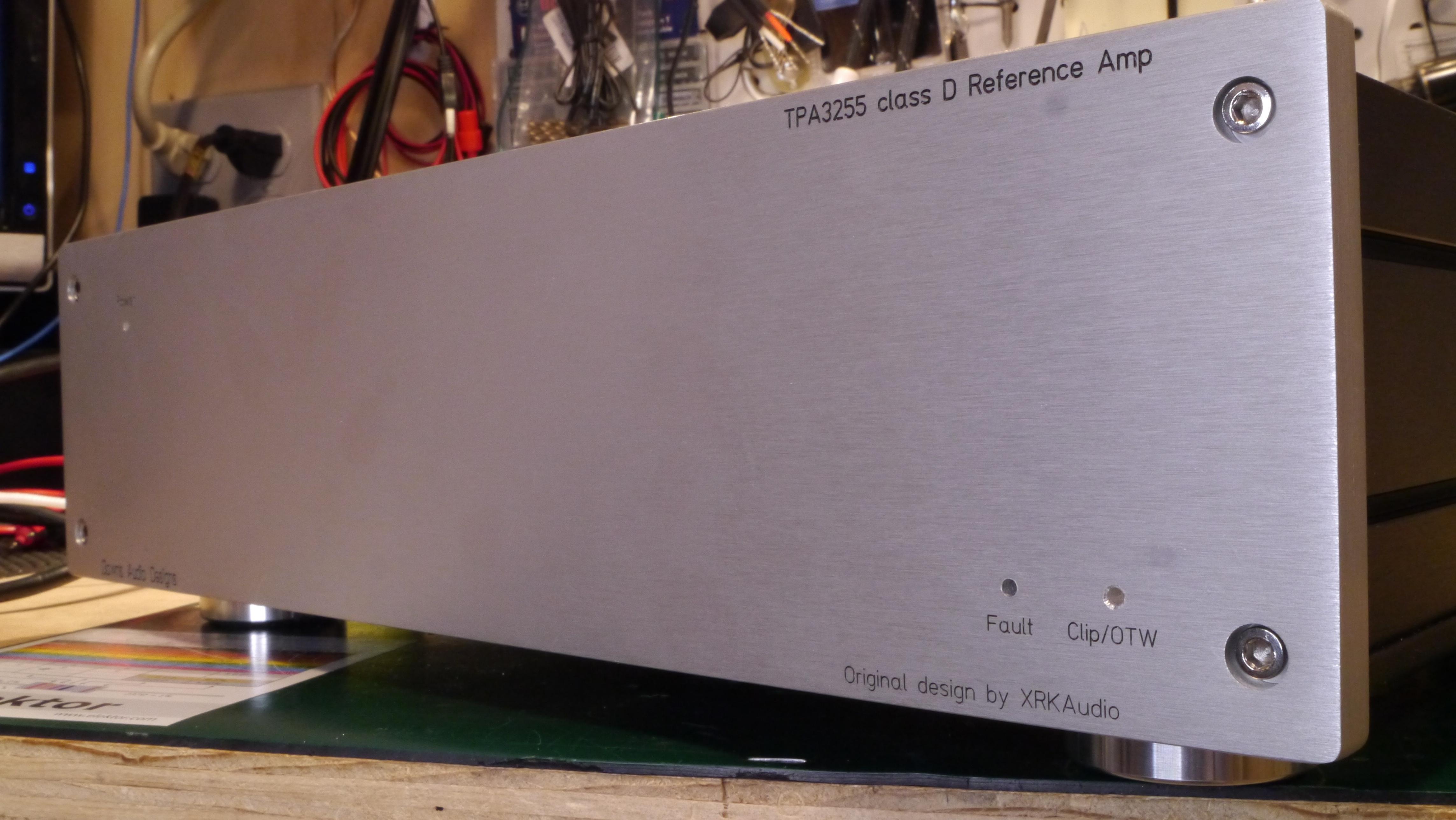

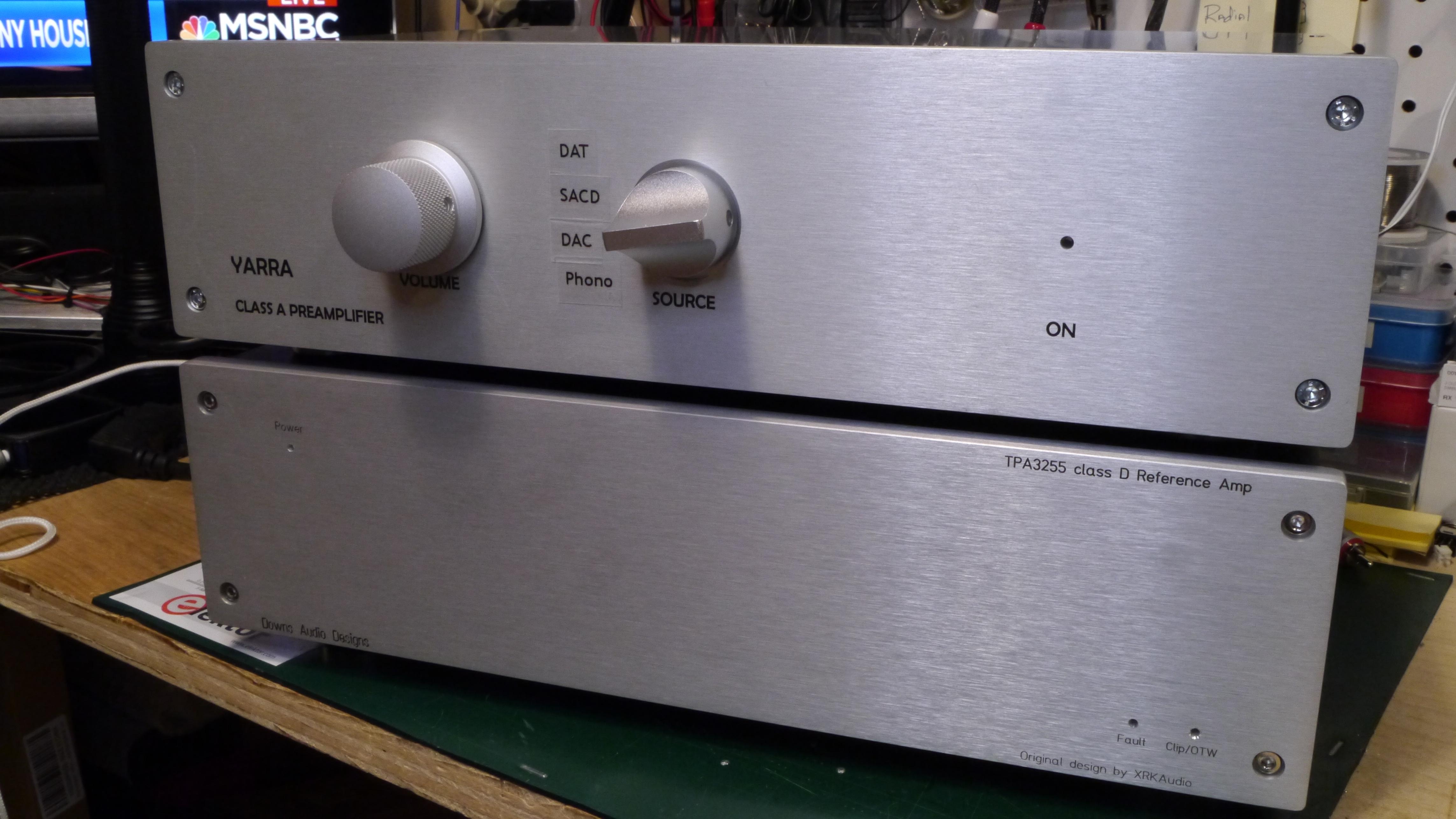

I'd like to present my latest class D amp build. At the core, this project was based on member xrk971's newest class D amp board. This board is based on the TI TPA3255 chipamp. The specifics of this amp can be found over at this link. The amp board is available as a bare PCB, or as completed PCB in his Esty store.
The Hardware --
The TPA3255 chip itself is mounted upside down on the underside of the board to make mounting to a chassis a good option. Of course, there are other options to raise the board, traditional heatsink, fan, etc. could be used for cooling as well. What worked well for me was to use a 130mm x 44mm x 6mm piece of aluminum stock, bolted to the chip via the PCB using thermal pad/tape to the bottom of the enclosure. The whole amp assembly secured with 6mm brass standoffs. Note: The heatsink MUST BE electrically isolated from the chassis.
For the PSU I used a Connex SMPS600RS. This is 48VDC single rail SMPS with available auxiliary voltage of +12V. The 12v was necessary for 2 additional boards I used in my build - explained next. I have excellent success using the Connex line of SMPS' over the years in several projects. Highly recommended.
The blue PCB shown attached to the back panel with XLR connectors in the upper right, is the SE to Balanced board since the amp operates natively in BTL (Bridge Tied Load) mode. This allows both balanced and unbalanced (RCA) input connectors. I recently upgraded my heavily modded ES90938Q2M DAC with Balanced outputs, so wanted that capability.
After testing on my bench, I found that the SMPS600 and the amp did not play nice together due to excessive amount of inrush current from the SMPS to the amp. A different kind of soft-start was required, since the SMPS already had a soft-start built-in. What was needed was an inrush current limiter circuit between the SMPS and amp. I contacted xrk971, and with his help, an inrush current limiter PCB was born. It will be offered in his Esty store in the future. The prototype I tested worked fine and I was able to complete the project build. Note: This appears to only be an issue with some models of SMPS' and the amp. So if you're building this amp, please try your intended SMPS first, as it may work fine. xrk971 confirmed it worked with a different model of SMPS from Connex he used for testing. So this simply may be a one-off obscure occurrence. In fact, it worked with a lower voltage/power SMPS I tried as well - without the inrush current limiter circuit being necessary. The Inrush Current Limiter circuit is powered by the SMSP auxiliary 12v output.
The Sound --
I have to say that I have build a number of class D amps, and by far this is the best sounding DIY solution I have found. The first thing I immediately noticed was how quiet this amp is. There is nothing but silence when it's turned on. Then when the music starts.... wow! While class D amps may have a 'bright' overall sound, in my listening to it over the past several weeks, I never found this amp harsh, or fatiguing to listen to in any way. Instead, the sound is smooth, full-bodied yet very articulate in executing the music with clarity and detail. With plenty of wonderful and warm sounding mids, and solid bass when called upon.
While I primarily listen to digital streaming from my home media server(roon), I also listen to LPs. One of the best, more recent LPs in my collection that is an absolute pleasure to listen to, is James Taylor's 'America Standard' Limited Edition, double 180gram, Audiophile 45RPM LP set. This is one of the best mastered LPs I've ever owned. All sides were click and pop free while being played back on my vintage turntable; JVC QL-7 using a Denon DL-103 MC cartridge. The cartridge is paired with a Puffin DSP phono preamp. The dynamics of this LP set were stunning, easily rivaling many digital tracks. James' voice is simply transformed in such a magical, and very easy to listen to way.
I continue to be amazed at how well this amp sounds and the technical execution of the music. And, did I say I haven't even tested a full balanced signal chain from my DAC to amp yet? Next up.

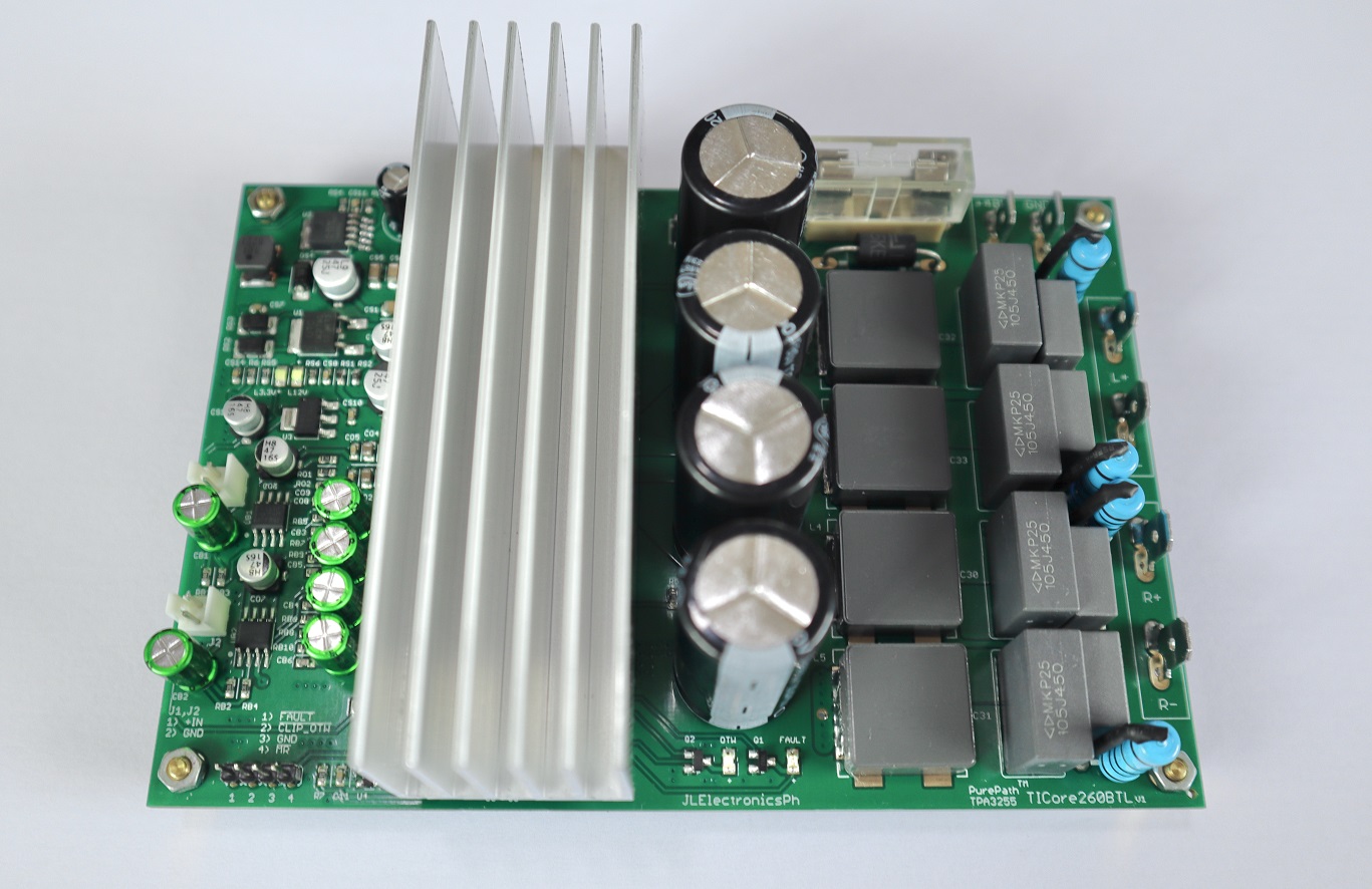

Best "chinese" board = 3E Audio or Aiyima 3251 (Tilear PCB) with OPA1656
Another alternative (but non PFFB enabled) :
jlelectronicsph on eBay
✅ Transient voltage protection (SCR + TVS + Fuse)
✅ Oversized Zobel Network
✅ Linear post regulator
✅ Voltage supervisor (no startup/shutdown pops)
✅ Nichicon muse input caps
✅ OPA1656
