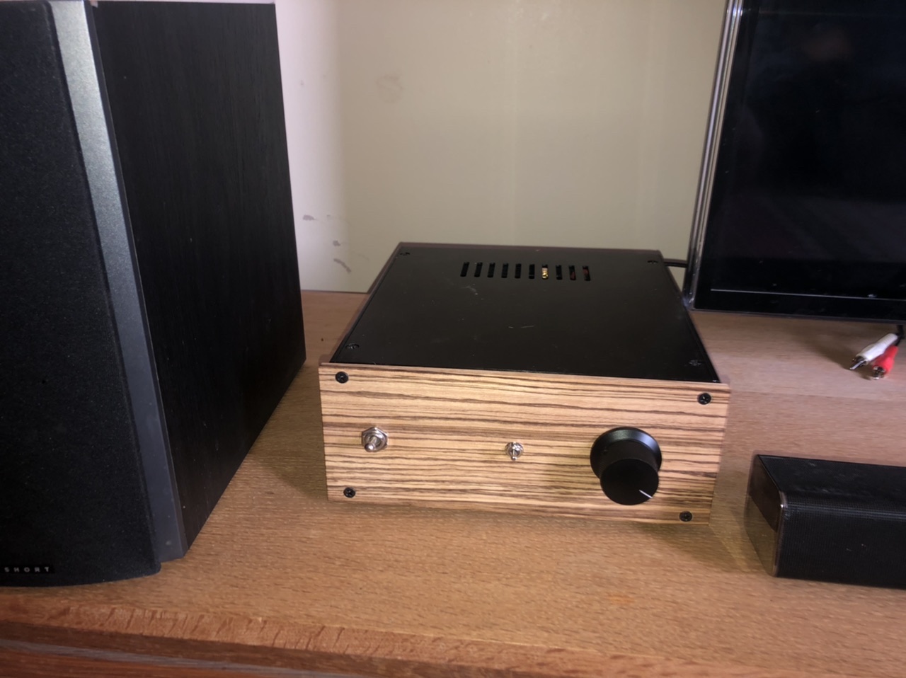

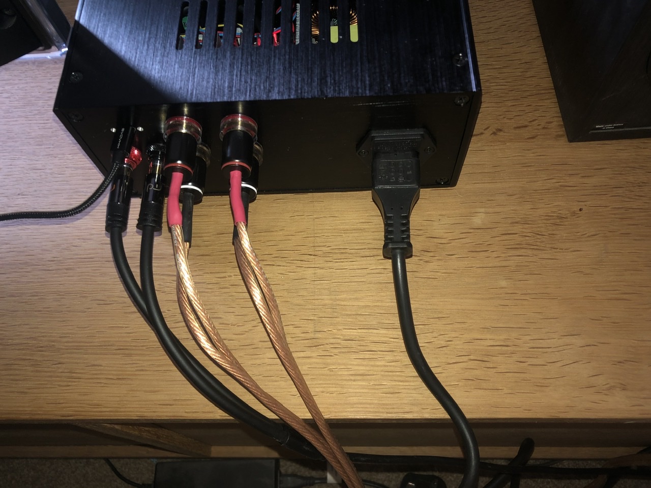

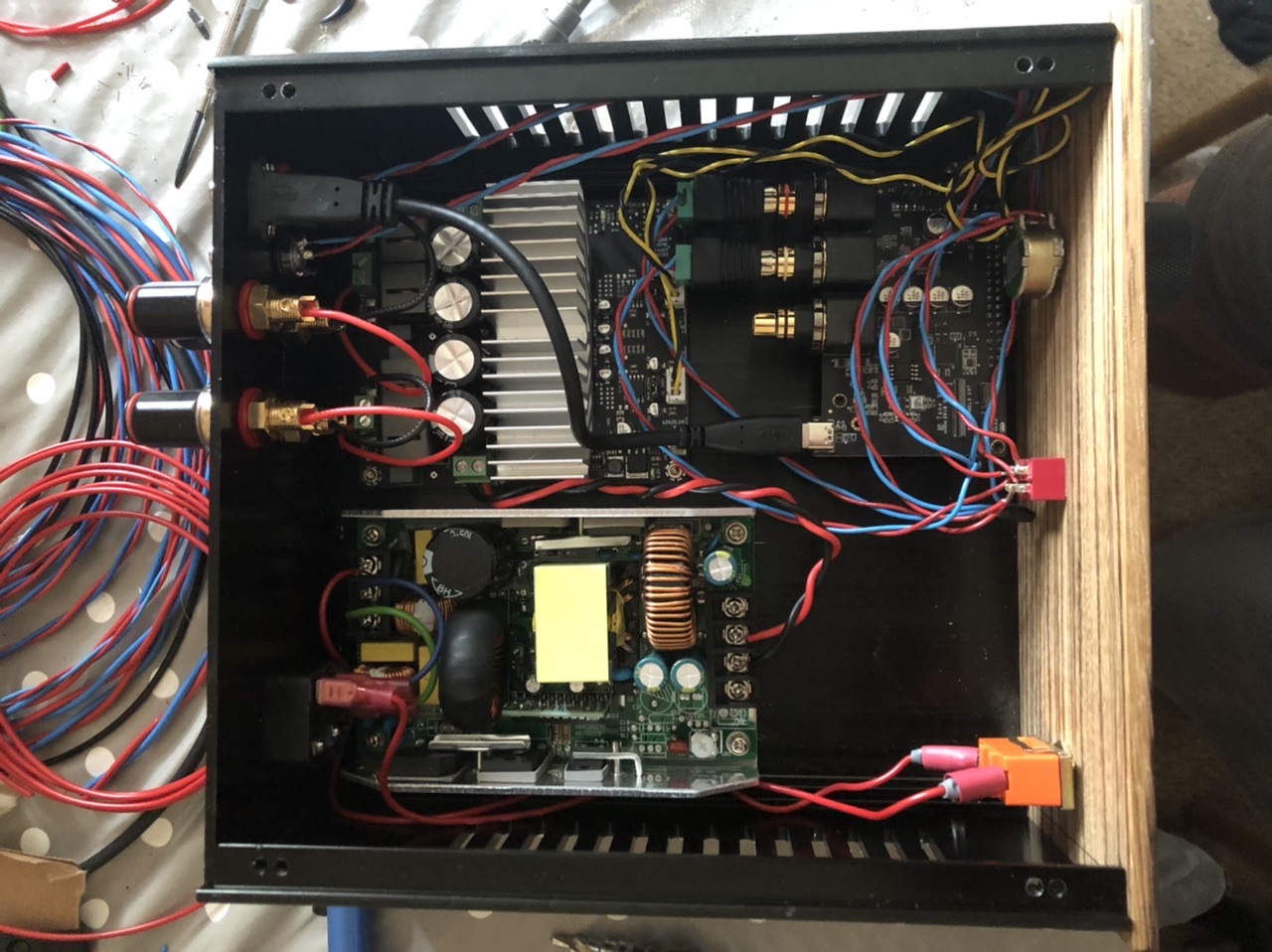

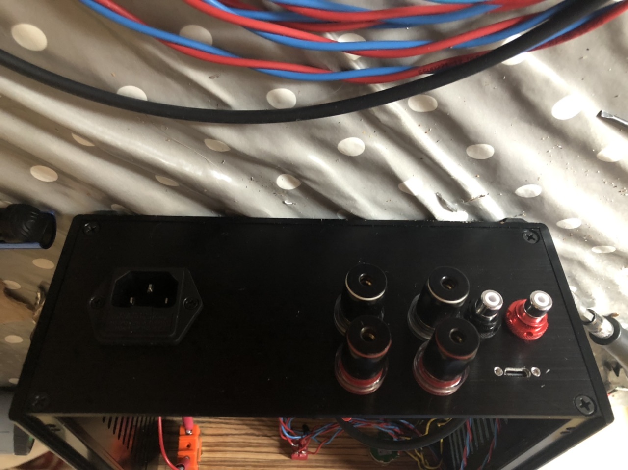

Busy wiring it all up..
Due to changing design / parts *after* ordering my cases, things got a bit cramped... :)
I'm trying to make it fit and then see whether it has any effect on performance, if putting things so close together degrades performance I'll have to get bigger cases.
Any insightful tips / advice based on this photo is always welcome :-D
Amp MkII
3eAUDIO TPA3255
Douk 400w 48vdc
Khadas Tone Board DAC
Audiophonics Case with custom zebrano front
USB C Extension Lead
