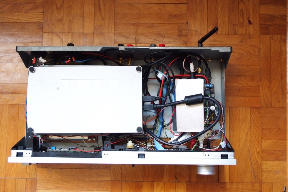

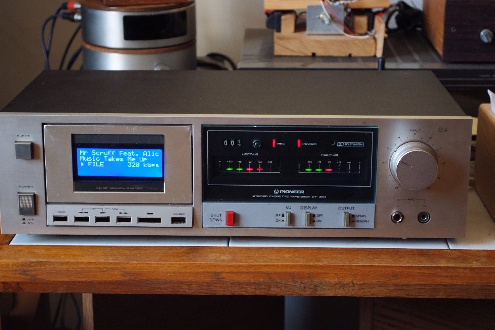

Here's another (rather quirky) DIY audio device: not just a Class D amp, but the whole shebang: RasPi audio server (+ DAC), Class D amp, built-in hard disk, IR remote, plus the usual stuff (Rune Audio distro, control via mobile phone/tablet, etc.).

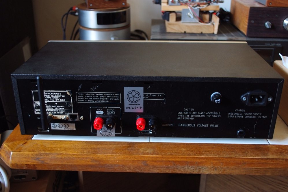

I like old tape decks, and when I got this one (beyond repair) for free, I decided I would "modernize" it :)
It took a while, but in the end, I quite like it. It has working VU meters :)

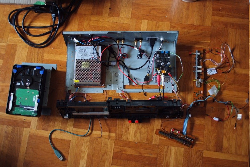

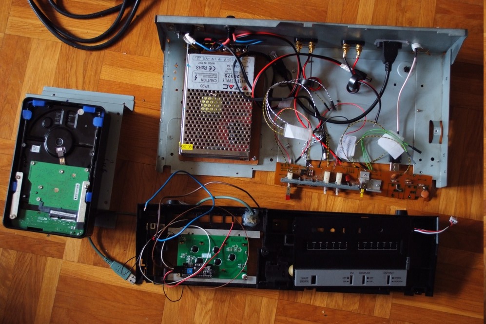

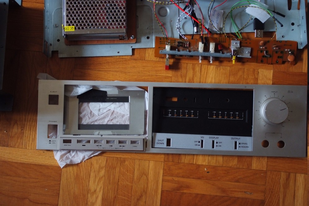

@den_hr - that looks great! Any chance you snapped some pics of the inside?
Hmm, I have a few... see attachments.

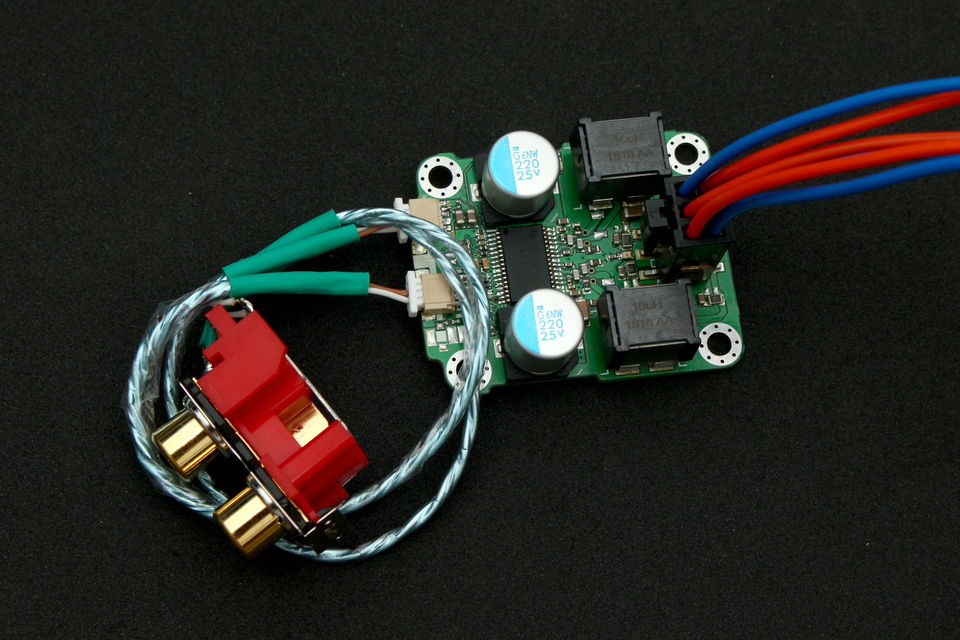

The main problem wasn't the electronics (RasPi and Class D amps aren't a problem, I've made dozens of those in various square and round enclosures). The main problem was deciding how to solve the mechanics :) - i.e. how to retain the original look of the tape deck, and even assign new functions to the existing buttons. Also, I had to make some new brackets for e.g. hard disk and the RasPi+amp combo. The wiring is a nightmare :)
Anyway, the innards are a mess - I'll probably do some tidying up later... but there's really not much I can do, except tie together those wires that can be tied together (not many...).
In short, no hissing, no buzzing, no interference, no RF noise... I'm happy :)
I might add a Bluetooth module in the next version....

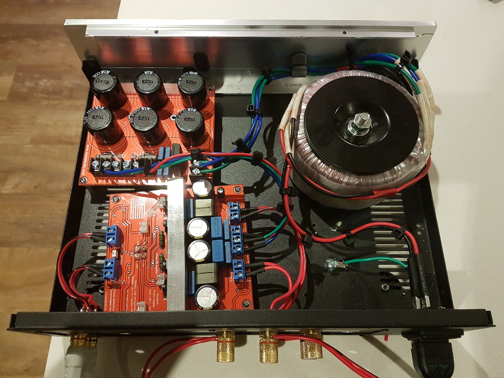

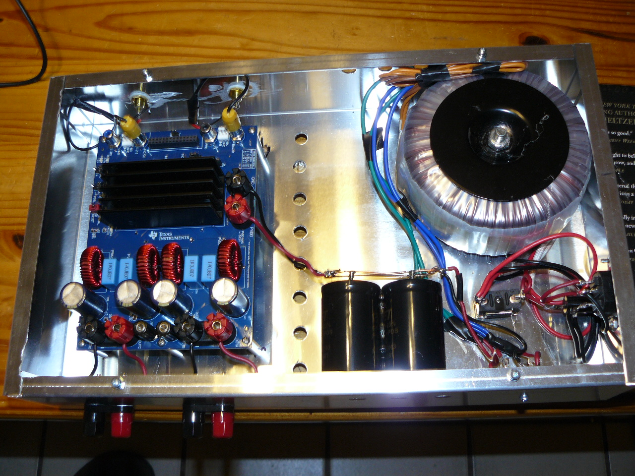

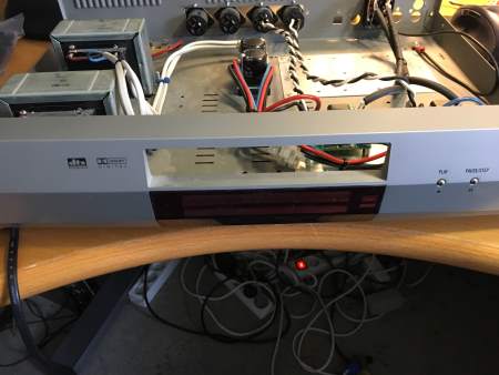

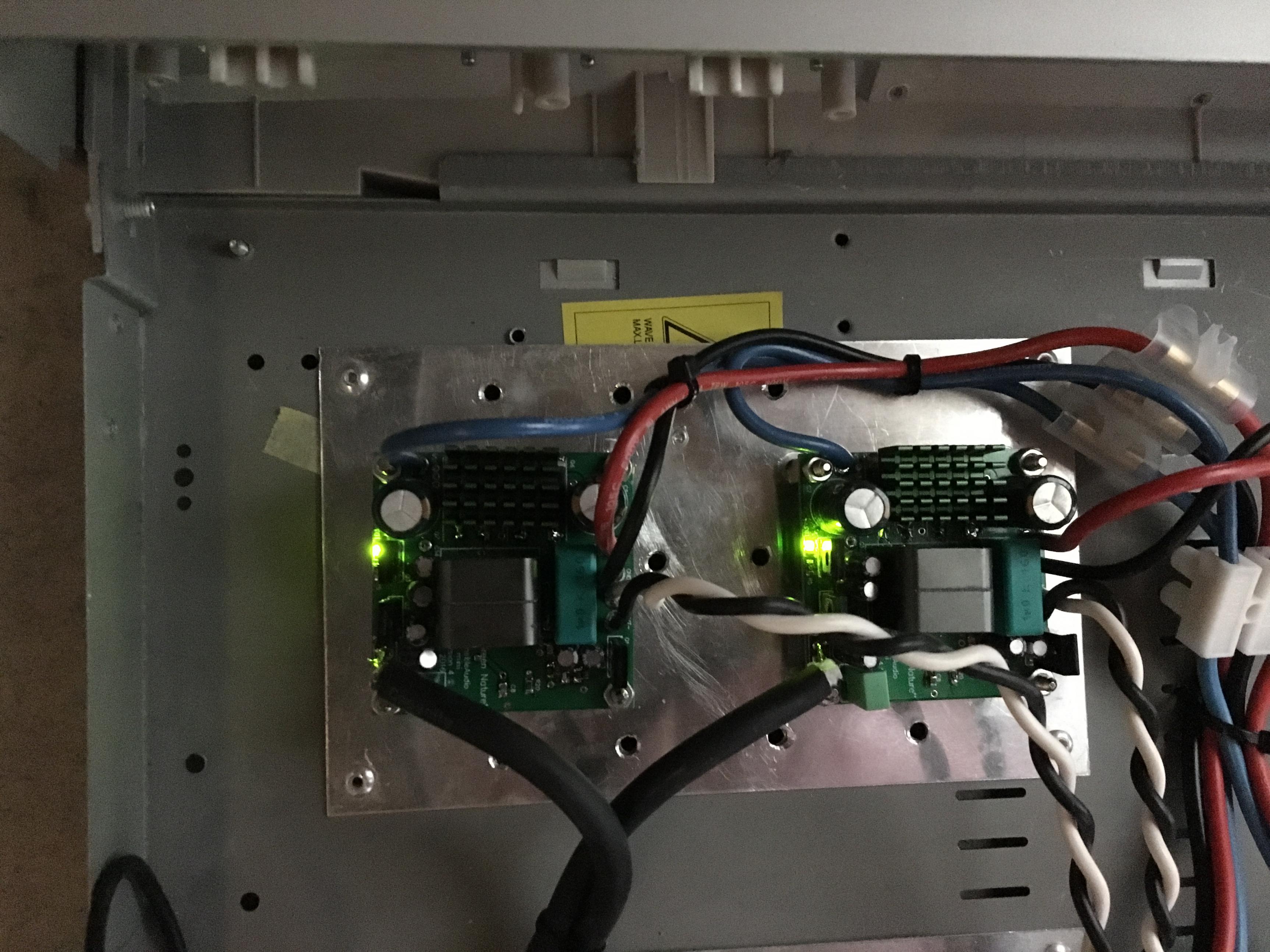

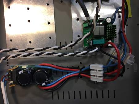

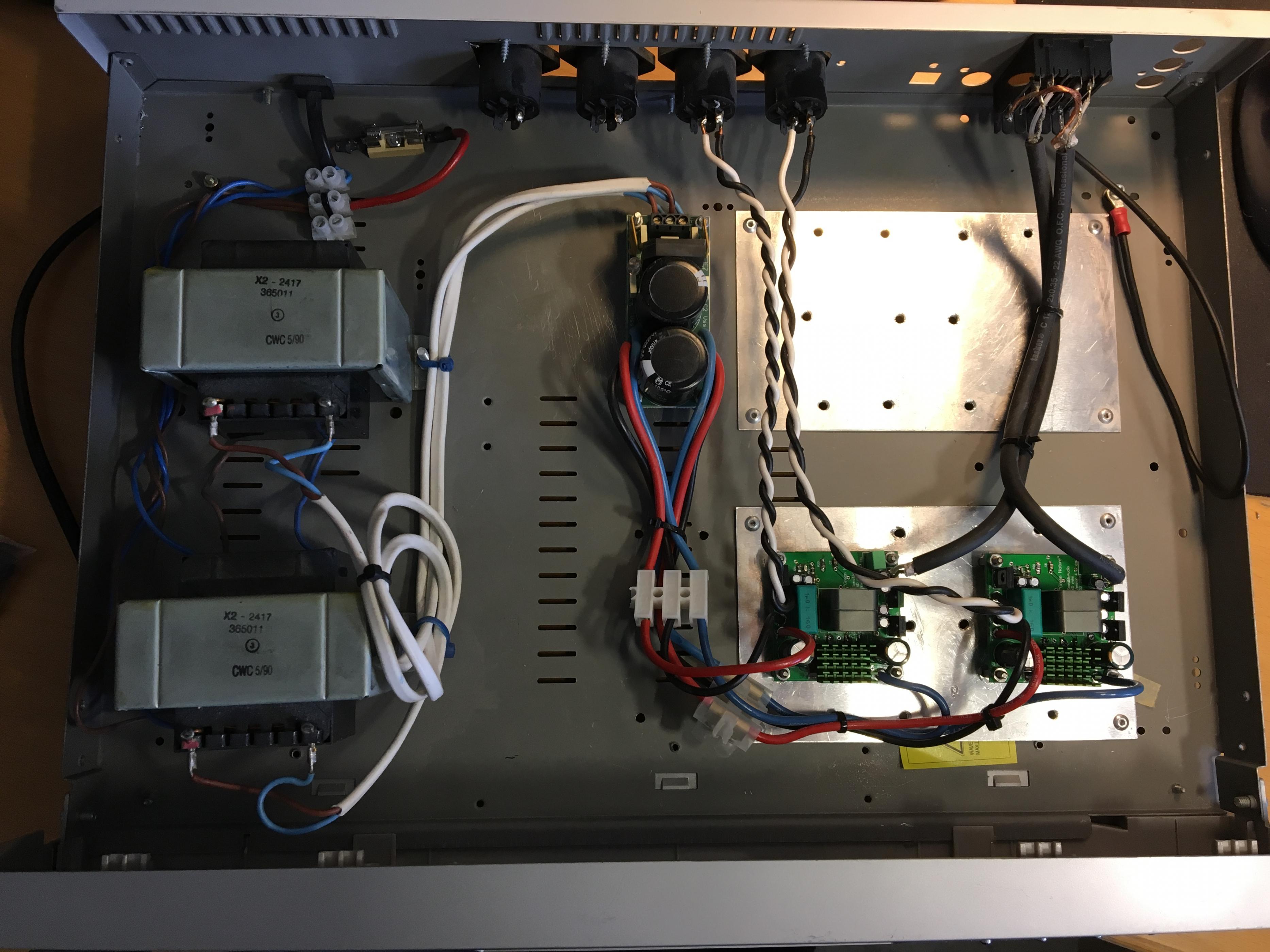

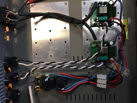

Five years ago I started a project to build a 3 channel power amplifier for my home theater and music setup. Yesterday, I finished it. Since starting the project I have blown 3 SMPS power supplies and four amp modules. I also retrieved the case and parts from the garbage bin twice. The most recent was a few weeks ago after blowing another SMPS and amp module. I learnt a lot from each experience and my pocket felt it too.
I decided to change the project to a 2 channel amp and build a mono for the centre channel later on. I ordered a CDA-250 kit from ClassDaudio.com and it arrived last week. When installing the kit I found that a couple of my speaker outputs were short circuiting. I wonder how much this played a role in my previous failed attempts! The CDA-250 is now up and running and sounds fantastic.

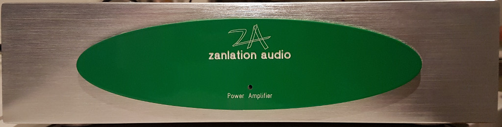

I designed my own case with a custom "zanlation audio" front and back panels. Its even got my own logo on the front and model number on the back. The bottom of the case is full of holes from previous modules and luckly, CDA-250 kit just fit. If anyone has a good method for working out how to mark the holes for drilling from the modules I would really welcome it. The worse part of the build was drilling the holes so I could screw the modules on.. exactly!
My next job is to install a power switch. I am using a remote control power board and logitech remote to turn it on/off. Next, I'll move onto a mono block.

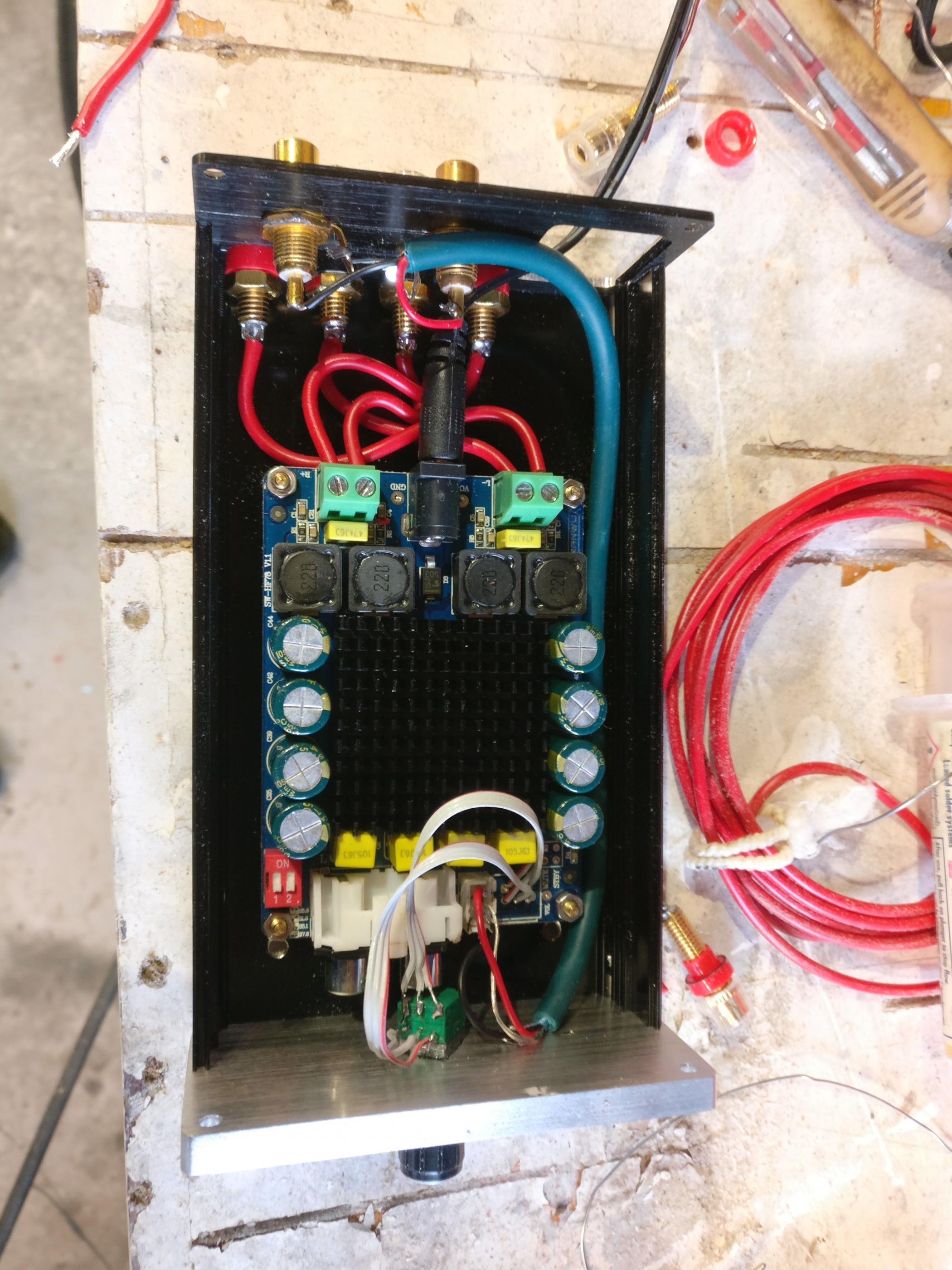

My first flirt with class D, a cheap TDA7498 from ebay.
I'm powering it with a 24v 2A psu and it sounds great on low levels. I'll be looking for a more powerfull psu to unleach it's full potential.
I liked it so much that I put it in a 0905 chassis even though I'm not planning to use it for anything. ;)
