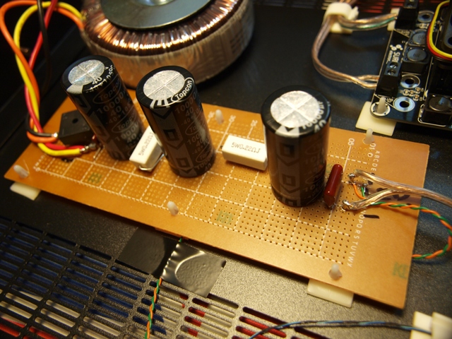

My Class D amp. 2*L15D+Connexelectronic SMPS800RE. Supply voltage +/-58 v.

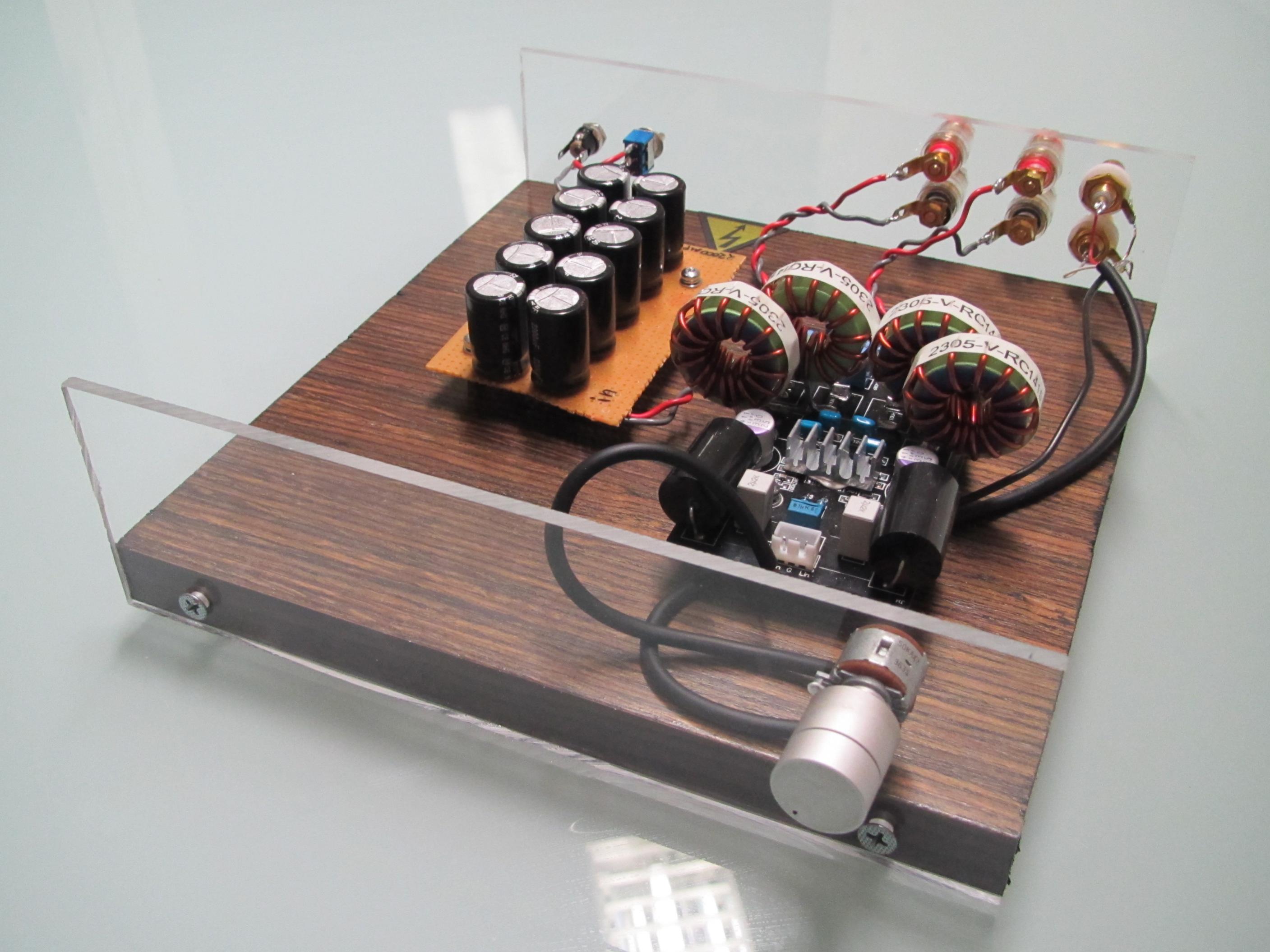

just finished one more abletec amp:
More pics and other amps here:
DIY Amps

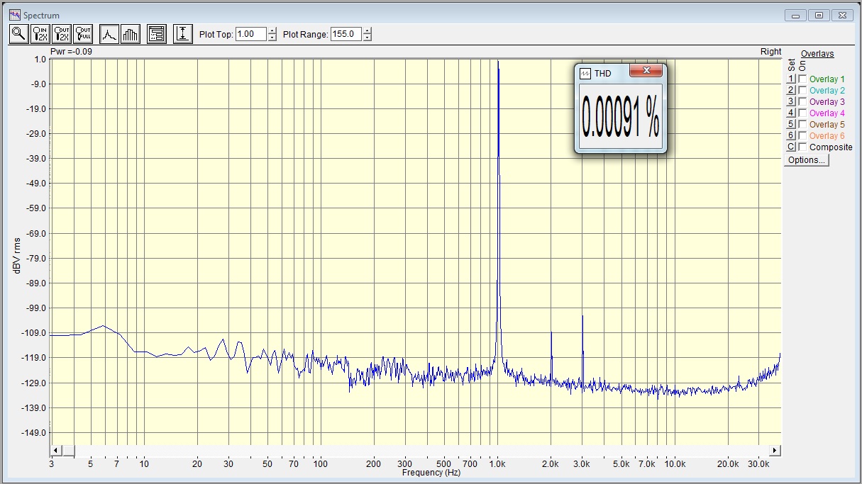

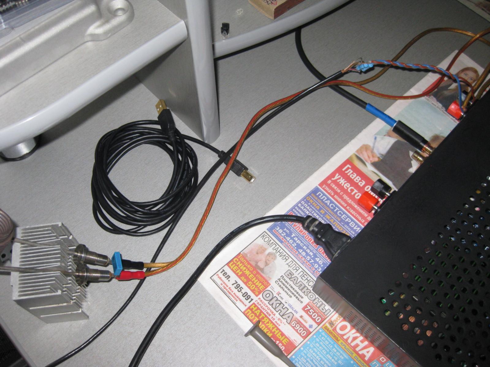

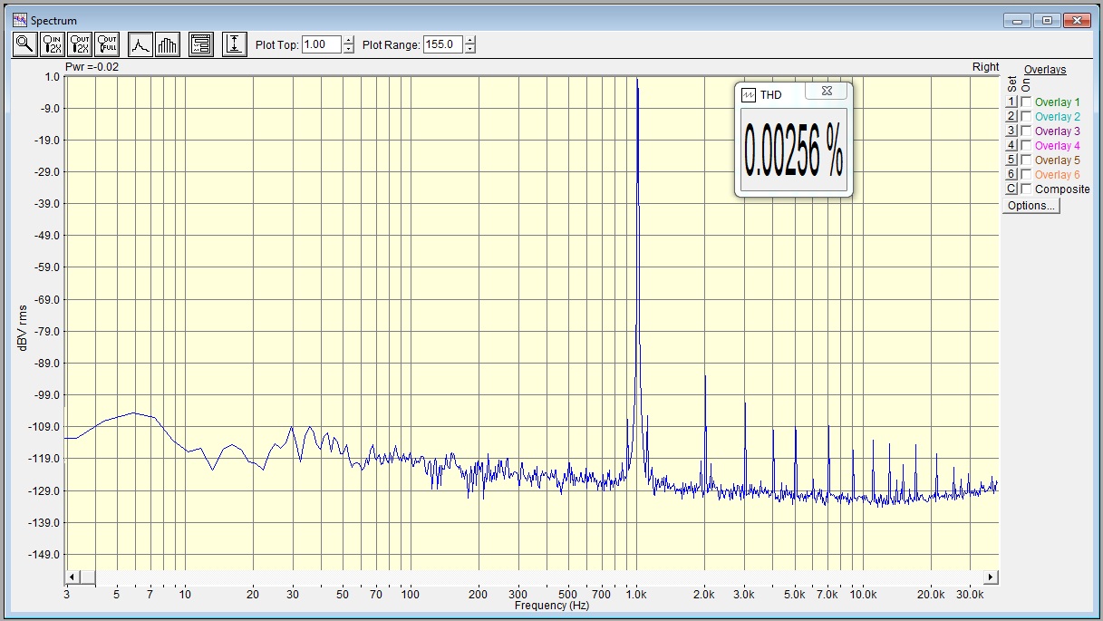

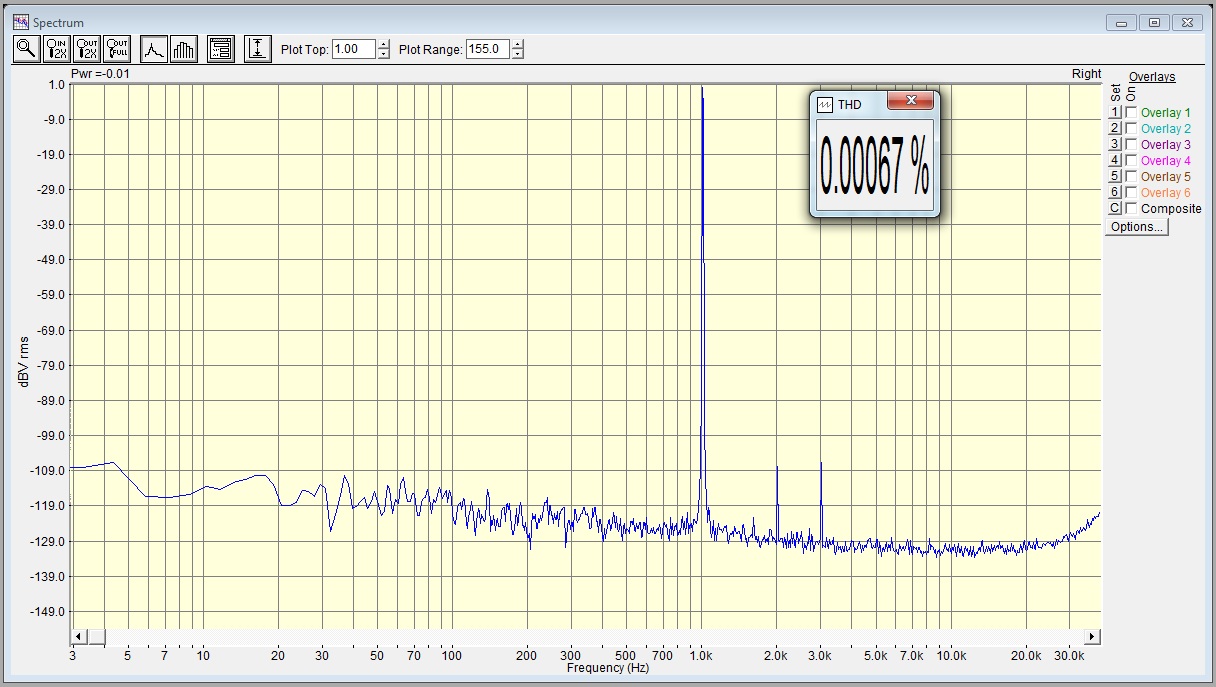

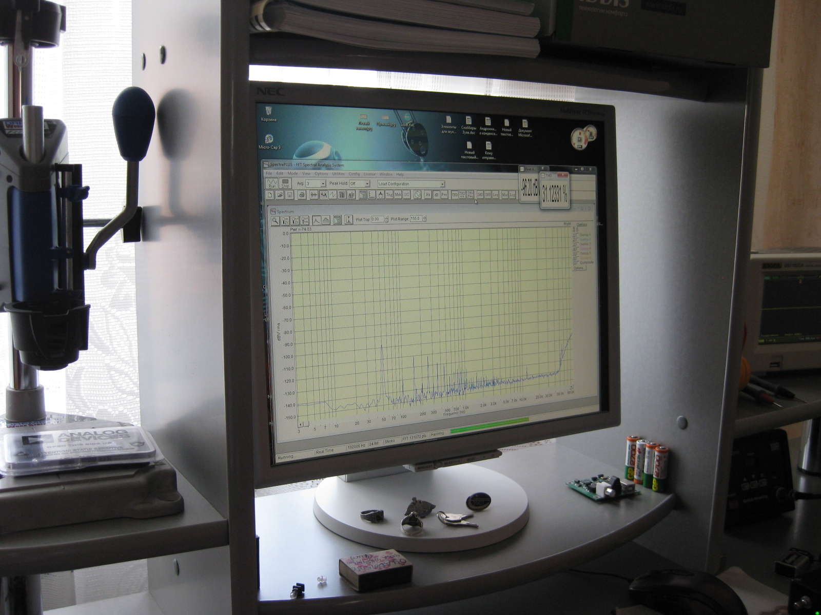

Right channel without/with 8 Ohm||0,1mkF loading. Output voltage 38vPP.
Best regards.
I miss the inductive load.

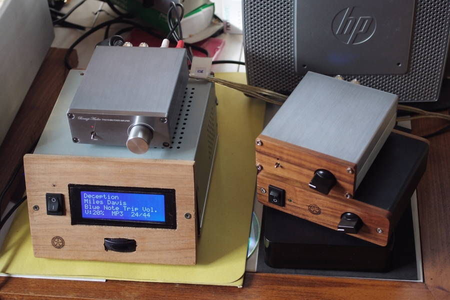

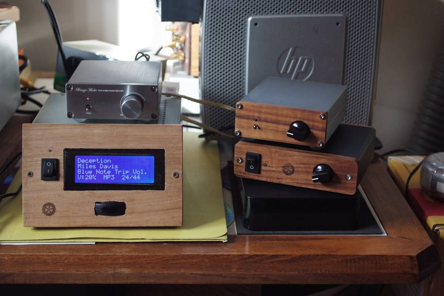

Two (i.e. three) variants of the TPA3116 Clas D amp - one (in the black enclosure, middle right) is in a repurposed external HDD enclosure, and the other two (silver ones) are as bought from ebay - and on one of those I've changed the front panel using wood.... I kinda like wood more for the front panel The black box on the bottom right is an external WD hard disk.
The bigger box with the LCD on the lower left is a DIY audio server, running Raspberry Pi + Wolfson audio card (24/192), plus LCD display and a remote sensor (it's controlled either by the remote control via IR, or using a tablet/smartphone and any of the available MPD clients...).
I'm enjoying this combo - the TPA3116 amps are realy nice....

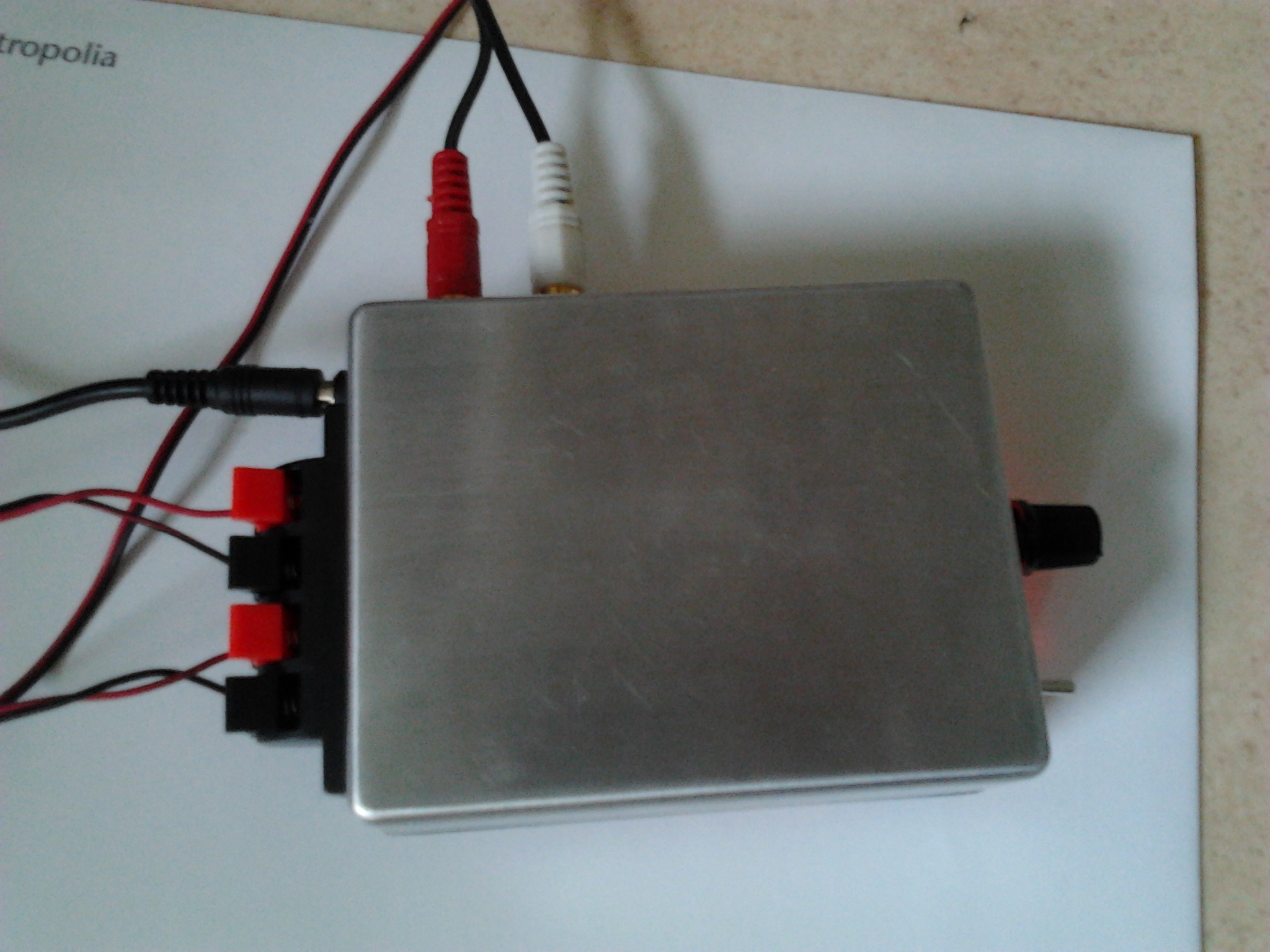

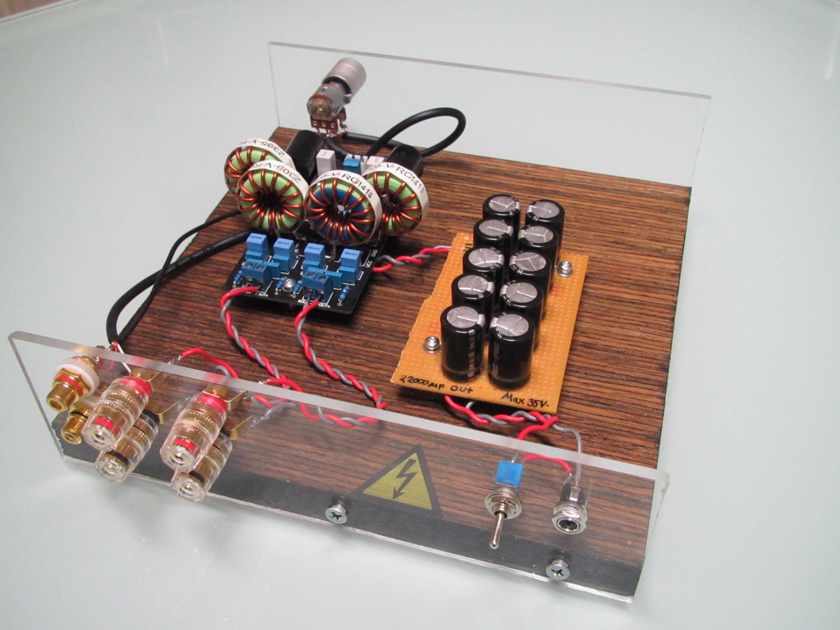

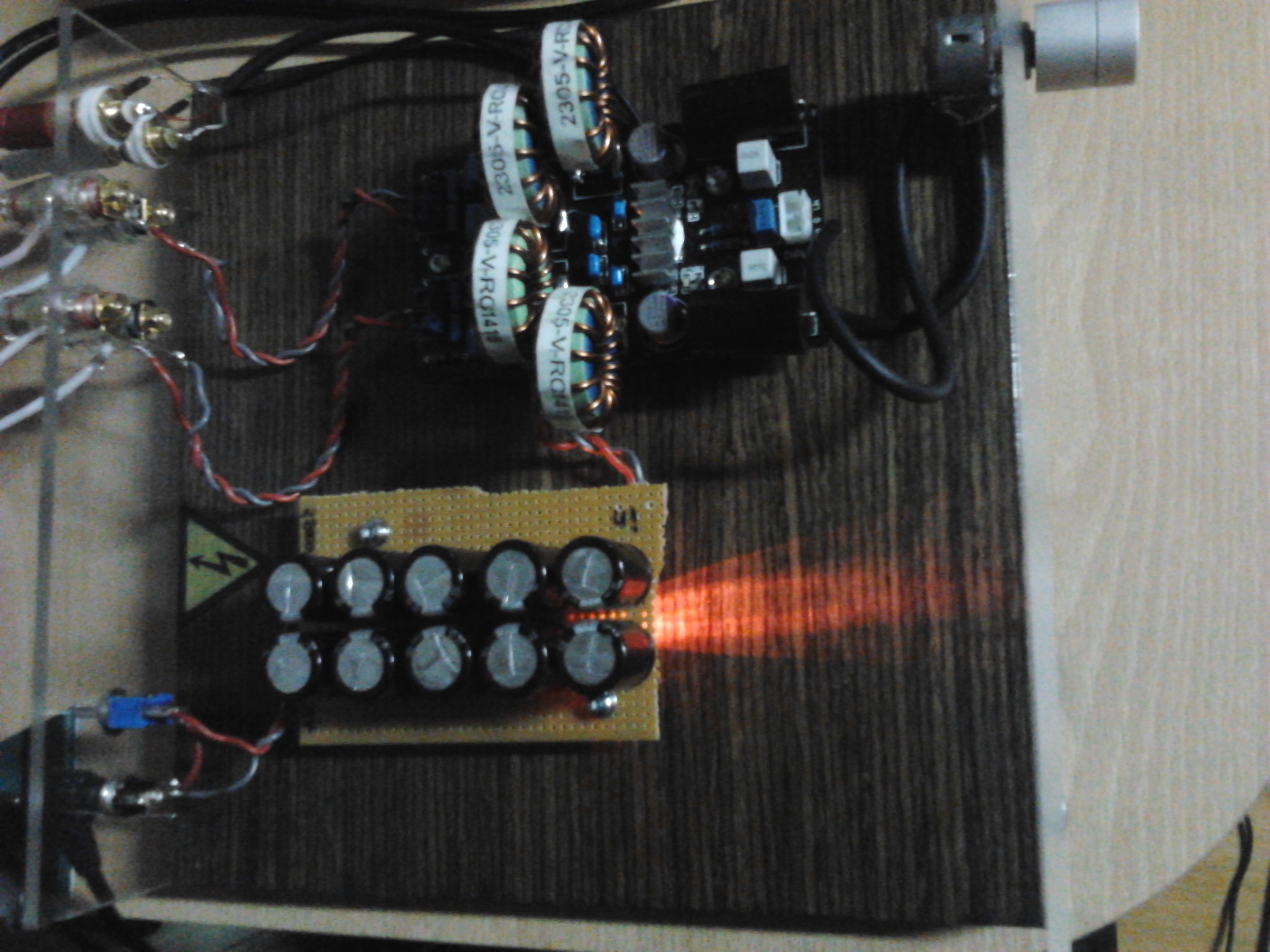

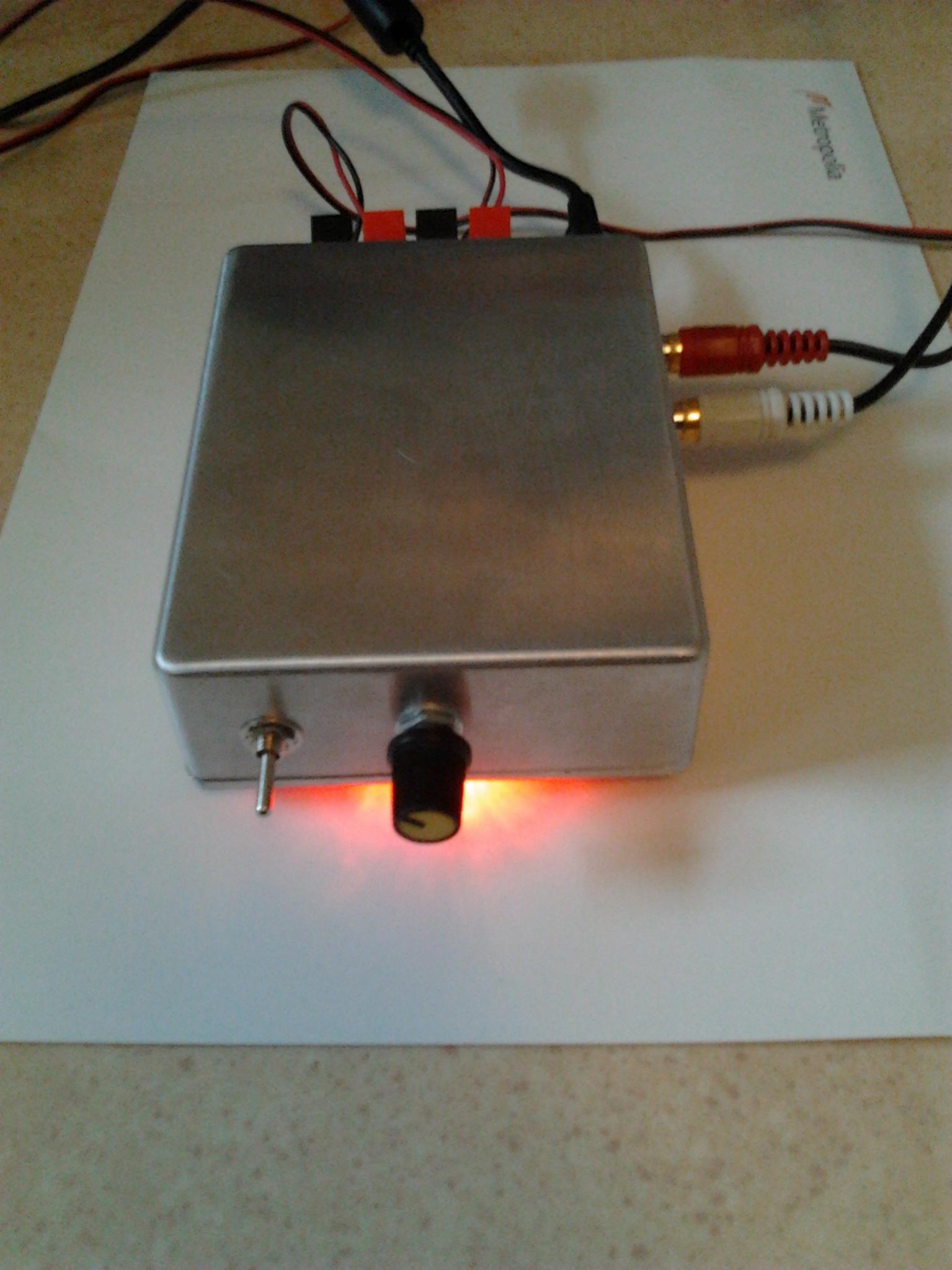

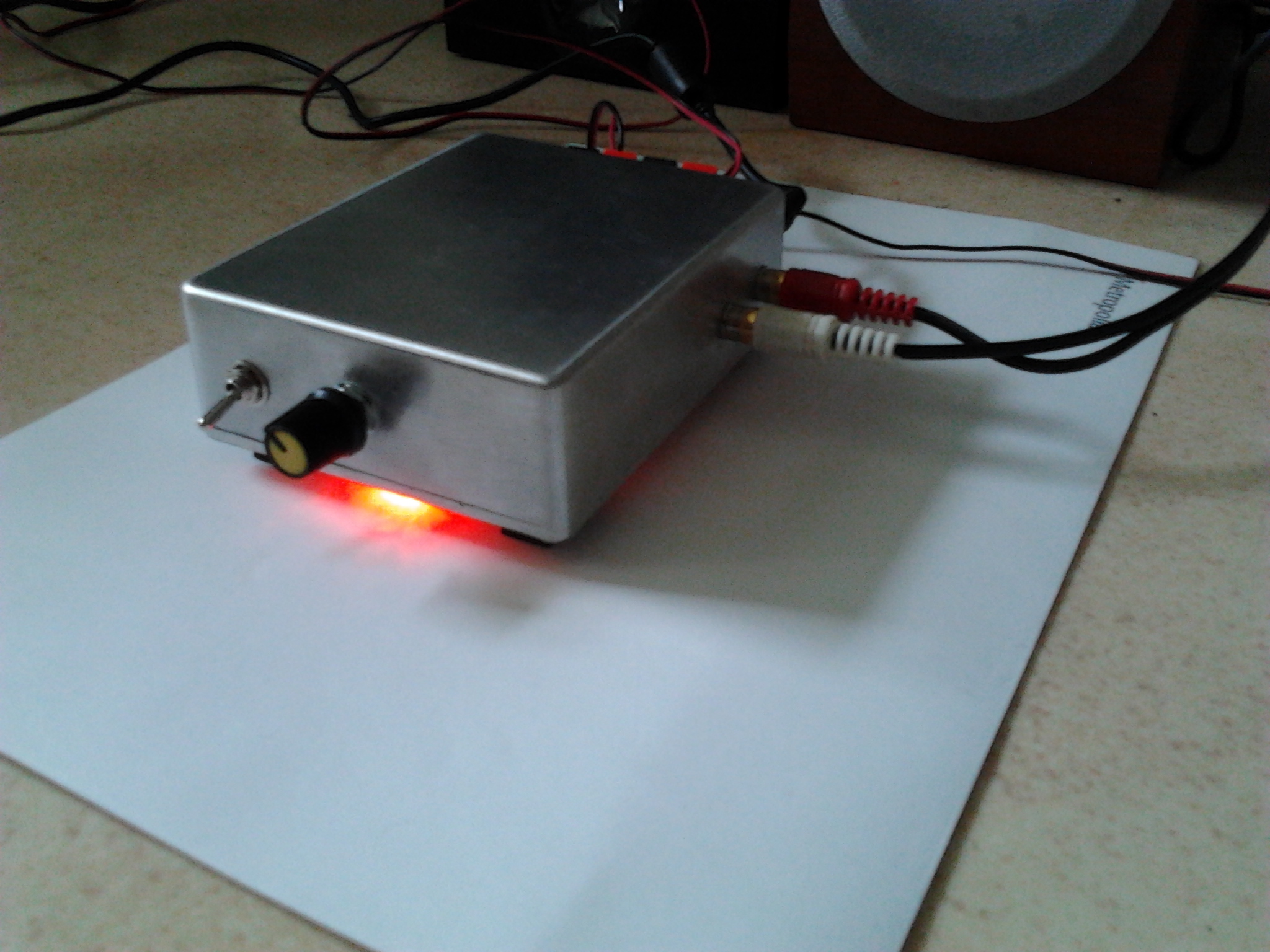

I thought it would be time to show some of my finished projects.
First one is TA2024 and it's my very first audio DIY project. I got the inspiration from here. It was very nice introduction to amp building.
Second one is TPA3116, built using famous Yuan Jing board. "Enclosure" was built using what I happened to have at hand. Next time I will try to find something more appropriate.
Both feature foxy orange led.

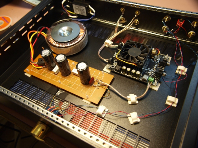

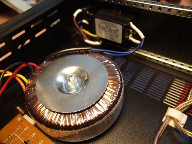

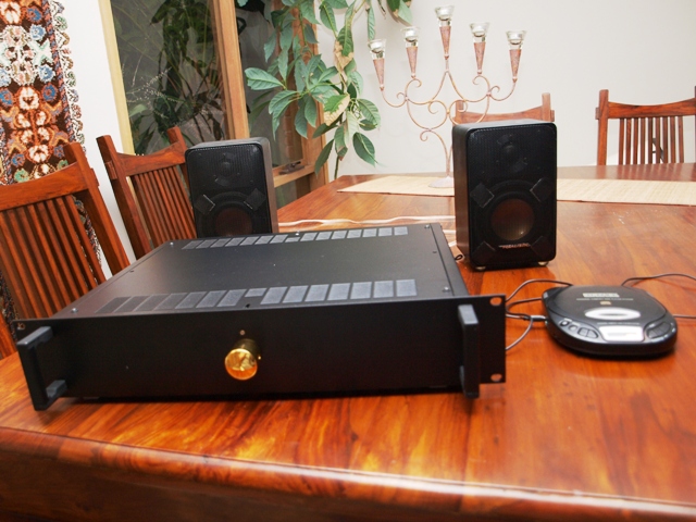

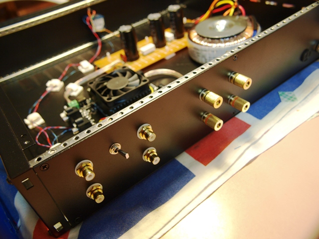

Sure Class D 100W power amp
Here is a 100W Class D I put together around the $30 Sure Class D modules. Enclosure is a 2U 19" dampened rack mount. It has two switchable inputs; one with a Alps pot and 4oz solid brass knob for sources which do not have attenuators and one which connects direct to the power module. 10A rec. bridge and 30,000uf of filtering\storage provide 25V to the brd. Solid brass speaker binding posts, heavy gold plated RCAs, silver plated copper wire in the audio path, a power filter and ferite power cord choke round-out the compliment,
I have only had a short chance to listen to the amp quietly on test speakers so hard to comment on performance. But it will come.
