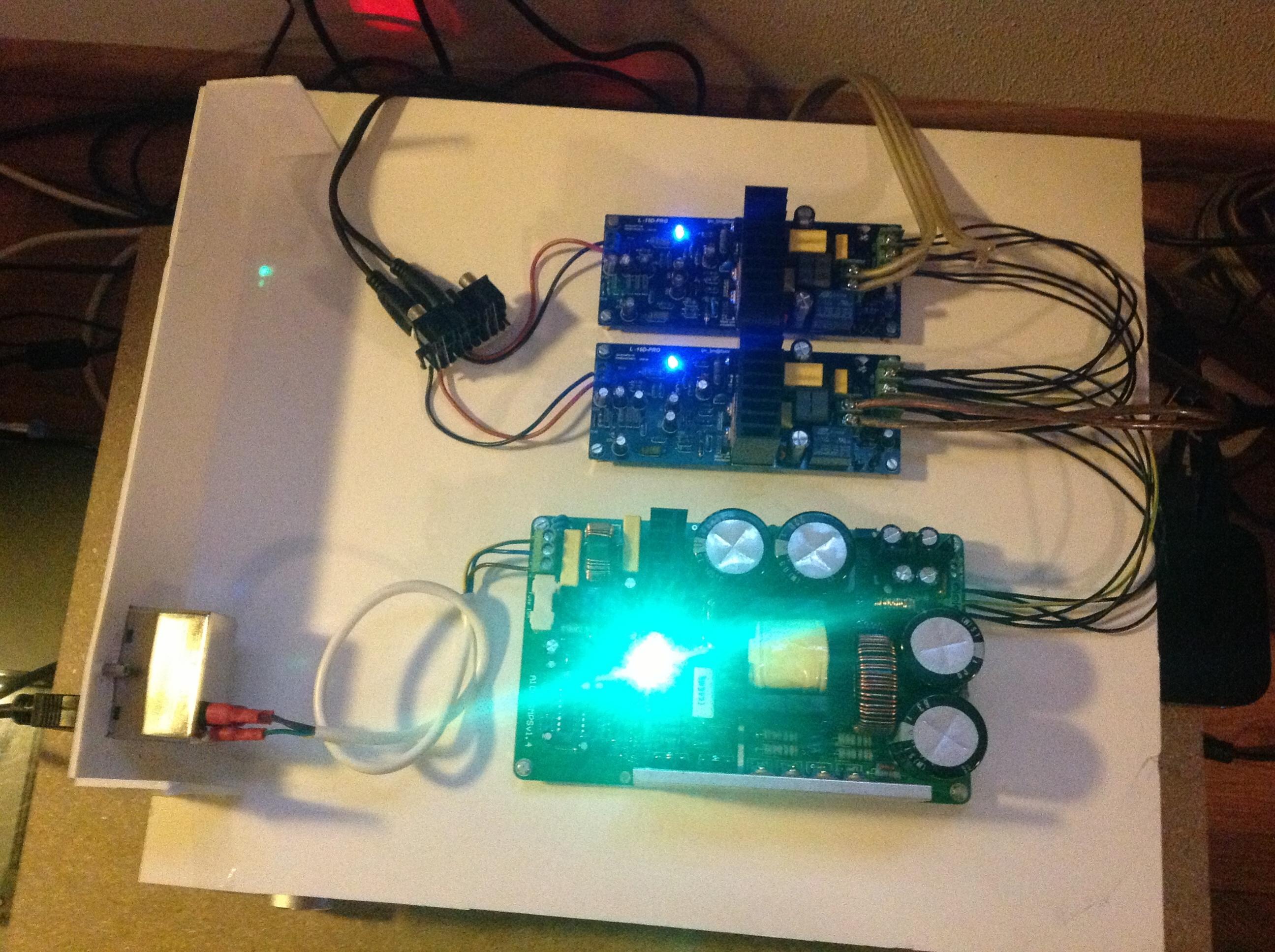

So I just finished my test setup with connexelectronic A1000SMPS @51v and two L-15D-PRO modules. So far so good. Volatages are good, and sound is also good. Currently connected to miniDSP 4x10. I have another 8 amps. I'll use 6 of them to power the other DSP channels. It will all go in a nice hifi2000 2U case that I'll be ordering soon. More pics then. The two extra channels are backups ;)
So what I did notice is that Bass is far less extended than my old UcD400, and even the cheap t-amp that I used for the last week. Not sure why this is the case.

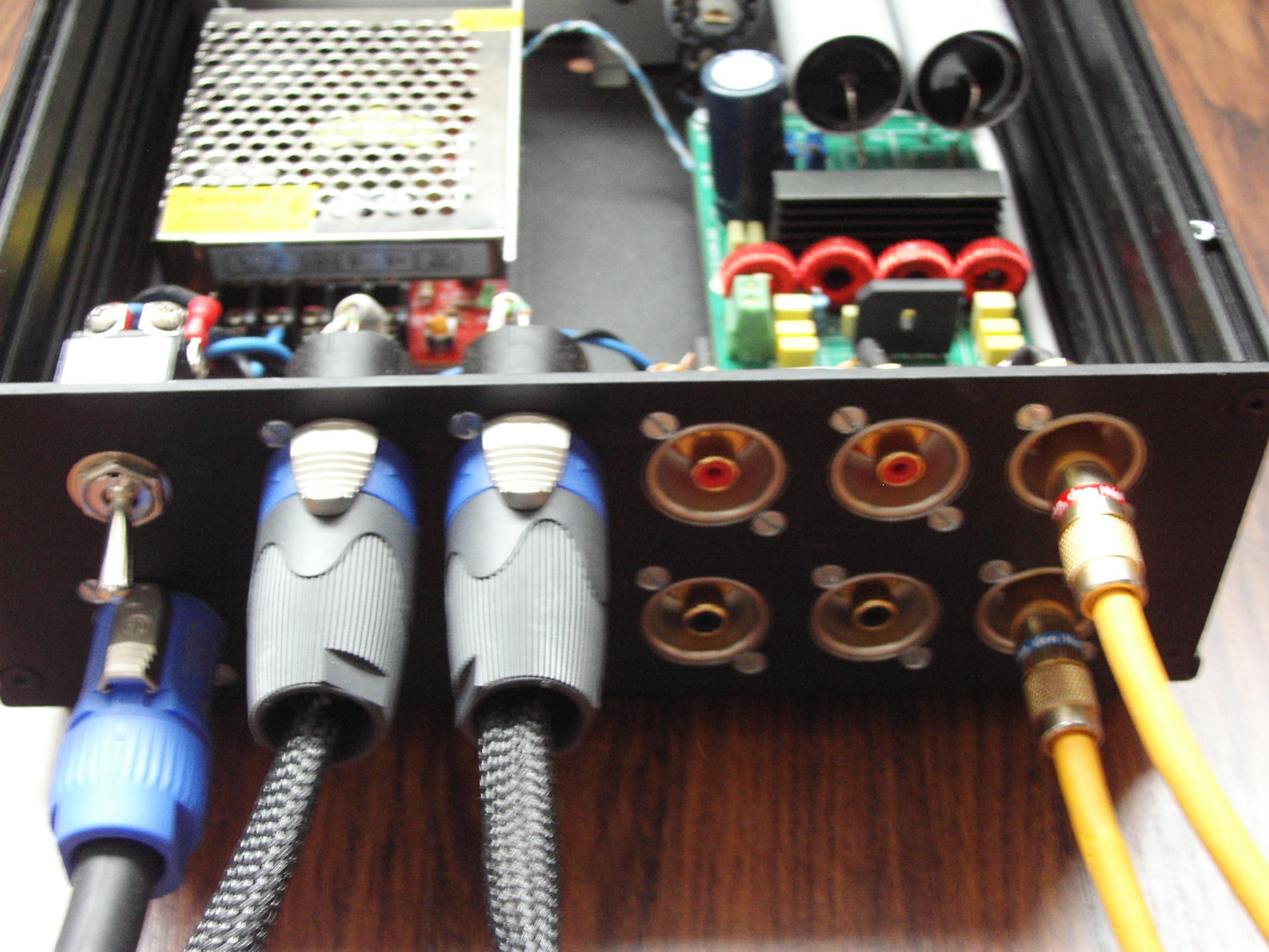

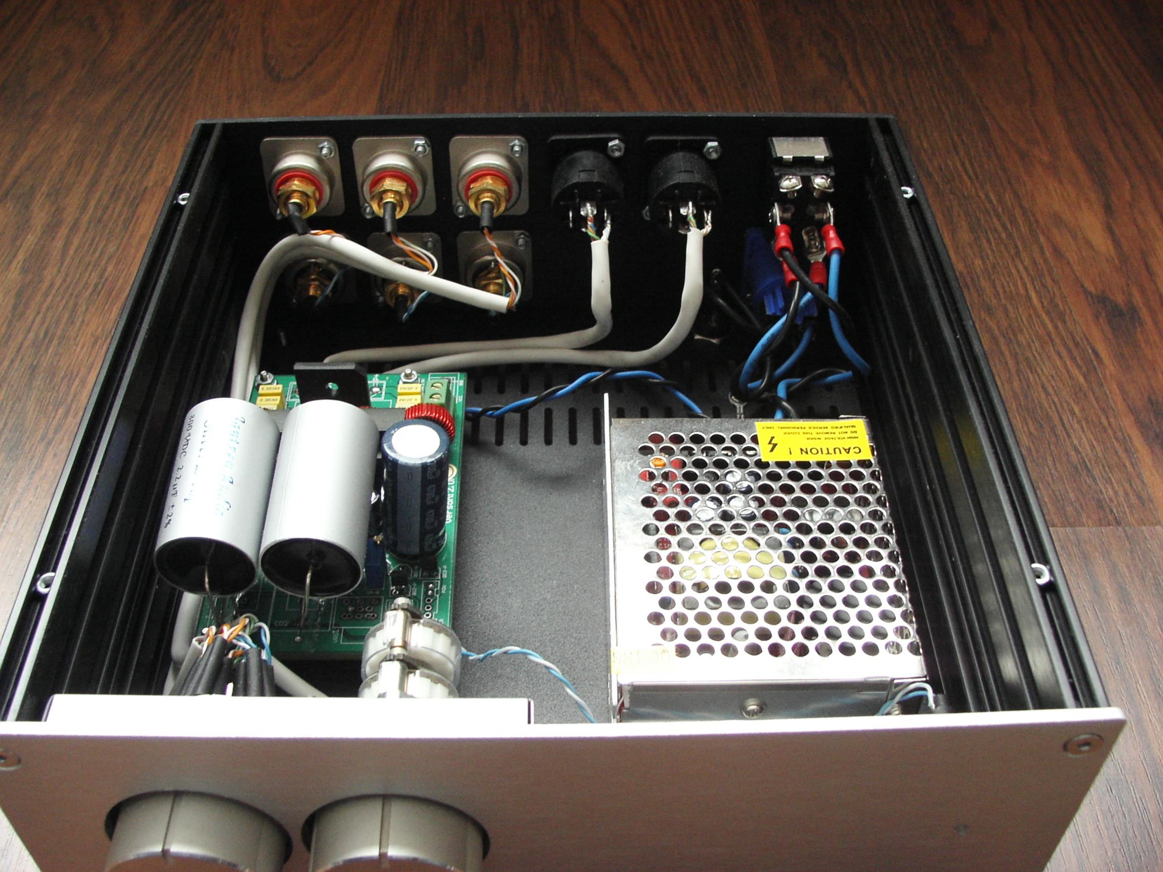

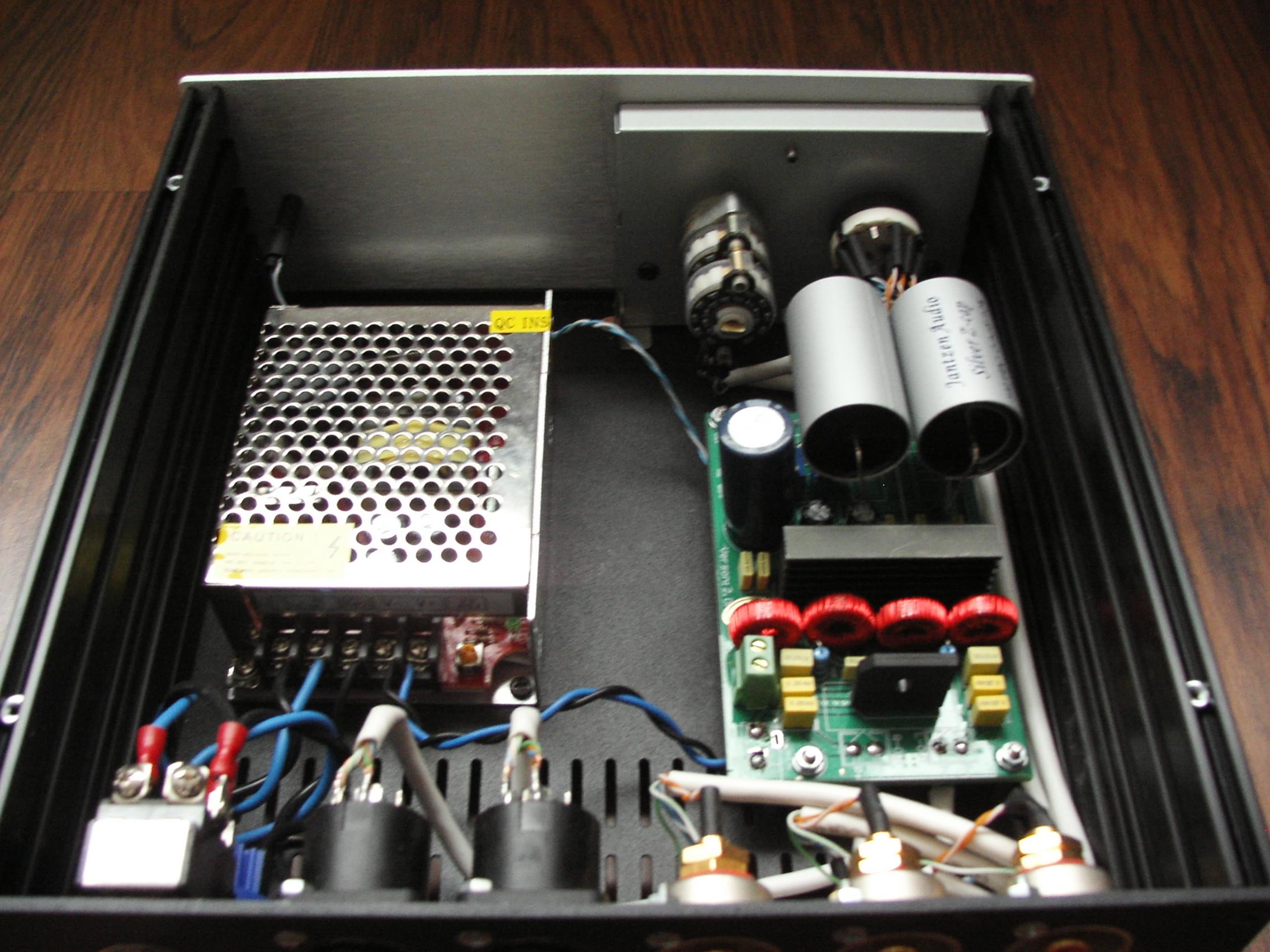

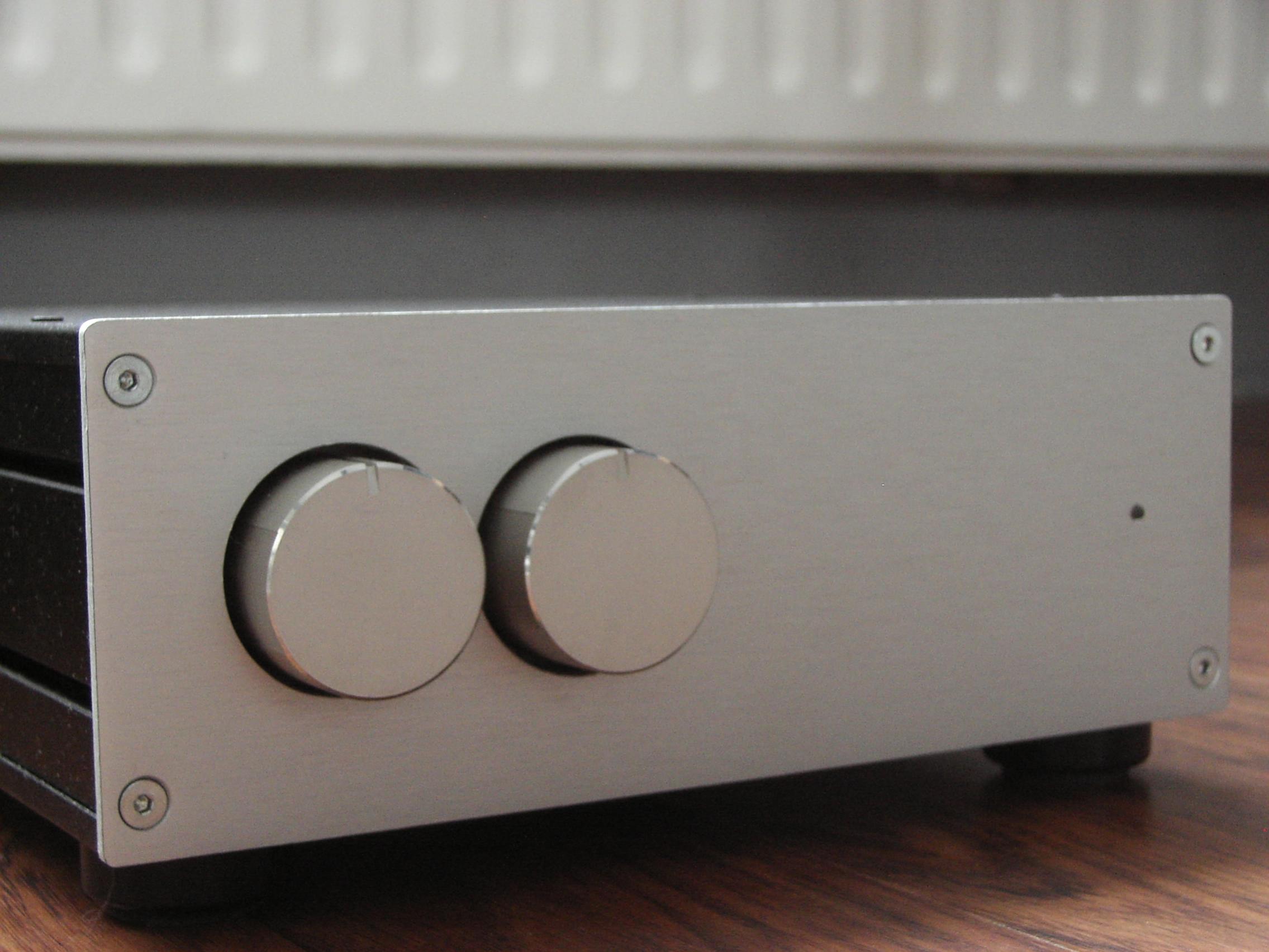

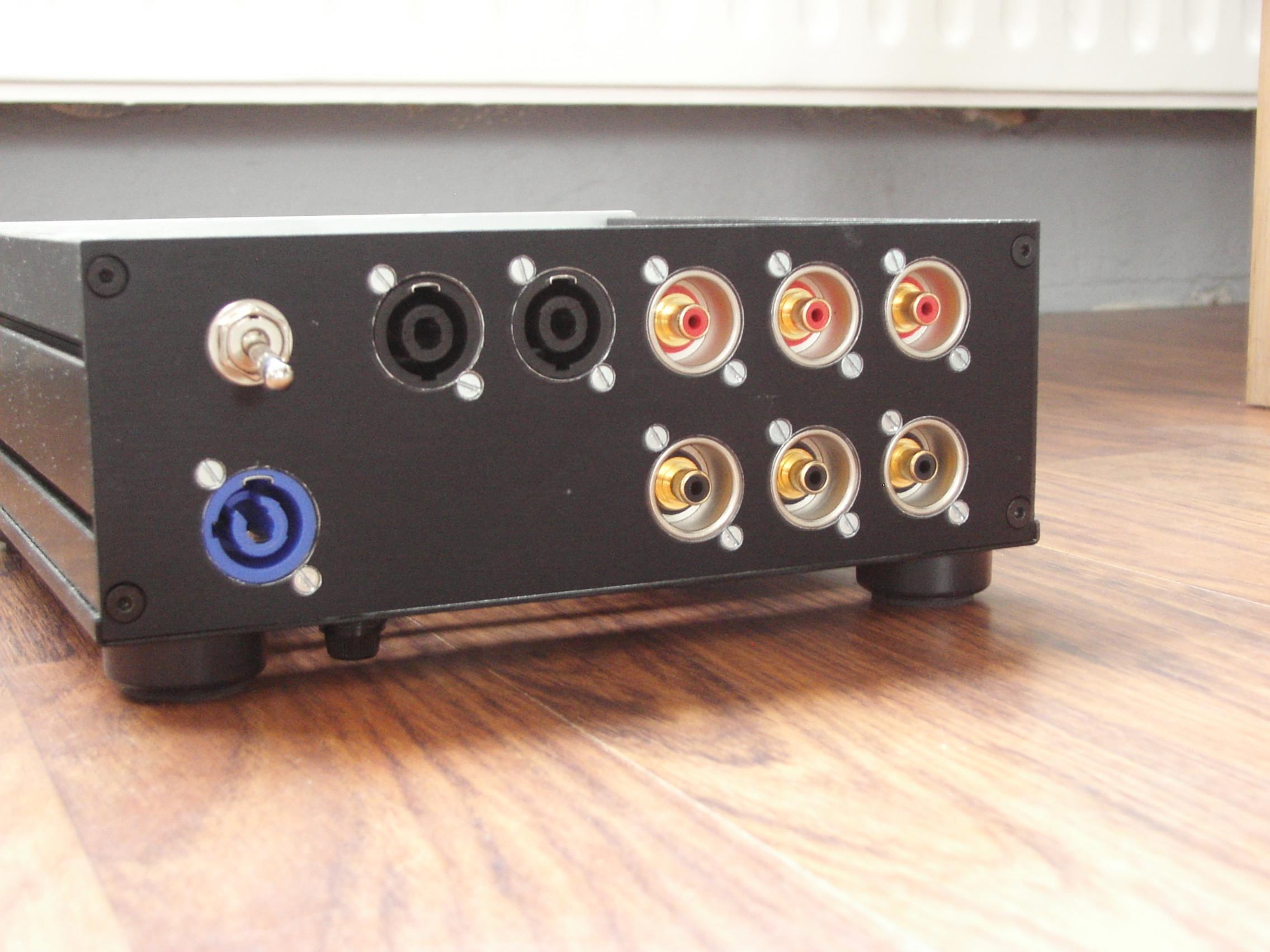

TA2020 build
This is my little amp,
TA2020 Arjen Helder
SMPS Arjen Helder
Volume pot Dact CT-2
Neutrik connectors
Casing Modu shop
Wiring UTP
Old Sansui knobs
I love it with my Philips 9710 FR speakers

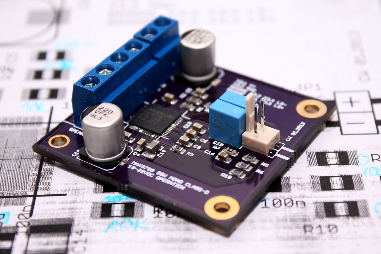

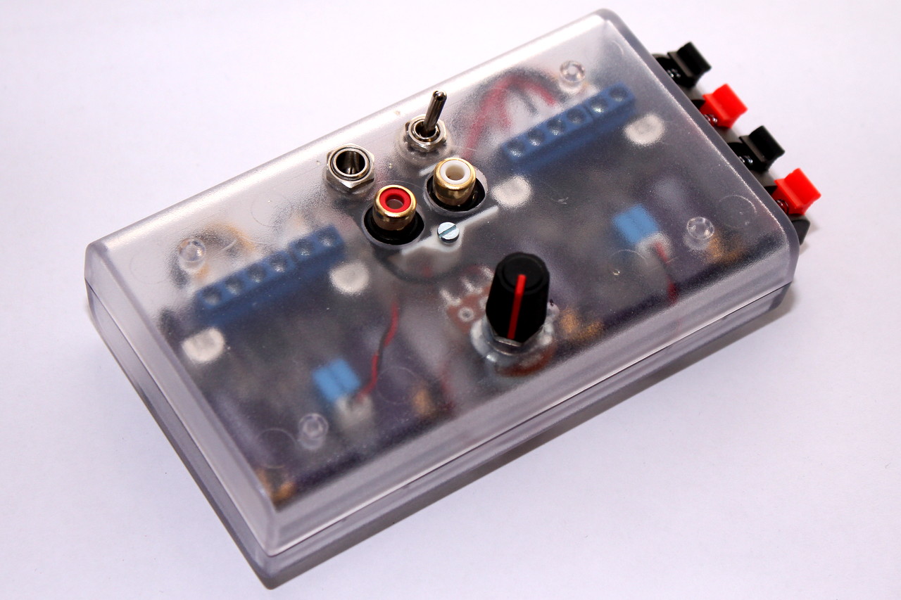

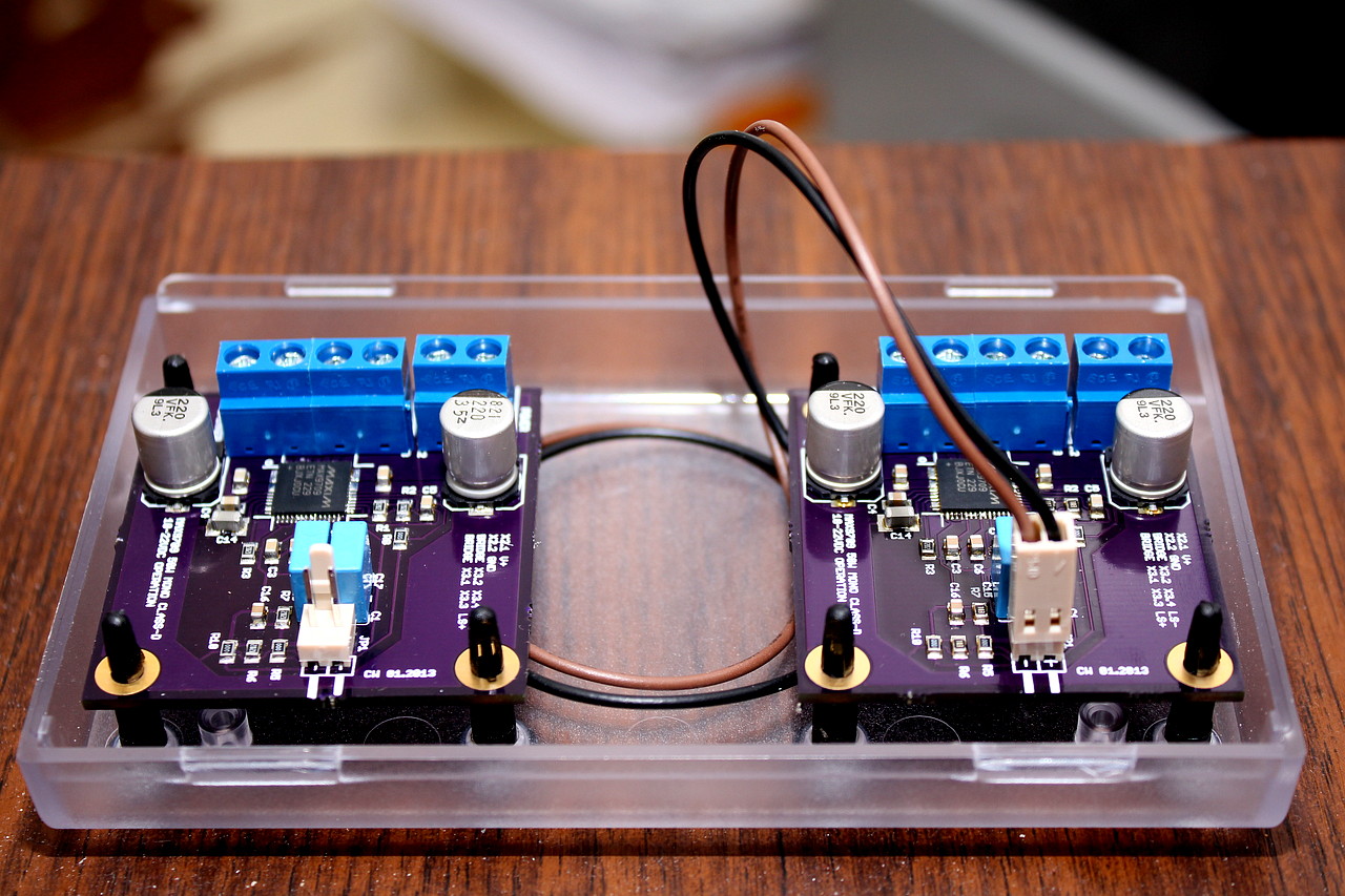

This is my new MAX9709 "Plasticman".
Pout is estimated at 50W each at 24V 4Ohms. Haven't tested it under full load in this case - might get "hot". :) Main cooling is via groundplane which is 90% of the bottom layer and 40% of the top.

Configured as 2xMono.
attachment.php
attachment.php

Very nice Docmord, I like the translucent case effect. I noticed that the board is rated 22 v max and you want to run it with 24 v? Probably ok as the main cap is 35 v. How does it sound?
Where did you buy the Maxim boards from?
Edit: I went to the link it looks like you made (designed) the board yourself - very nice job! Totally professional looking, you could sell them :)
Thanks for the reply. :)
OT: @xrk971
Of course, the board can be run by 24V if needed. I just put this 22V note for safety reasons. The board is running well with 12V, but if you need some more "ompf", 19-22V is/are the voltage to go.
What i know from other projects is, that people are trying to max out the performance. I.E. When there is a 19V max. voltage quoted, they also try 20-22V, just to see if things go right and they can "effort" more power. Not every design is made for this or even the chips are - resulting in circuit-damages. That said, when is would write 24V max, someone would try 26V.. :D
(As you may see in the following table, the difference in output-power is only 6W (22V <-> 24V) - you wont hear this i guess (46W vs. 52W)
As for the board, you're are right, they are designed from scratch, keeping some thermal considerations into account.
For the mono-operation, there is:
VDD=12V: 1x15W -> efficiency: 80%
VDD=18V: 1x33W -> efficiency: 84%
VDD=22V: 1x46W -> efficiency: 85%
VDD=24V: 1x52W -> efficiency: 86%
The thermal protection is set to 120°C.
Lets see what happens if we will run at full 50W sinus continiously(which those class-d-chips arent designed for - This wont affect peak power).
TA = 30°C (ambient temperature)
Pout = 50W
Effizienz: (n) = 86%
Rth_JA = 21K/W (thermal resistance [junction to ambient]
Pdiss = (Pout / n) - Pout = (50W / 0.86) - 50W = 8.14W
TC = TA + Pdiss * Rth_JA = 30°C + 8.14W * 21K/W = 201 °C
With ~8W power dissipation, the chip would heat up to ~200°C - wont work as thermal protection will kick in a 120°C. (This is meant to be seen with no cooling at all)
So now lets see whats the max continous output-power with no cooling.
Pout(TC)=[n*(TC-TA)] / [Rth_JA - Rth_JA*n]
with TC = 120°C
Pout(120°C) = [0.86*(120°C-30°C)] / [21K/W - 21K/W*0.86] = 26.32W
Pdiss(120°C) = (26.32W / 0.86) - 26.32W = 4.3W
26W is the maximum continous output power without any cooling at 30°C ambient temperature. At this level we need to spread heat with 4.3Watts. Thats were the bare copper comes into account. The PCB acts as a cooler via the GND-pad. So peak power can be 50W of course, but not continously. Having a look into the table, 18V would be sufficient to have 26W cont. output-power. If you're on "heavy bass" there will then be distortion for the peaks, as 18V gives 33W peak power.
If you need more power, (local) ambient temperature needs to be lowered by active cooling. As this can't go below the surrounding ambient temp, you're restricted by "local weather". "Work-around" would be a TEC or liquid cooling with i.e. "fresh water".
Cheers doc
