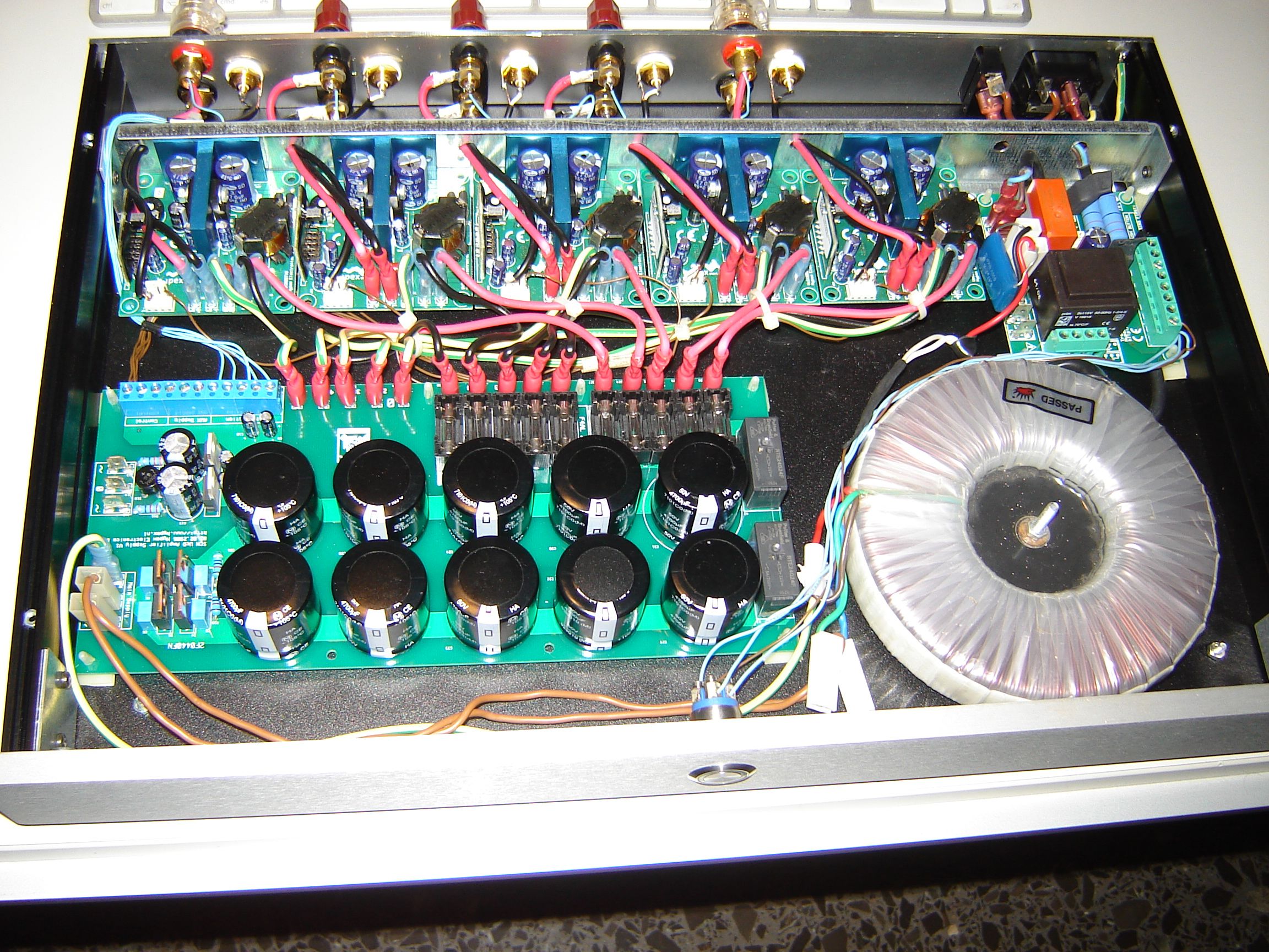

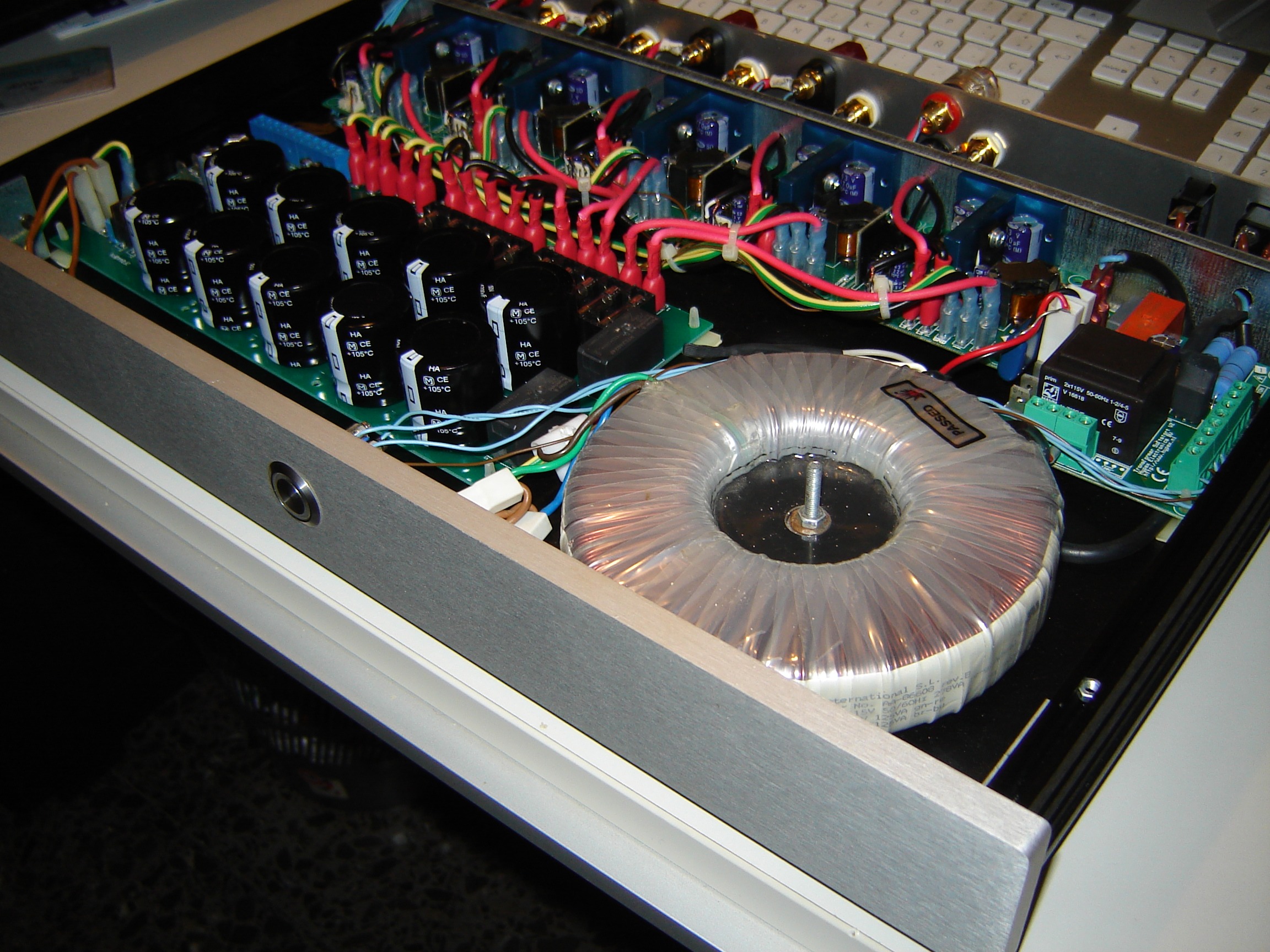

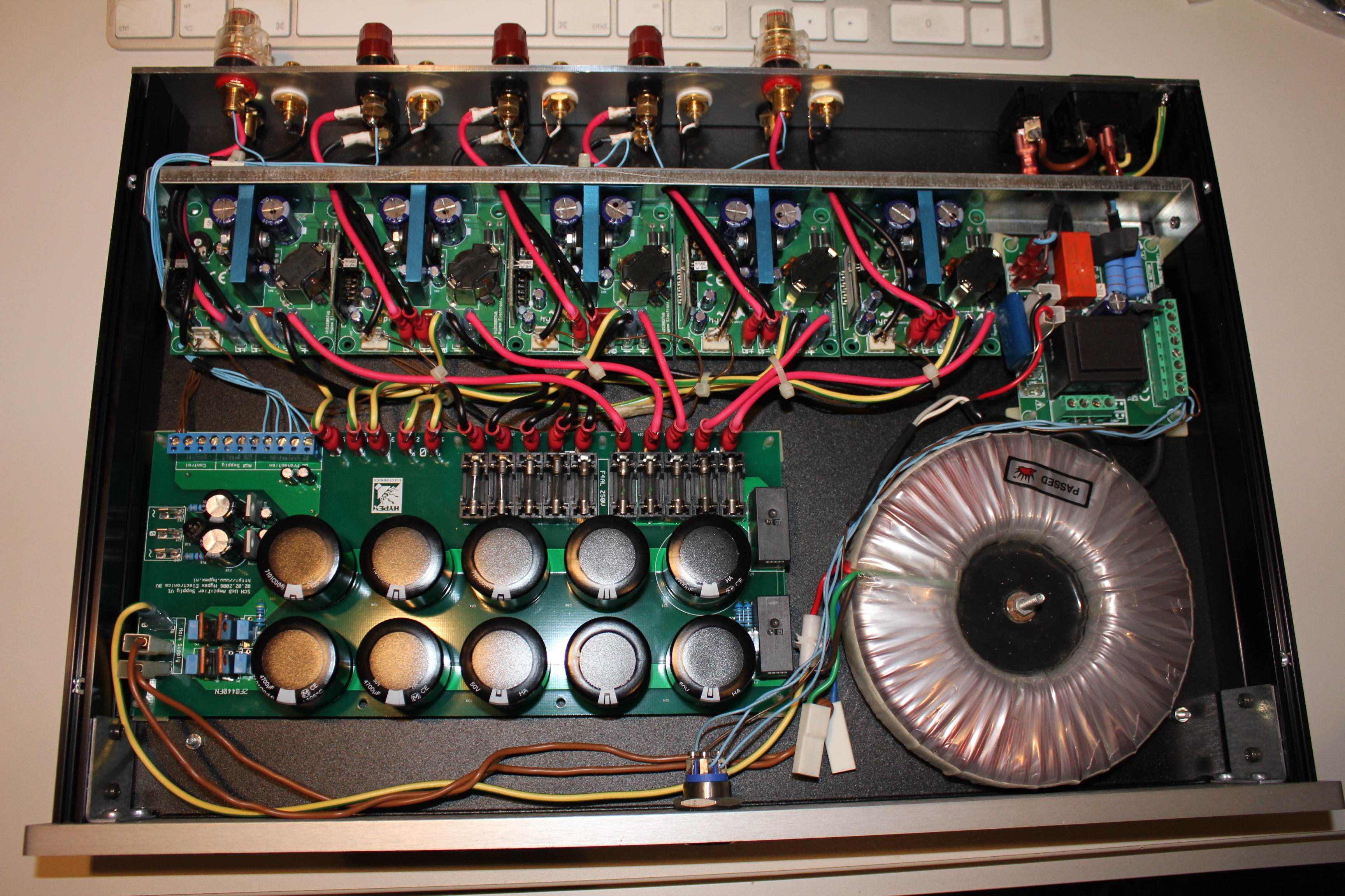

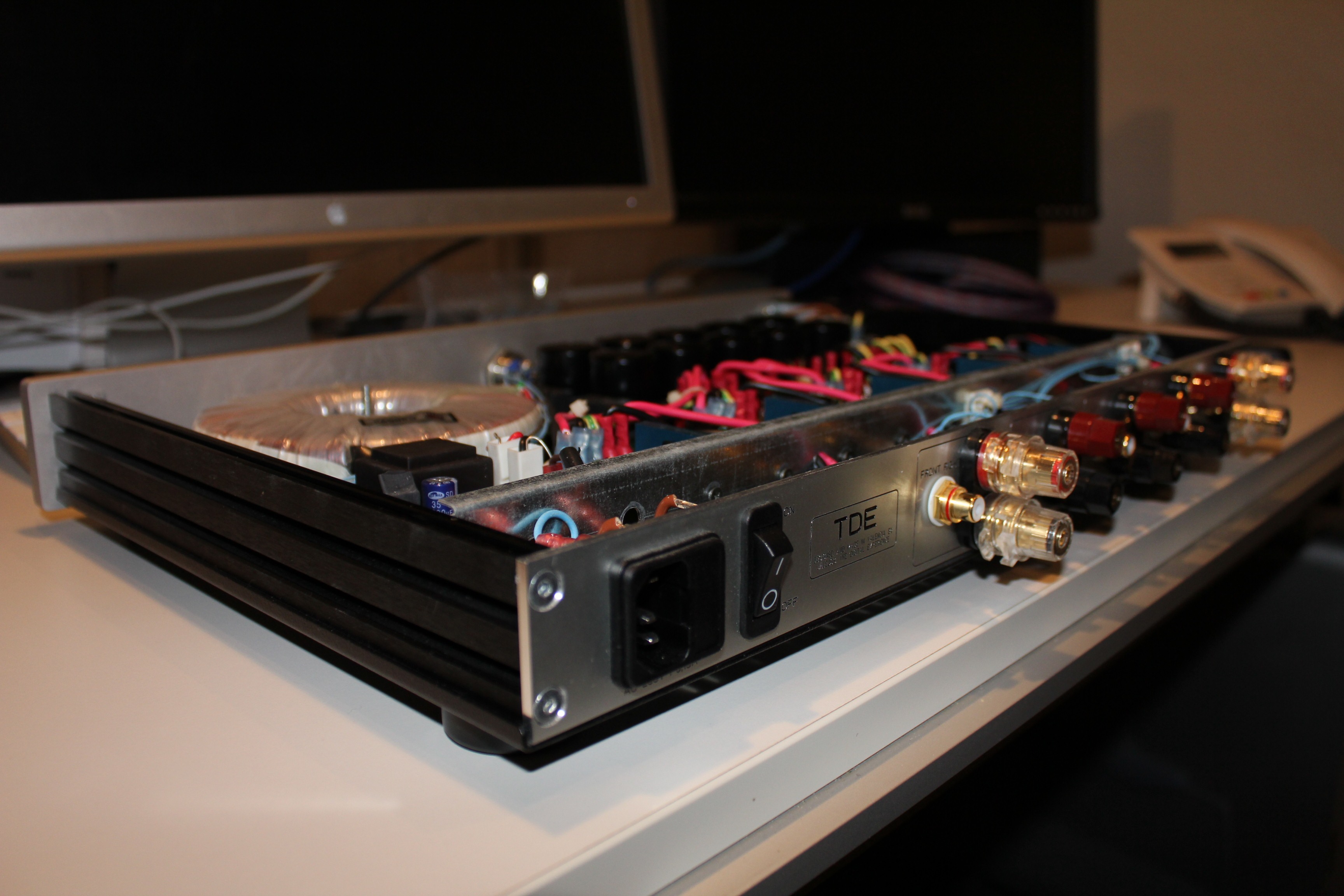

My Hypex 5x180W in 1U rack

Hi
I bought the same amp. I see you changed the input caps with Sonicaps. That's the exact modification i want to do. Did you find any difference in the sound quality ? By the way , very nice box.
I replaced the stock input caps with Gen1 2uf Sonicaps bypassed by Gen2 .1uf. Also pulled the pot and wired the input directly to the caps. I am knocked out by the sound on my modded MMGs.

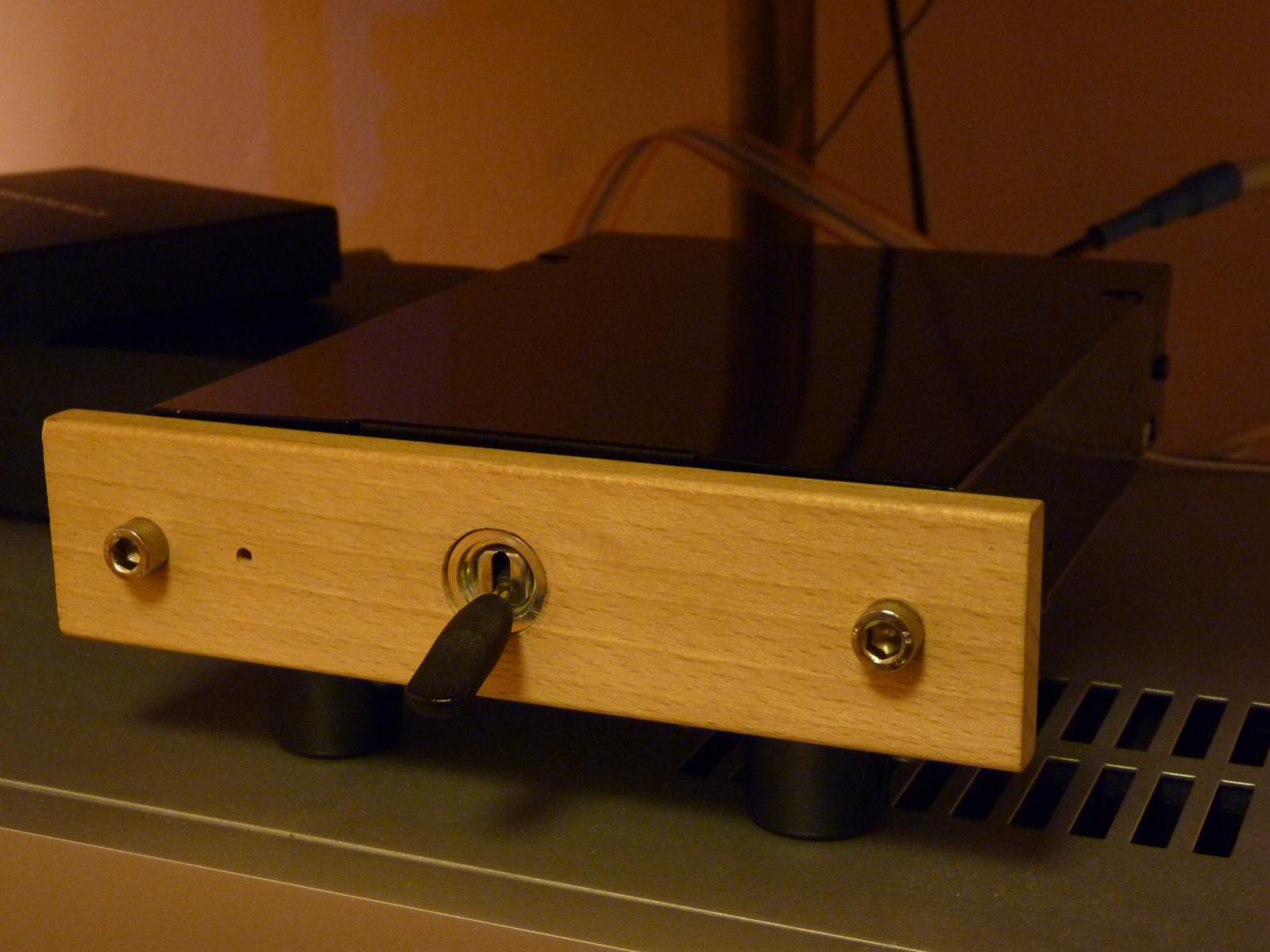

My HifiMeDiy T2 2x100 amp.
Finished my HifiMeDiy T2 2x100 amp.
The box is painted in black glossy color and it comes from a broken pc dvd driver.
Front panel is a nice piece of wood that comes from my sons toys.
Sound is perfect with no mods & it is driven by a tube-class "A" pre-amp using 2x ECC88CC Siemens tubes from the 70's.
Vassilis

The power supply is the Exodus MCH from diycable.com
DIYCable.com : Intro » Home » Exodus/Hypex Amps » Amp Parts »
The transformer was handmade in a workshop in my city. Flat but wide.
The transfomer has a Noratel passed sticker on the top so I suspect it is from Noratel - made in Sri lanka or India , but offices all over europe - Distelec have quite a few in stock
Noratel - transformer, reactor and power supply
But I can not find this one there web site - but may that distrelec sell ae not on the noratel web site

Nice use of recycled parts and nice outcome! I recognize those rubber feet, use them on my amps all the time.
