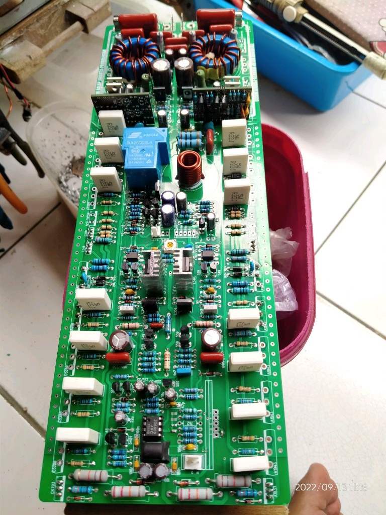

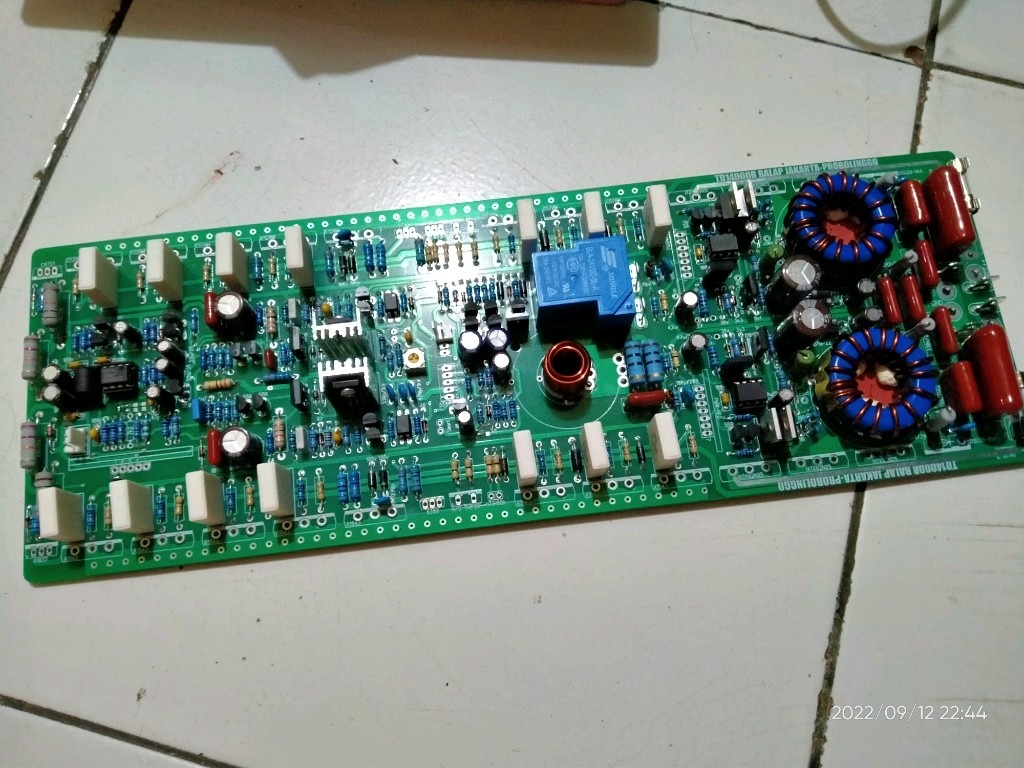

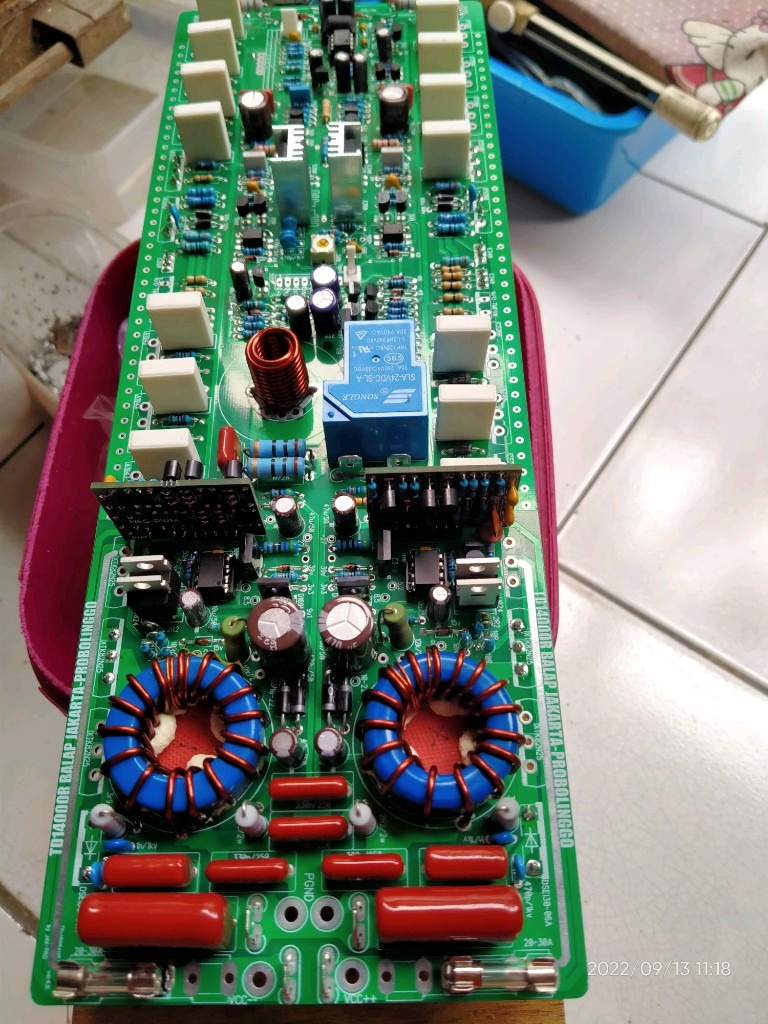

Here my attempt to build it

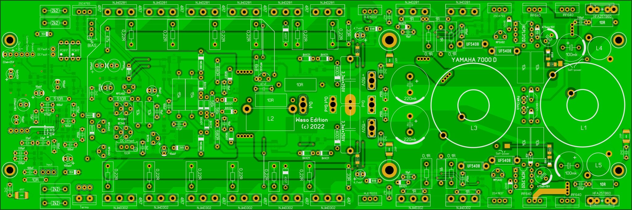

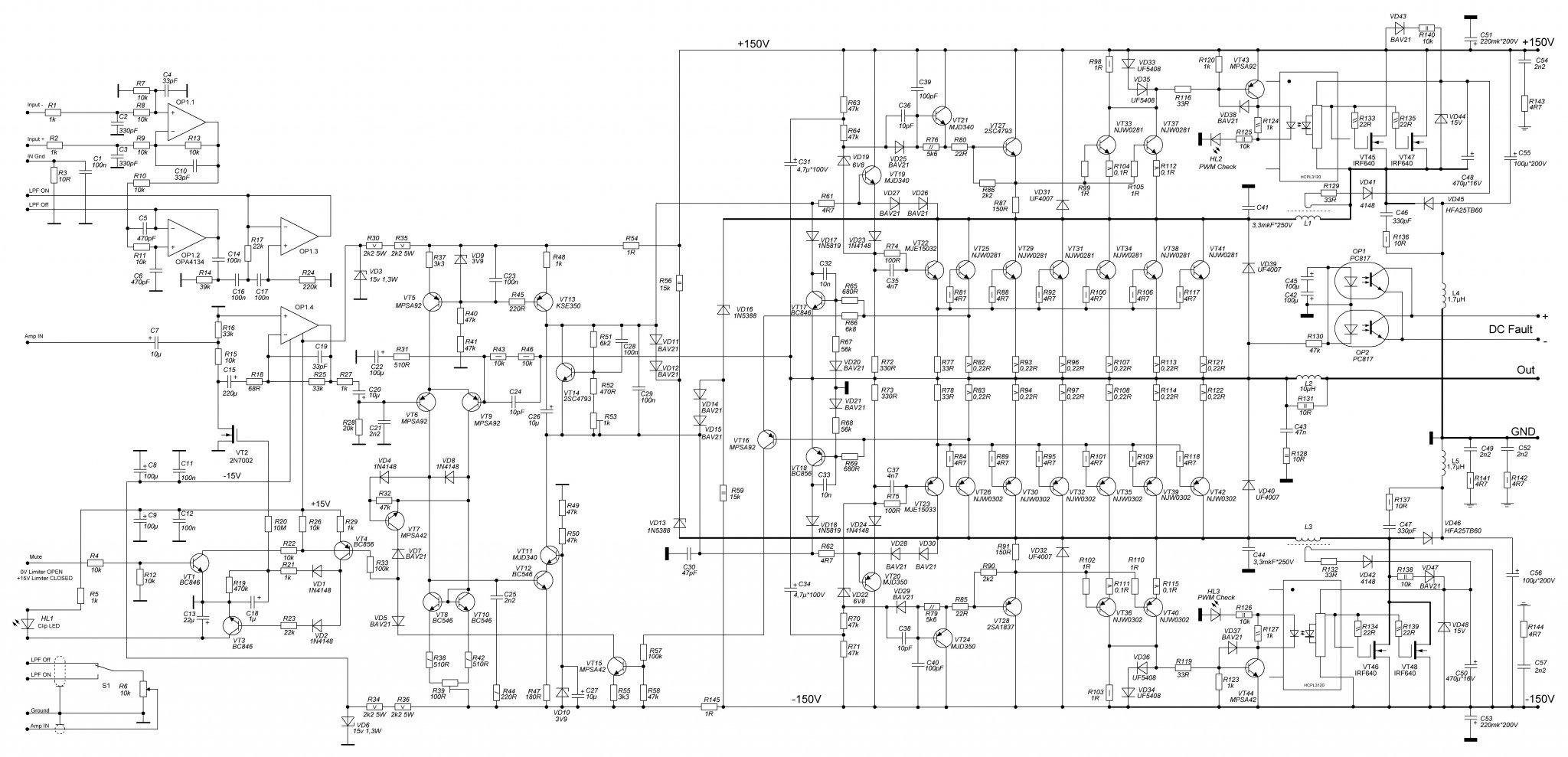

Yamaha 7000D version 2022. The PWM tracker has been redesigned, self-power has been added as similar as Lab Gruppen, efficiency and reliability have been improved. SPL7 & Lay6 PCB file - see the attach.
  • yama_7000.zip

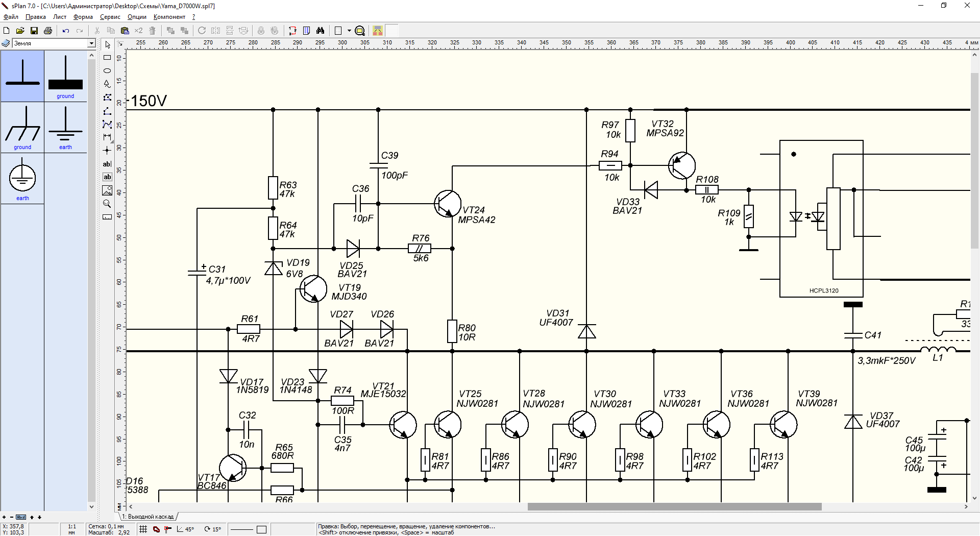

I will show you the current version of the printed circuit board, and I would also like to share the idea of increasing the efficiency of the tracker by eliminating "analog" tracking.
The points of comparison of potentials remain the same as in the original, only the power is modulated exclusively by the PWM tracker. Due to the Schmitt trigger in the optodriver, there is no transition of MOSfet keys to "analog" mode of operation.
  • Yama_D7000W.zip

Bună ziua, cred ca d3 nu este alimentat bine cu tensiune, d4 nu este alimentat deloc în schema.Schema este și fizică sau doar pe hârtie? Este foarte interesant și dacă funcționează este un pas mare spre clasa td.In .zip there is no wiring with changes.
