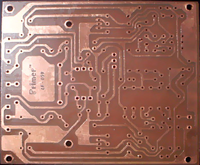

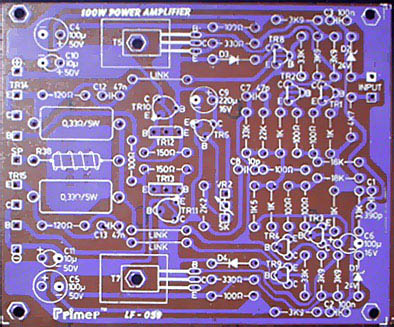

Mike;
.. thank's for your attention .. i've learned your paper you send to me .. and I already change the schematic .. but the PCB is ready before I post the schematic here, and i'm not apply the short-circuit protection network on the PCB as your advice ..
regards:
Ragil Hastomo
regards:
Ragil Hastomo
