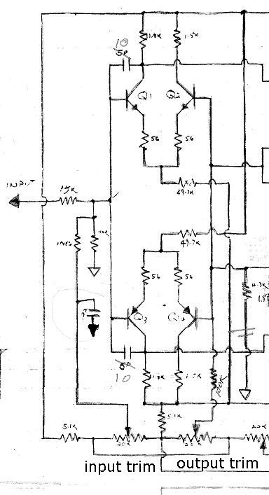

Found this board because of another thread. A little re-biasing of the front end (with gain set for no feedback) and increase of the number of diode (should be shottkey) in the output bias circuit and this would make a lovely small class A amp. This board has such a sound basic design I may buy a pair myself and build a small super wide band amp!
This will likely need a servo to control DC offset or at least a trim pot. Attached is a schematic showing how to the two pots to trim the input and output offsets.
Would probably regulate the front end (cut traces) to like 20-25 volts and run the output stage off your unregulated 34 volts
