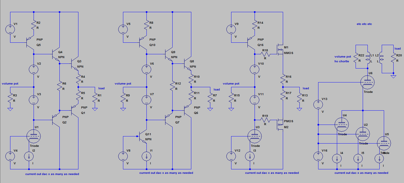

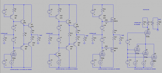

yes that circuit looks simpler, but it does not drive the speaker which is what I am doing here, therefore, over all, no, probably not simpler.

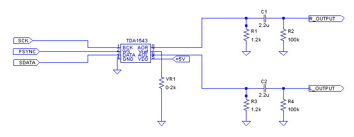

Just so no confusion, here are some stripped down circuits of what I am aiming at, everything is fairly interchangeable device wise, just pick your flavour, the tube fet one would probably work as the “most minimal” if gate capacitance etc don't get in the way, all tube one will sort of work, got to love that volume control, with variable output damping as well.... mmm a bit more thought required there maybe, but it would work and I bet it would sound pretty good...

Hi WuYit,

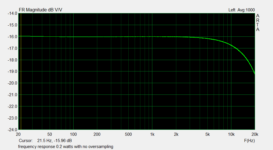

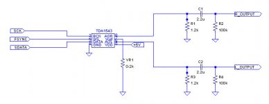

Grrr, I was wondering if anyone else had discovered the “2x oversampling” by inverting WS and of course they have..., I don't quite subscribe to GuidoB's friends (see below) observation of 16dB down at 20k, more like 7dB in my case, (2x nos 3.5dB). So unfair... never mind fortunately only three wires to rearrange.
I must say I had noticed it felt maybe a little rolled off, but did not measure frequency response recently, and have been just enjoying having it working, not really knowing what to expect.
A wise man once said “there is nothing new under the sun” the more I know, the more convinced he is right. One of the joys of having ones memory erased on entry to this adventure playground I suppose.theory:
non os : -0.8 dB at 10kHz, -3.5 dB at 20kHz.
shift -2.5 dB at 10kHz, -16 dB at 20kHz.
Somebody that knew what i was doing wrote me this (i didn't back then):
> Hi Guido,
> Your DAC would implement the equivalent of a 2-point moving > average filter, i.e. with impulse response h=[1 1]. You can read > more about those here: SAIC: Products: X-ray passenger vehicle inspection VACIS XPL
> This filter will have a lot of high frequency roll-off, -2.5dB at
> 10kHz, -16dB at 20kHz, so I am not sure what you mean
> with "high freq rollof of a true non-os dac is gone". On the
> other hand this filter has a very good time-domain response
> with no ringing, and it will reduce aliasing distortion quite
> significantly. I would think, although I have never heard one,
> that it makes a non-os DAC sound much more pleasant.

Had a brief diversion to the digital line level forum to sort out the -3.5 dB or -0.6 dB at 20kHz conceptual problem I had, the long and short of it is that my amp has an indicated 47% "THD+N" at 20kHz, and I embrace the "distortion".... This is one of the reasons I did this project, to break a few rules. Please see below distortion and amplitude measurements taken at 1 watt output recorded from my pc (ARTA m-audio) and Sound Technology 1700B distortion analyser.

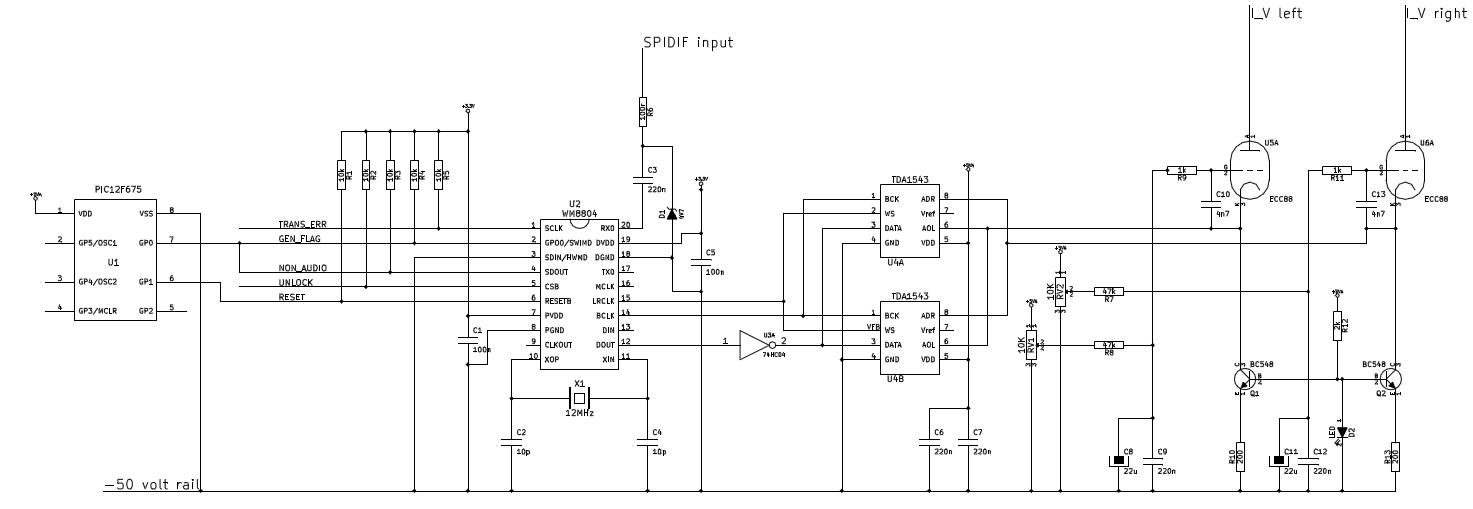

Hi Ontoaba, I must point out the above diagrams are for indication of general topology rather than working circuits, the obvious mistake is the tube's cathodes are not on the same rail as the -ve output rail, but need to be at least 40 volts lower. I don't understand why you think the mosfet circuit won't work. It is a very common output configuration. You are right none of them are particularly linear, but good enough for this project.

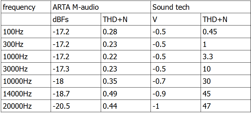

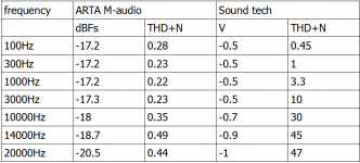

Very big differences. There is something wrong with your SoundTech 1700, probably another failure not repaired yet. Your amplifier is not type that distorted by slowness or lags.
7% distortion and up are easily noticed by ears, <5% is OK, that you may embracing with it.

Hi Ontoaba. Sound tech works fine, its "problem" is a distortion measurement bandwidth of >100kHz according to data sheet, unlike the m-audio which stops at 22kHz... My problem is what to call the distortion, because it is not really THD, may be just TD... It is a pity my site is not up, I think it is quite broken and not sure how to fix it short of moving it to a new host. yes i agree about the all tube circuit, it is a bit silly...
It is strange... hmm.. let me think... ARTA work with soundcard, if the soundcard has 20KHz maximum frequency, that it will still measuring H2 at 10kHz and H2,3,4 at 5kHz and up to H20 at 1kHz. I remember with shorted tantalum that been removed from SoundTech, did you replace it with another or just remove it? may be that cap is crucial.

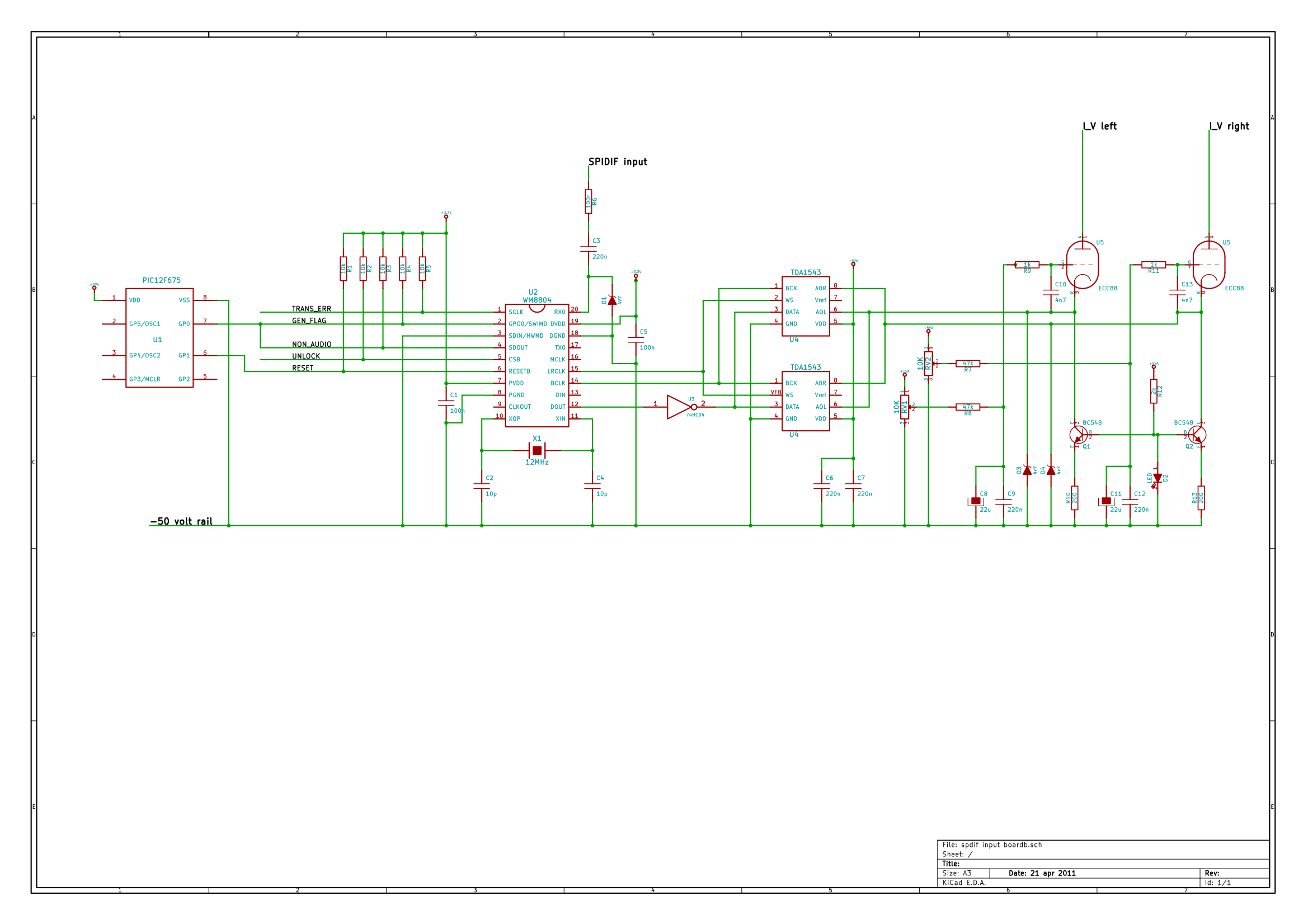

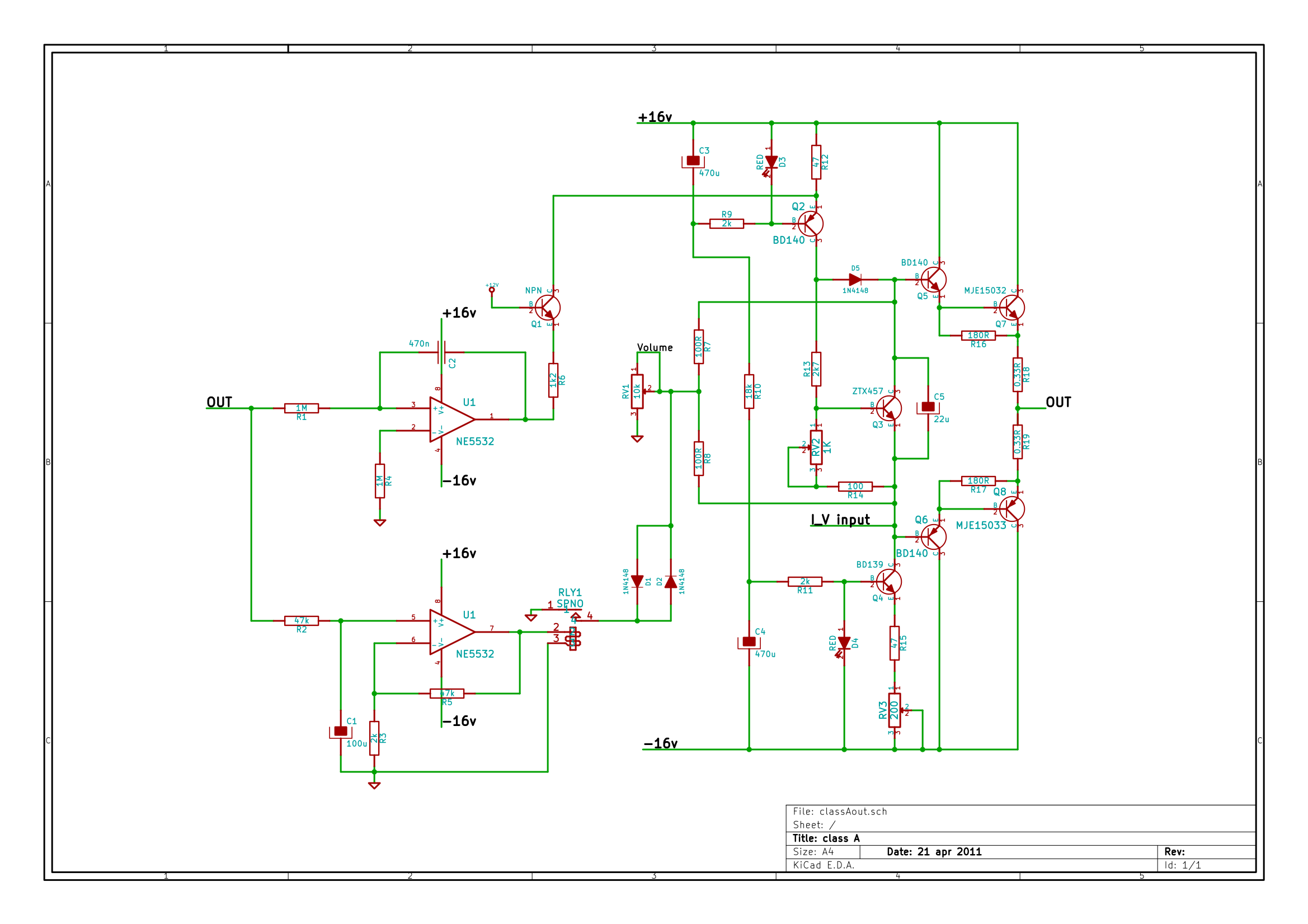

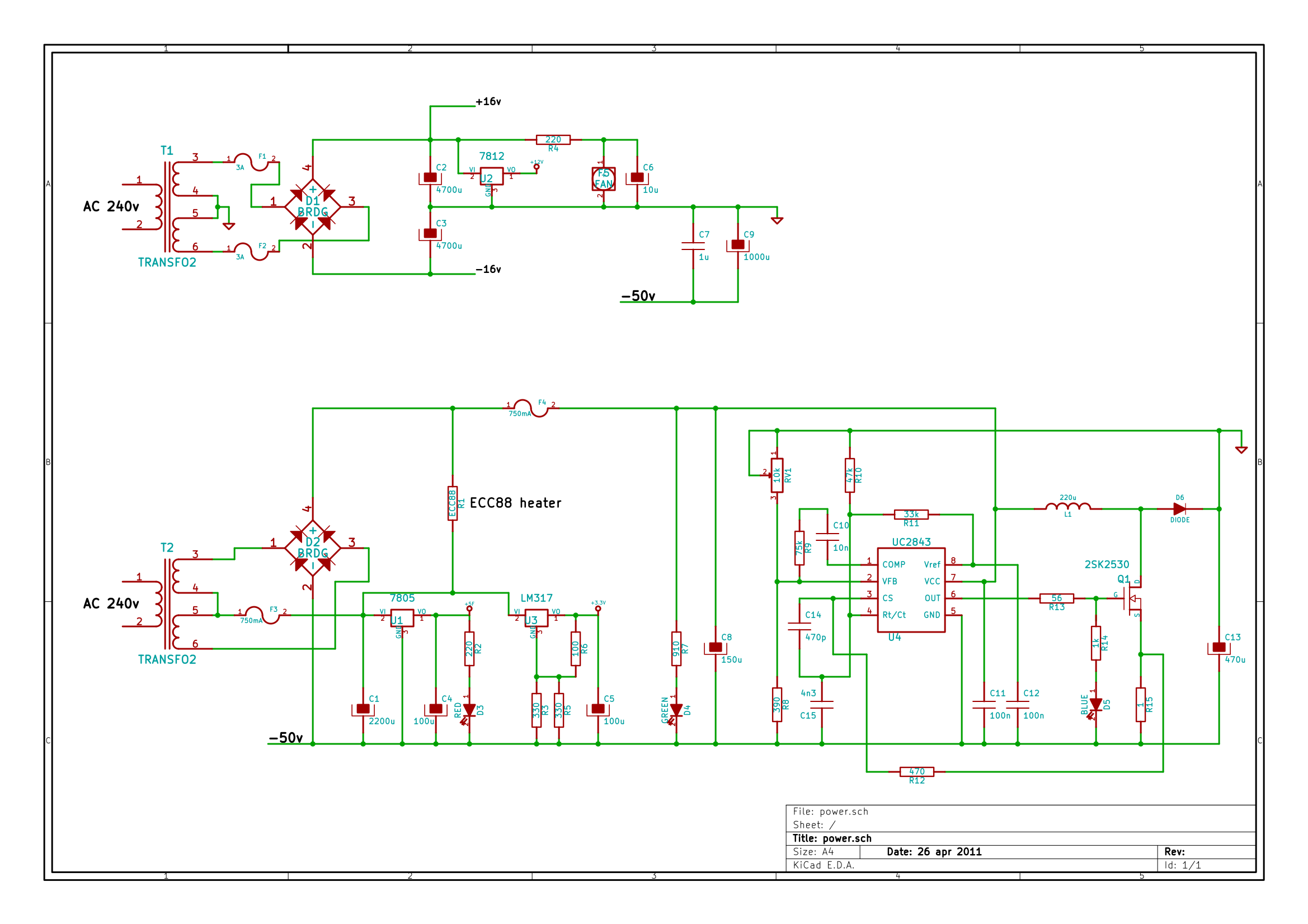

The amplifier is built and tested (and marked) and my life has slowed down sufficiently to post the full circuit.
I am very happy with the amplifier, and it has bought about a shift in my perspective so much that I am wondering how to “de transistor” my home stereos. I even toyed with the idea of acquiring a “vintage” valve receiver, those guys are a bit pricey now days! So I am thinking of building my own, or a “happy hybrid” which would be an analogue input version of the amplifier, possibly with modest feedback...
My original suspicion that a single device, be it valve, transistor or whatever, providing modest gain and with modest (or less distortion), should be fairly indistinguishable from each other in the same circuit, is gone, I now hear transistors every where (at least I think I do!).
Various caveats about the circuit, If you wish to use /copy the PSU put a resistor in series with the voltage setting pot RV1 to stop shorting the input power supply in to the controller chip when the pot is reduced.
