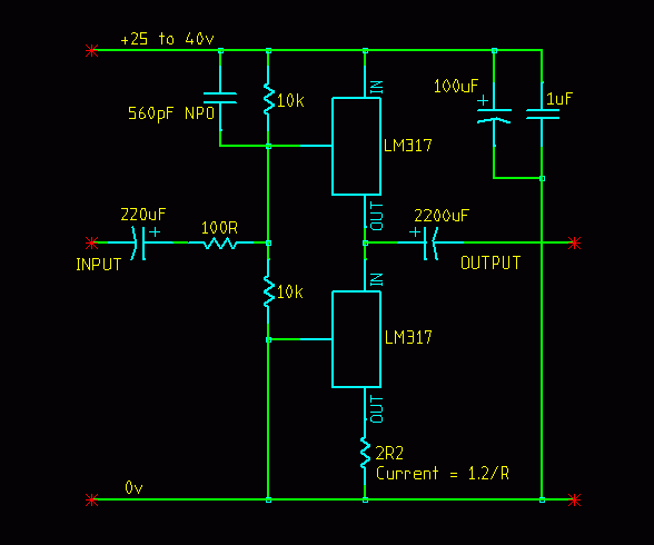

Hi anonymous
Interesting, do you have a drawing of the OPA + regulators circuit to share ?
Circlotron is undoubtedly the forefather of regulators chip amps.Here is a buffer made from LM317... I found it on my PC, from before I lost my mind, so I don't know where its from, maybe Sinjosae.

I found your thread after trying to find other examples of regulator based amps. Yours is undoubtedly superior to this basic circuit, but with 3x opamps and 3x regs, it took the novel simplicity away for me.
I'll post some pics after I put together my "monster" LT1083 version (if it even works). Need to find a suitable power supply though.
Here is the LM317 version I have been joyfully listening to for the past few hours (opa134 is under the resistors)....
This is a later version, and remember, this BOM applies to a complete stereo amplifier.I found your thread after trying to find other examples of regulator based amps. Yours is undoubtedly superior to this basic circuit, but with 3x opamps and 3x regs, it took the novel simplicity away for me.
http://www.diyaudio.com/forums/chip-amps/192934-se-class-regulator-chip-amp-madness.html
This one is also stereo, and uses 2 opamps and 3 regs, that is one and a half reg + one opamp per channel: less than your own version in fact.
And the interesting thing about this circuit is that although it remains truly class A and single-ended, it also has an improved efficiency.

I want to built a "power amp" version with LT1083. Wouldn't the shared current source limit my output power? Maybe 7.5A is enough to share for two channels since we can only go so high with the voltage anyway (plus that is some serious heat).
BTW, what do you think a max safe rail voltage would be? Would +/-18V be cutting it to close to the device limits?
EDIT: I see the LT1083 has an input to output limit of only 30V instead of 40V like the LM317. Bummer. Might have to go bridged.
