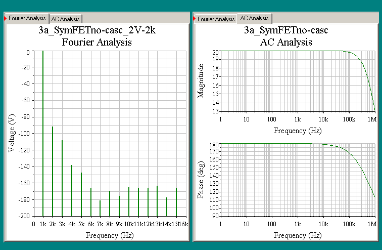

Something like this maybe.
My simulation work of the day.
Based on commonly avialable: 2 N-JFET + 2 P-JFET
in a stragth forward complementary symmetrical DCin -> DCout configuration.
One 'complementary' pair for input and the other pair for push-pull output stage.
Supported by current mirrors acorrding to John Curl ( emitter resistors! ).
Supply is +18 VDC and -18 VDC
The gain is +20dB ( x10 )
Output is 2 Vrms into 2 kOhm load.
I did only have to us one little capacitor for this circuit!
10 pF, as in AD797, to tame the output overloading.
Result is close to perfect phase behavior and a roll-off nicely at 500 kHz
The graphs of multi-sim testing is in my attachment.
lineup hifi regards, without much of the 7th degree torture

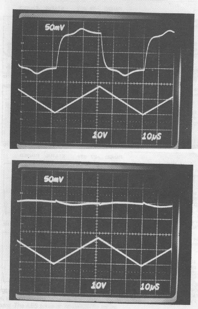

Here's the pix from my AES paper showing the operation of Cn (AD797). The tri-wave represents +-10mA of current being shoved into the output. The other plot is the input error signal (I forgot the exact scale). I like tri-wave excitation because main error signal is then a square wave (derivative) and the crossover jumps right out. The lower picture shows amount of removal of both errors.
john curl said:Little points of distortion concern me.
That's the tri-wave changing slope the derivative is discontinuous, no test is perfect. If you play with class A current injection you can move the crossover "hat" around and deduce the bias level and see if positive or negative current looks better.

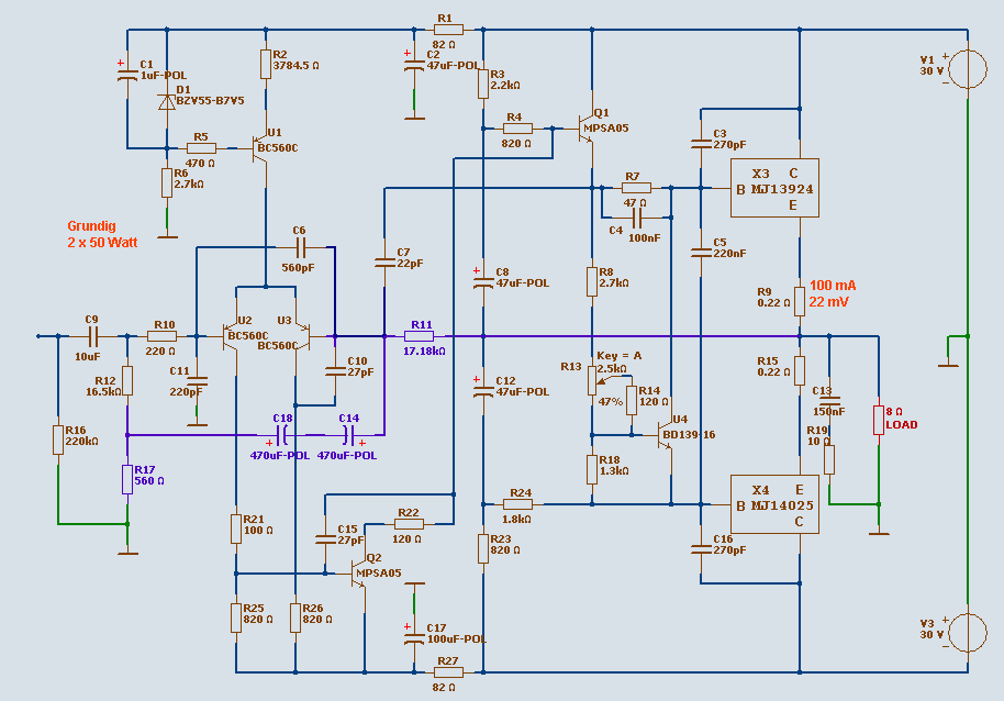

Yeah, of course. I am honored you askECBLN said:@ lineup
Hi, can you send me your multisim file ?
thx
Send me an Email and you get it. Click My Email button below this post.
By the way, I can send you my simulation of Grundig amplifier, too.
It is a Very Good amplifier! Good MultiSim test-results.
Lots of work done to compensate (many small pF caps).
See attachment, please. / Lineup
