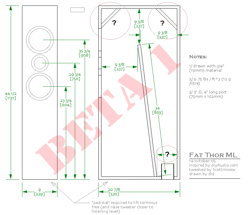

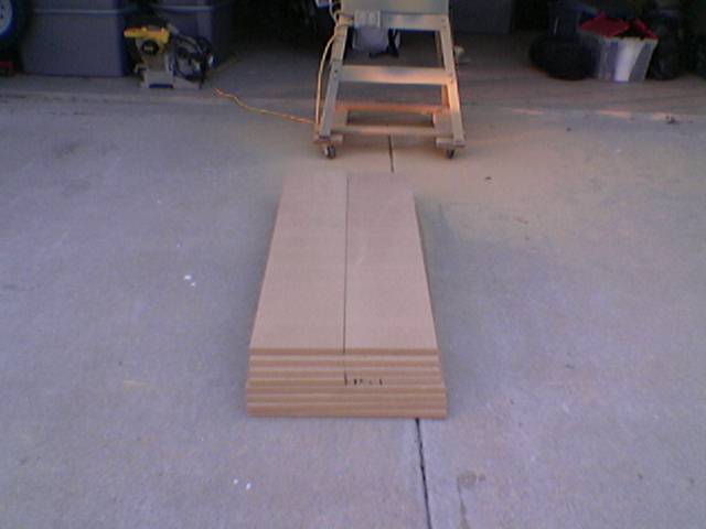

Today a friend and I began the project by cutting the wood.
While reviewing the drawings, a few questions arose. For reference see the three (3) circled areas of the attached image.
1. What are the measurements for the two "path bend/turn" pieces?
2. What is the distance from the bottom of the center divider to the front or rear of the cabinet?
3. Any thoughts about shelf braces?
a. Where should the bracing be placed?
b. What thickness should the brace be (3/4")?
b. Size and number of holes in the brace.
My friend seems to feel we need to add one, possibly two shelf braces per speaker (one in the front chamber, and maybe another in the rear). How will this affect the speaker, if at all? Any suggestions regarding bracing will be much appreciated.
Thanks in advance for any information provided.

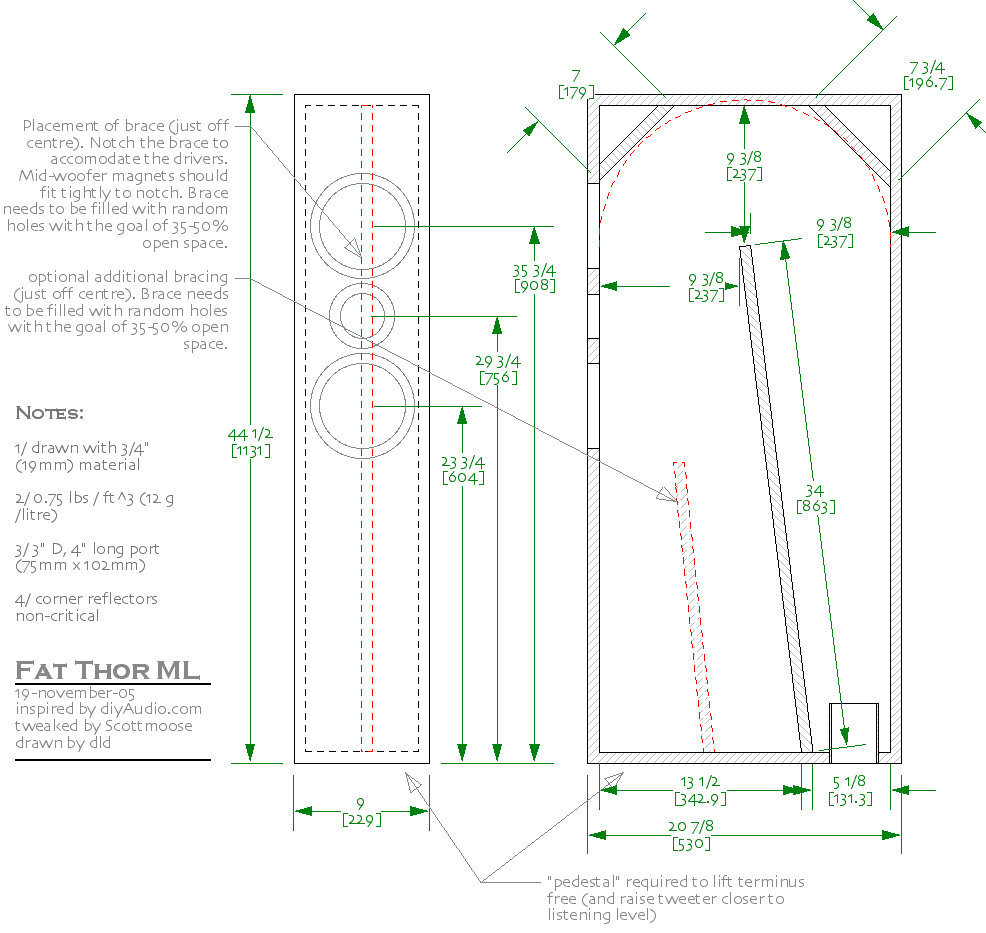

I have updated the drawing with some more dimensions & notes. I've also added braces where i would put them. They should be filled with random holes until there is close to as much hole as not-hole. The major brace doesn't need to be full length -- the bit bracing the drivers to the rest of the cabinet is the most important bit.
no shelf braces please
<rant> shelf braces are probably the least effective braces you can use on any speaker</rant>
dave

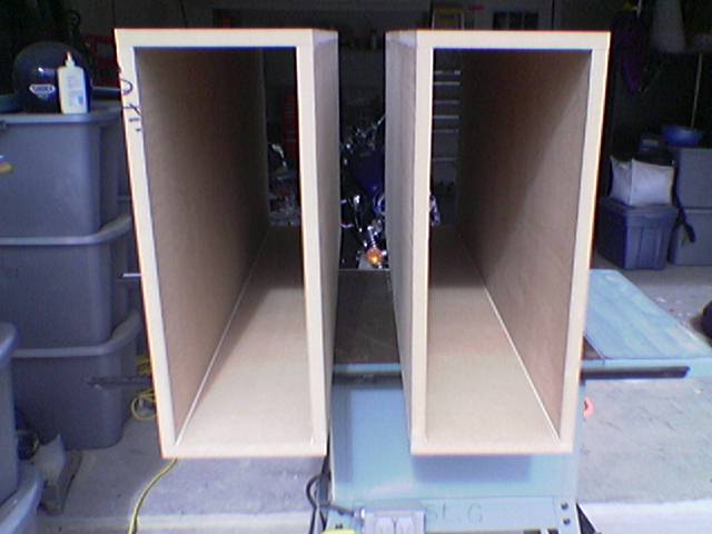

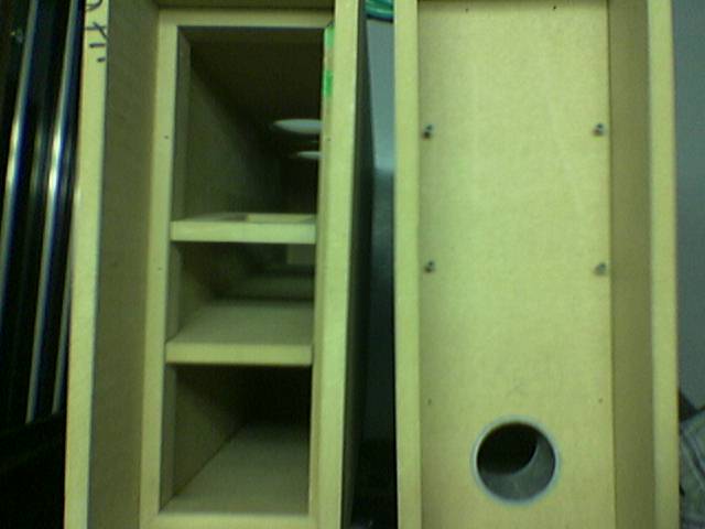

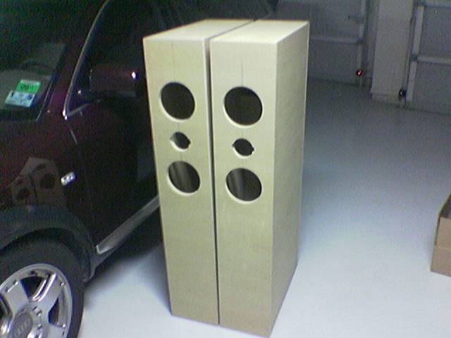

Hello All
My friend Troy and I got alot complete today (Thanks Troy!). The speakers are assembled for the most part.
Not sure if we have the tools/expertise to make a central brace. How critial is the central brace? If it's very important, is there an easier alternative we can use?
We did add the "optional" brace Dave listed in his updated drawings.
In addition, we decided to make the bottom removable, to ease adding/adjusting stuffing the speaker (particularly the rear).

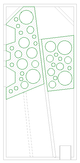

The important thing is to brace the drivers (mounted on the weakest part of the box) to the middle partition, and the back of the box. The easy way -- what i'd do if i built them -- would be to do 2 braces (the sketch attached will give you an idea & shows what i'd consider a minimum).
dave
So 3/4" wood 9 inches wide glued and air nailed to the edge of a 20 inch deep 3/4" panel is going to flex?
The 20" panel has more chance of flexing than the 9" strip.
:confused:
I don't pretend to be an expert, but has anyone built / measured the flex of these enclosures? I seriously doubt the front or rear panel are going to move anywhere as much as the sides.
