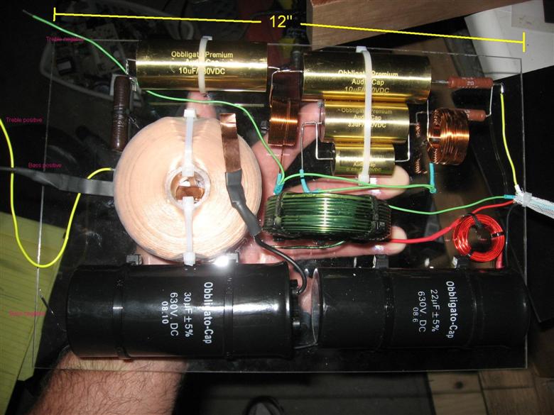

On a thread related note, I started building my new X-overs for my small Thors. About Damn time! Things move slowly for some of us.....
Pictures when I'm done.

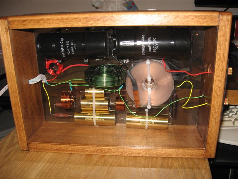

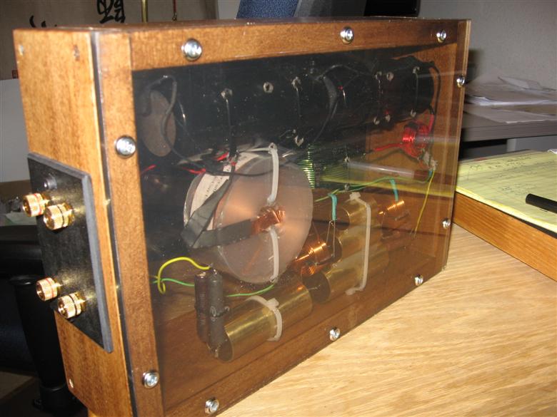

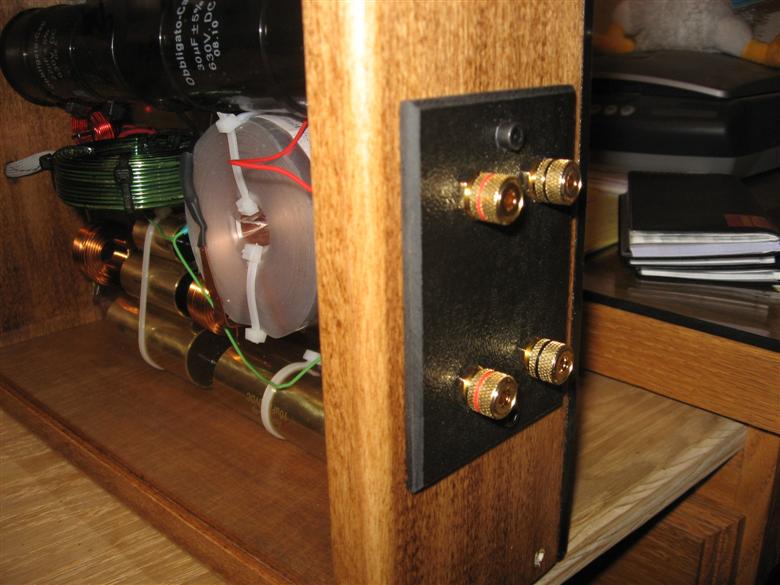

Finished one of two boxes today.
It's very hard to see, but there is a clear Lexan cover on the box above the crossover components. To keep little fingers out.
I was hoping that UPS would deliver the silver coated copper 20ga wire today so I could rewire the drivers inside my speakers, maybe on Monday. I can't wait to give them a listen. The crossovers are bi-wired with seperate grounds because my AQ speaker cable is designed that way.
Ron

last one
Back side, or bottom however they end up fitting best.
Still in shock how big those Obbligato caps are....
They were all burn in for 1 week prior to installation.
Please no flames, if you don't agree caps burn in then fine, leave me to enjoy my delusions while I talk to Harvey the rabbit......
Ron

Looking at your new crossovers makes me glad I've chosen to go full active! Those things are huge
and the caps are rated to 630vDC? Holy cow! How many amps have greater than 100v rails? even with back-emf and solar wind it would be unlikely to come close to 50% of that voltage rating. They do look nice though... Did you get a listen yet?

Yeah, Agreed. I thought about going active and came pretty close to going that route, but was shut down by the dreaded WAF! She has enough troubles deciphering the compendium of stereo / video components we have now. ......and I just added an OPPO BD-83 that needs it's own remote.
After voicing the new crossovers the speakers are in an entirely different class. Very rich and full sound while being able to pick out each instrument on the sound stage. Depth, width. height and tonality (timber) were increased. I had Clarity SA caps with Goertz coils in the original crossover and it sounded extremely detailed and somewhat glairy on the high end.
With the new XO the detail is lessened by the richness of the midbass, my wife, who has better ears than I, says the sound is like a soft warm rain. I think it has a warm tube aire kinda presence. No subwoofer needed for stereo listening.
How do you describe sound..........?
The interior of the XO box is 8x12 it's a big box but will hide behind / inside the next entertainment center, it does not bother me, it's pretty cool looking I think. Tony Gee gave the Obbligato caps a 10 rating and has nice things to say about their "sound". I'm very happy with the Obbligatos especially considering their price point compared to a Mundorf Supreme Silver/oil which were rated about the same.
