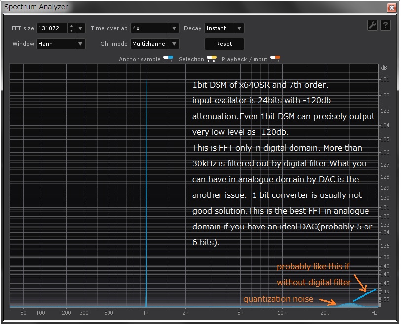

One example of the difference between PCM and DSM is the concept of bit resolution.PCM has its own resolution like 16 or 24.DSM doesn't have inherent one like PCM.It probably depends on the input signal and OSR as long as I know.Because I can design DSM with infinite resolution theoretically, especially in the digital domain.DSM output will normally converge to the input signal.This is irrelevant to bit resolution of DSM.
24bits PCM can handle from 8388608 to -8388608.But it can't do 8388607.5.PCM has its inherent limitation.
If you are in DSM domain, you can easily output 8388607.5 by repetition of 8388608 and 8388607.It actually equal to 8388607.5.In 23bits resolution, you have 8388608 and 8388606. 8388607.5 is three 8388608 and one 8388606.
The important thing is DSM will not discard quantization error like PCM.The quantization error is accumulated and to be used for next data calculation.That's why DSM is the convergent system.I think this is the principle of DSM.
I'm now under consideration to design "discrete DSM DAC" not "discrete multi bit DAC".It means to make DSM DAC like pcm1792 by discrete parts, multi-bit DAC and FPGA for modulation. It has almost finished both digital and analog domain.Here's some data about DSM.
1 bit DSM is used by SACD(DSD).SACD was developed at late 90's.The modulator of SACD is a little bit out of date compared with the latest one which is described in the book above.Quantization noise of SACD is less by almost 10dB(fig1 and fig2).fig 3 is 5bits DSM.Quantization noise is very low.I guess pcm1792 is almost like this.

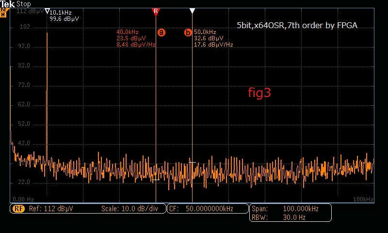

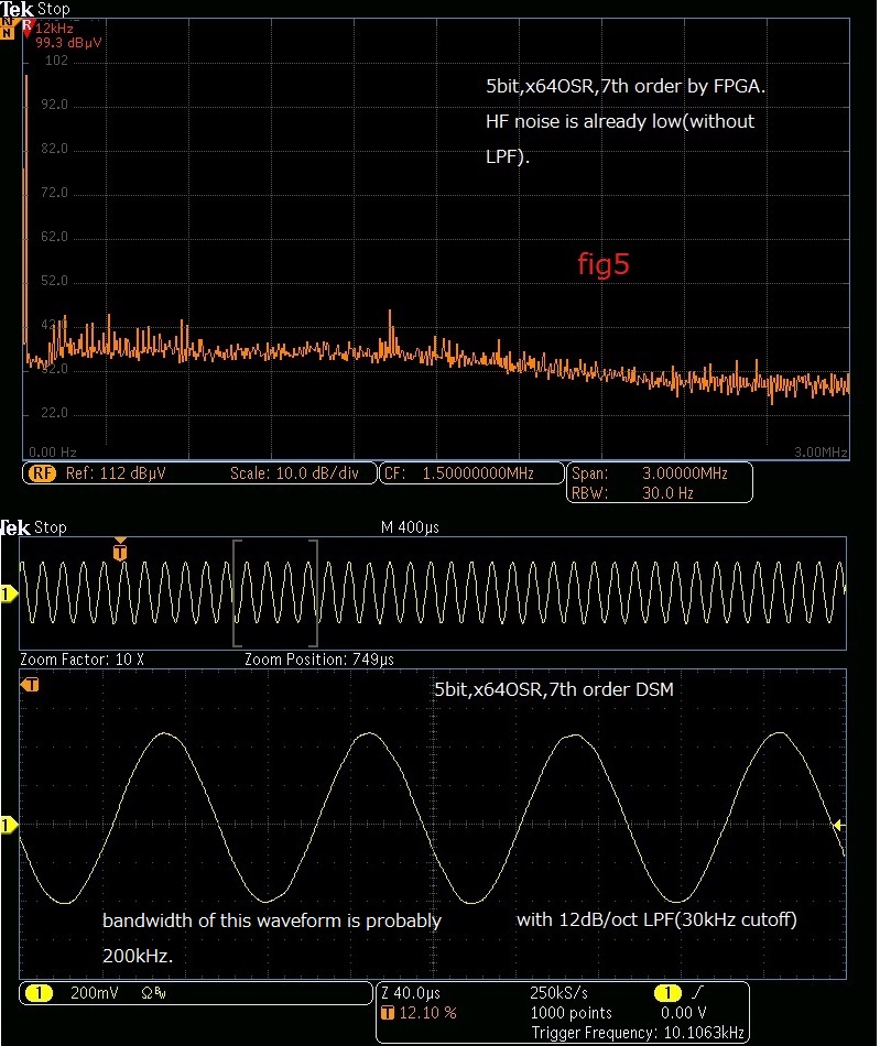

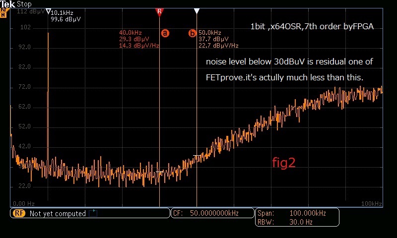

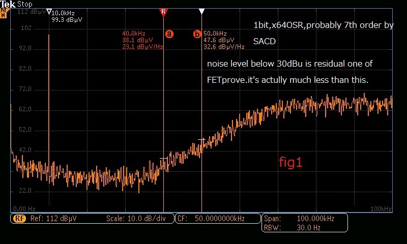

fig4 and fig 5 are quantization noise of 1bit and 5bits.If you use 5bits, simple 12db/oct filter is adequate enough to remove HF noise.
SNR and THD are another issues.I don't have fixed 4 layer PCB yet.I have no choice now except a bread board to measure.But I'm sure a good solution for SNR is high-speed DAC(more than 200M/s) and external calibration for THD.Both methods and 4 layer PCB can overcome pcm1792 or more IMHO.
