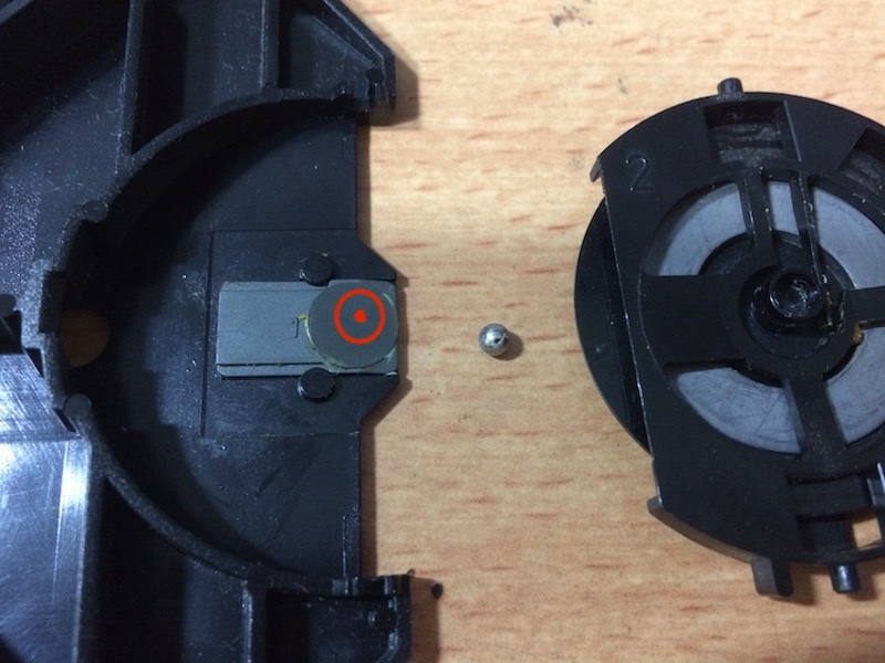

The main issue by the clamper unit of this loader is a difficult to describe knocking/tickling noise (mechanical noise, to hear from the rotating disc and not from the speakers) in combination with an unwanted suspending playback until stopp mode occurs.
Some years ago I order the appropriate new parts from Philips (Clamperplate 4822 466 12037 and Clamper 4822 466 12038 so as the plastic chassis No 46 and 41) and the issue was solved.
Currently I look for a used CDR765 to get this parts, because for the playback loader device (not for the burner device) the same parts are in use - unfortunately the only possibility at the moment.
But the actually reason for the knocking/tickling noise I haven't find out until this day, because this is temporarily and not permanent audible, also independend of the thickness from the compact disc itself.
Actually only the following errors must be exist:
1) White plastic clamper roughened or bad lubrication, thus increased friction resistance on top to the clamper plate
2) Plate and clamper a bit warped/deformed
3) Plastic chassis devices from the loader a bit warped/deformed
Who knows (resp. how I can find out) the exactly reason for this?
Maybe one of the members have a associated advice from Philips (Service Bulletin-Repair Tips).
Thank you for your advices.

Yes, i know but does it have one as well? Most of the time there will be a hole (created by the ball over time) and because of the spinning the hole is no longer centered and then the ball sometimes jumps in and out of this created hole causing noise and scipping of the disc.
